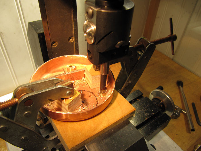

This morning I made up the through bushings for the boiler, to mount the sight glass on the backhead and the pipes on the steam dome. They are simple stepped bronze bushings, threaded through for the fittings. Then started boring the holes in the endcaps for the bushings and flue tube. With the rear cap clamped to a piece of wood in the mill vise, first drilled
then bored to size, close slip fit for the bushing to leave space for the silver solder to flow through.
This was first use of a new boring head I picked up from RDG tools, so far I like it a lot. The Sherline version had a setscrew wheel that sets the diameter, just like normal, but in there case it just butts against the end of the slider, so it is very easy to have the slider move when tightening the slider lock. Also, the wheel would tend to unscrew itself while boring, so you constantly have to run it back in before unlocking it. This one has a wheel that moves the slider both ways, which gets rid of that. It is calibrated in metric, but that is no problem, I use both units of measure all the time.
After the two sight glass bushings were fit, moved over to the larger holes for the firetube. The tube is due here in a couple hours, so I am stopping short of dimension so I can take it out to actual measured size of the tube, dont want to depend on the spec.

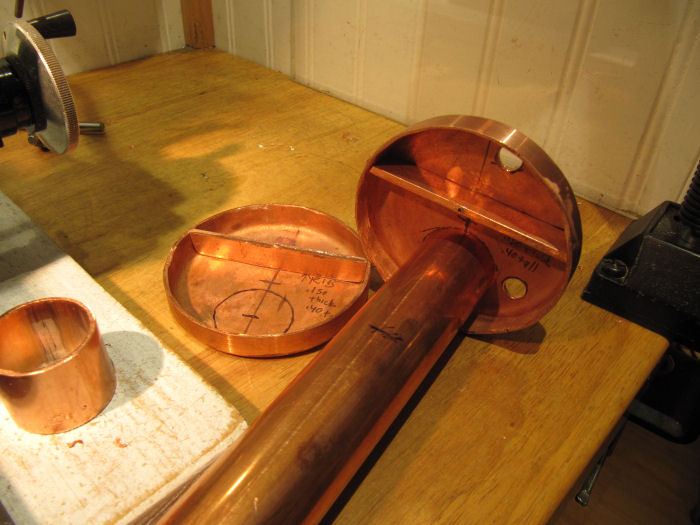

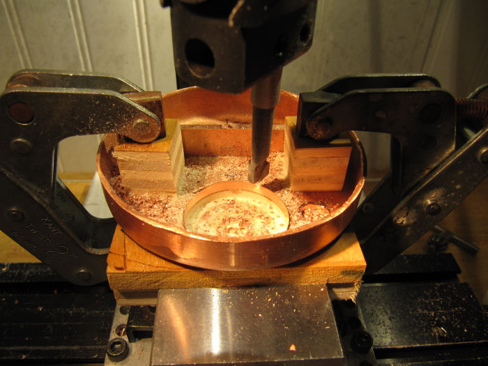

The firetube arrived this afternoon    :cartwheel:   so I was able to finish boring the hole for it in the rear end cap:
snuck up on the dimension, checking frequently with a chunk cut off the end of the tube (it was long enough to cut the main firetube, the steam dome, and leave this piece)
With a decent fit, removed the cap from the mill and test fit with the real firetube. One cap down, one to go!

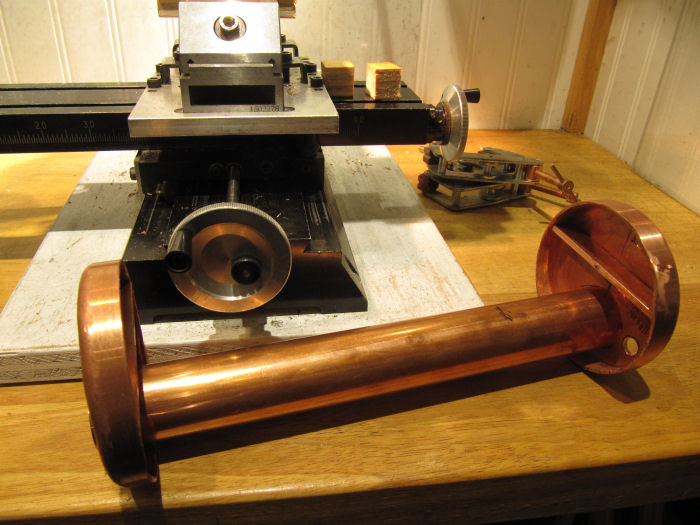

The second cap is bored for the fire tube:
Here are the endcaps and tube so far:
Next up - the steam dome
