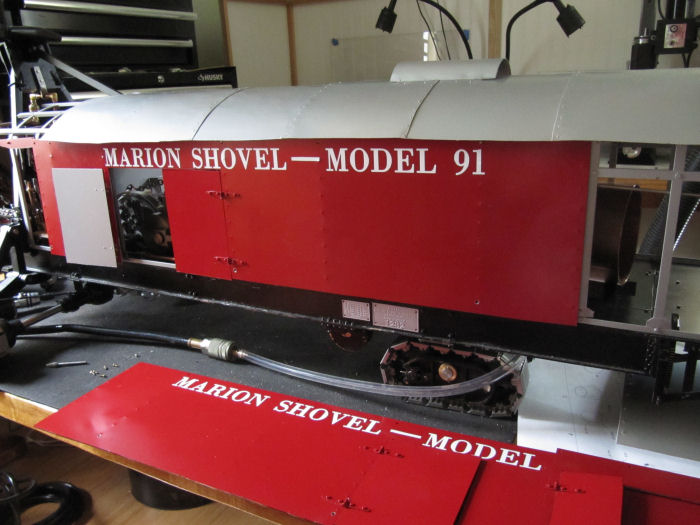

On a positive note, the vinyl lettering for the sides of the cab is out for delivery today!   :)

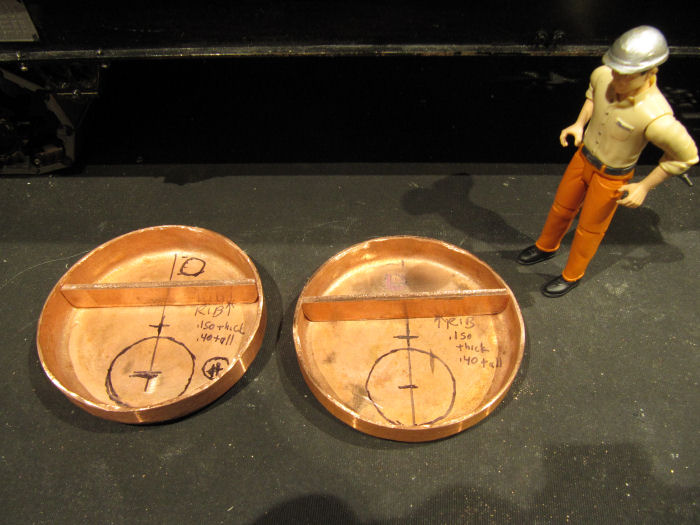

On the model, the rims of both end caps are turned to fit the boiler shell, am about to start fitting the internal ribs to the caps to prevent bowing of the flat surfaces - am using the tables in Kozo's book to place them.

The lettering arrived for the cab, VERY happy on how that came out. These are vinyl adhesive-back letters like you would use on glass doors and signs. They let you design the set online, picking font, size, color, etc. and they send it on transfer paper, so all you have to do is line it up on the surface, put a tape hinge on one edge, peal away the backing, and squeegee it down, and peel off the transfer paper. All that is left behind is the lettering, which is nice and thin so it can form to small surface features. I got it from www.customvinyllettering.net
Here is how it looks:
Its a close match to the original, not exact but as close as I could get. Not bad for $8. They did not have a 'dash' for the line between the words, so I added that with a strip of the vinyl tape I used for etching the plates.

Hello Chris,
OH WOW! The lettering looks great. :ThumbsUp: :ThumbsUp:

After sitting and admiring the lettering for a bit, got out the book and worked out the position/size of the cross ribs on the end caps. Turns out that it just needs one horizontal rib, which makes the job lots easier than a crossed pair. So, sawed out a blank of thick copper and used the belt sander and a file to fit them to the position:
Assuming the elf-spector approves, they will be silver soldered in place, but first I want to make the bushings for the sight glass/etc and drill those holes, then solder them all at once.
