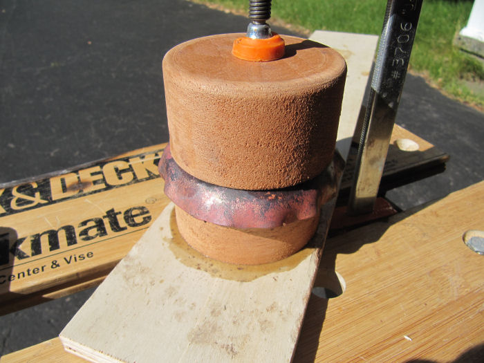

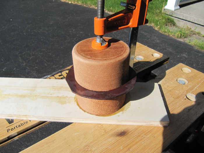

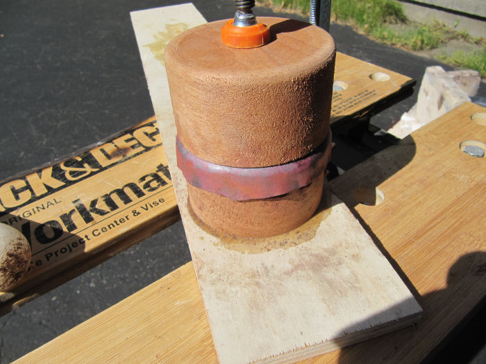

Excellent weather today, so I set up the torch and workbench outside and started bending the end caps to shape using the wood forms I made last time. Started out by annealing the blanks and sandwiching the copper blank between the forms and clamping them tight.
Then using the plastic head hammer, went around the edge to start the bend. Just a hit or two then move on, repeating the circle a couple of times (had to loosen and swing the clamp around to get all the way around the piece). If you take the edge down too much in one spot, it will wrinkle the metal, the goal is to push it down evenly, letting the metal flow - the edge will get thicker than the starting plate, and stretch down.
As you can see, it did not bend down all that far, maybe 20 degrees or so. When the hammer bounces off without moving the metal, it has work hardened and wont go any farther without cracking.

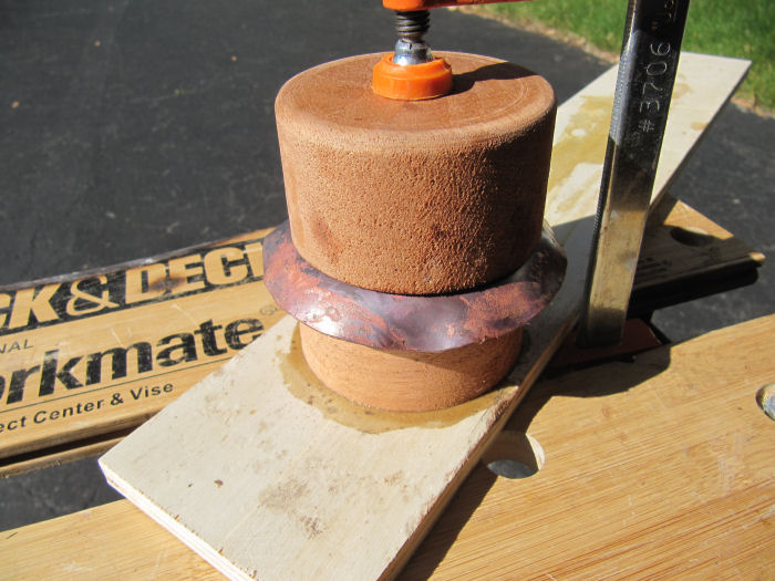

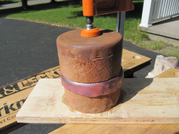

Then, annealed it by heating up to a dull glow and cooling - its okay to quench it in water to keep the process moving, otherwise it would take all day to let it air cool. Copper/brass are different than steel, they get soft when heated, but do not harden when quenched, the only way to harden copper/brass is to work it. Then back for another round with the hammer (BTW - I was doing both sheets, alternating between them, just showing the process on one)
Went farther down, back for annealing again...
Now that it is past the midpoint, it goes quicker, the metal doesn't have as far to move at the edge. Another reheat and hammering...
and again:

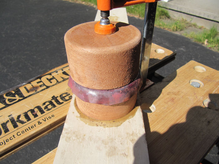

Getting close now, next couple rounds will even out the high spots on the waves...
Almost there, one more round...

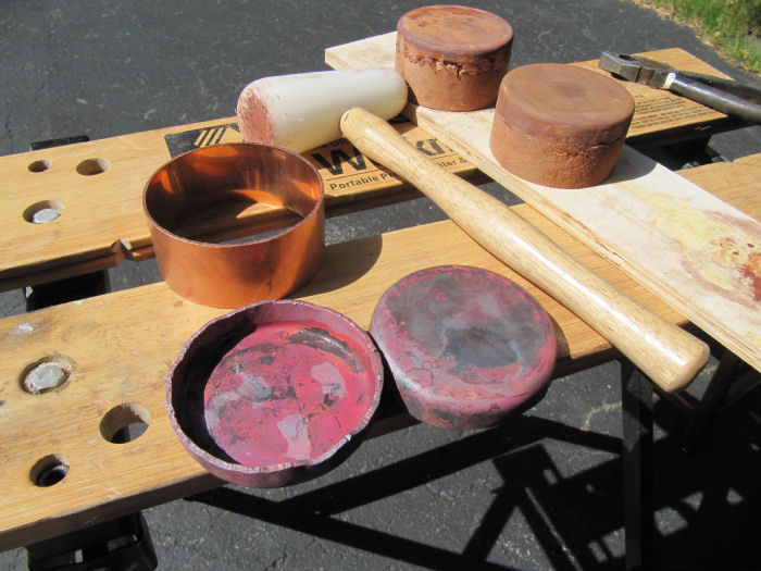

That got it down to shape. The part was tight around the form, had to pry it off since the edges grabbed a little into the grain.
Here are the two pieces all formed - took about an hour to do both.
The parts are soaking in some pickle acid to clean them up now. The next step will be to remount the form on the lathe faceplate, and use the tailstock to push the other block in tight to hold the plate, and turn the rim to final size. The blocks are sized to give a slightly oversize rim on the plate to leave room for turning it smooth and to final size - not practical (at least at a hobbyist skill level) to take the part to final size and round by hammering.

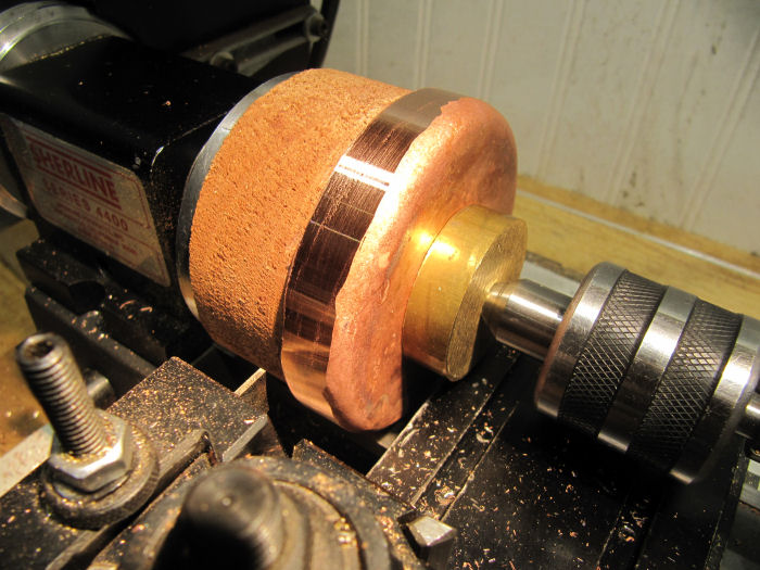

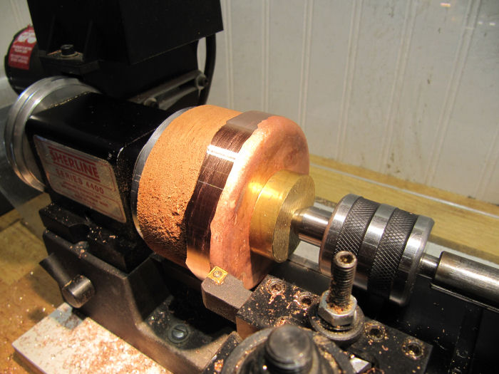

This part always makes me nervous and take the cuts gently - copper likes to grab if too deep a cut is taken. I mounted the form block on the faceplate again, and pressed the first endcap against it with a scrap piece that already had a hole in it, instant heavy washer for the live center to press against without making a hole in the copper. Then turned the rim down to size to fit the inside of the boiler shell:
You can see the wavy edge at the end of the cap on the left, that is the last of the wavy pattern the metal made as it was hammered to shape and stretched/moved down. To get rid of that, a pass, very carefully and slow feed in, with the parting tool...

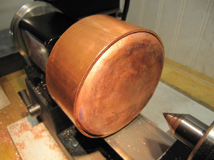

And the real test - fitting the offcut from the boiler tube (deburred around the edge) to see how it fits, and if the measurements were accurate. Good snug sliding fit, just enough for the silver solder to wick into. If I had gone too far by a little, the copper rim could have been spread slightly, but it looks good.
One cap turned down, one to go...
