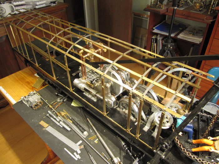

This afternoon I marked out the locations of the cross beams on the lengthwise beams for the ceiling, and milled the notches in - fortunately I had a mill that matched the width of the beams so just one pass per notch. The beams were all done at once to make sure they matched - had a clamp across the set so that I could move them together and keep the alignment.
And drilled the holes for the screws in each notch...
Here they are screwed in place on the hoops, looking like a cab!
Next will make the door headers and then the front and back walls will be framed in. The back wall is just a few cross bars, the front is just behind the operator and has a doorway on the left side and a tool bin on the right side.

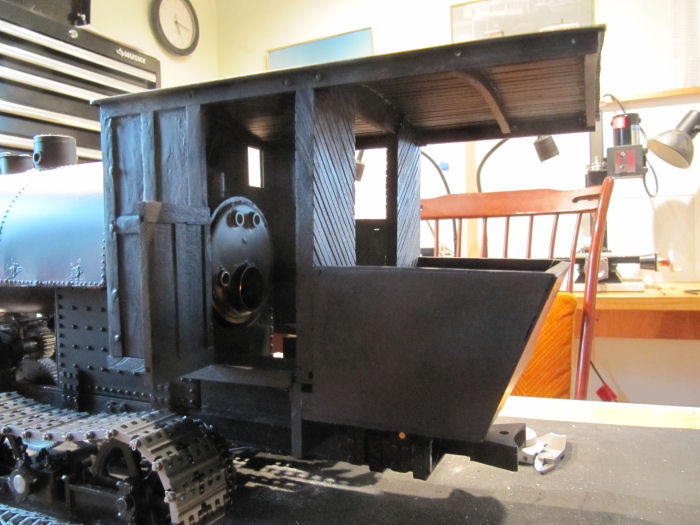

Hi Derek,
I have done that on ship models to show the framing and interior, but on this one I think I would prefer to be able to have it clad fully at times, but with the magnets and pins will be able to remove large sections to show the interior, especially towards the viewer with the far side in place. Even fully clad, there are large doors by the machinery space and smaller ones at the back that can be hinged open, sure that helped with heat control in the summer and air flow.

The cab was originally wood sided with a corrugated metal roof. I don't know if the frame was wood or metal when built. At some point the quarry replaced the cab with all metal plate siding and a smooth metal roof. Since I don't know the details of the original, I am making the model to match how it is now. The catalogs I have don't show enough detail either.

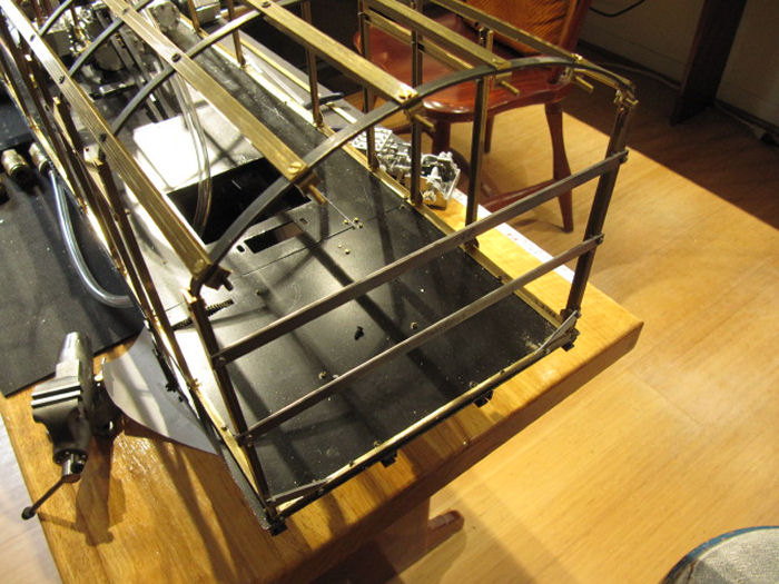

« Reply #3942 on: May 26, 2019, 12:16:47 AM »
More on the cab frameing - the door headers (half-lapped onto the verticals) and center cross beam are in...
Also the rear wall cros beams and diagonals, plus the angle brackets along the ceiling that will hold the top of the back wall. The area between the two cross beams is hinged at the top to allow them to raise up the flap to let them pour in coal onto the rear deck. The whole rear deck was added by the quarry, as manufactured the area was one large fold-out set of panels, which kept the machine shorter for rail travel. The quarry made a larger fixed deck at some point, letting them store more coal inside.
Last on today were the vertical frames for the front wall on either side of the gear train:
Should be ready to make the steering and hoist throttle linkages that hang from the front left ceiling beam and run back to their engines. Then can start making panels for the walls/doors....
