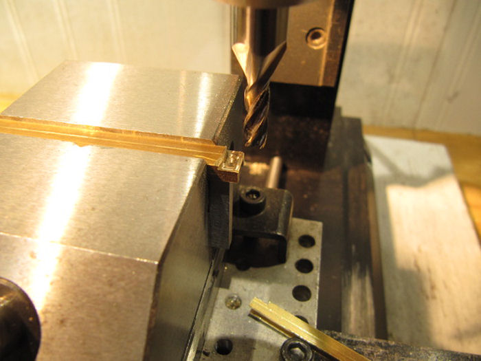

« Reply #3906 on: May 20, 2019, 06:14:32 PM »
Back in the shop again today, starting trimming the lower ends of the roof beams to fit into the tops of the wall frames...
Just a nibble of the sides and it fits into the C channel. One down, 10 more to go...

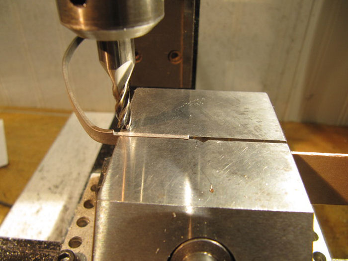

« Reply #3909 on: May 20, 2019, 08:13:38 PM »
Forgot to post the pic I turned on the PC for...  :facepalm:
More on the wall frames, notching in the bottom end to fit over the flange on the angle iron sill....
