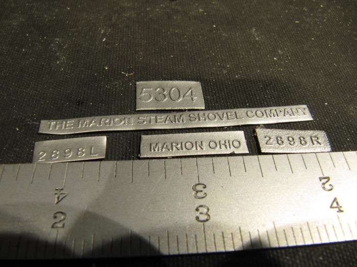

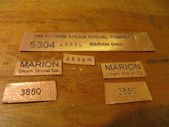

Continuing on with the name plates, here is a batch for the engines and boiler doors ready for trimming down:
Some paint....
and the plates on the crowd engine:
Very happy with how they worked out!
Some paint....
Hello Chris,
Boy those plates sure look good.
Have a great day,
  • Posts: 2793
« Reply #3889 on: May 17, 2019, 05:17:27 PM »
Another great result! They really look the business when mounted on the engine!  :ThumbsUp: :ThumbsUp: :ThumbsUp: :popcorn: :popcorn: :popcorn:
Speaking of business - when do you plan to open up "Crueby Nameplate Division of ACME Industries" and offer custom nameplate manufacture to the model engineers in US and Canada?  :naughty:

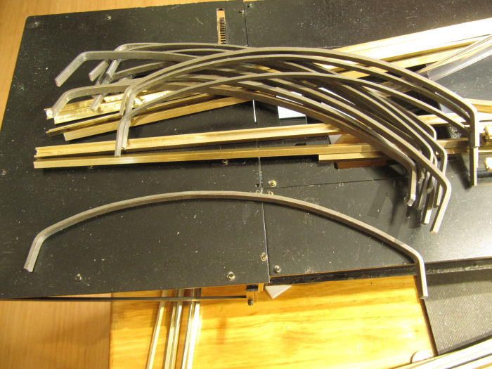

« Reply #3891 on: May 17, 2019, 08:15:37 PM »
Back on the cab frame, cut and bent up a pile of roof cross beams from thin steel bar. I cut a wood pattern to bend them to - bent the arcs by hand till they matched the pattern, then a pair of pliers to put the sharp bends in the ends where they go down to fit into the C-channel. The straight bits at the end need to have a little taken off the width to fit into the channels, that is next...
The lengthwise roof beams will be notched to fit over these arched cross beams.
