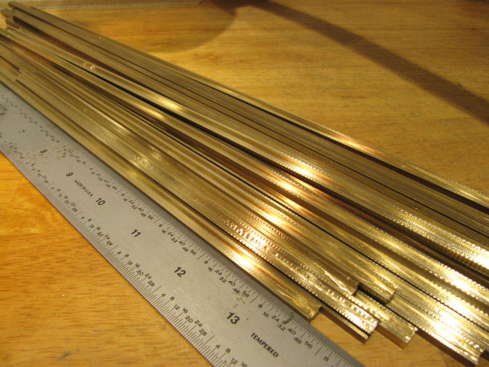

Got the c-shaped rails for the wall studs and ceiling frames cut down from rectangular stock (only off the shelf stuff I can find is either too thin or way too big). With a little guide block clamped in the vise to hold the stock in place for the slitting saw, it went pretty smoothly. The guide block holds it on three sides, and just wraps around the front face, leaving it able to slide through.
It took several passes to get the full width and depth of the cut - fed the stock in from the back right of the blade so that it was going against the teeth, like a table saw. Used a pair of pliers to grab the stock on the left and pull it through (was just a bit too warm to pull with fingers comfortably). Very neccessary to have one hand or the other holding at all times or the blade wanted to shoot it back out the right side again.
After several passes on all pieces, now have quite a pile of C-channel to start cutting down for the cab framework...

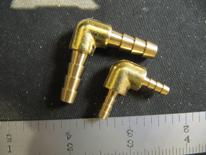

Last week I got a tip on these fittings, made for connecting tubing. They are already the basic shape that I was making for the steam pipes, just with the barbs sticking out:
So, I ordered some to see how they would work out. The center sections are identical in size/shape to the larger ones I made for the hoist engine pipework - could be cut/drilled for the pipe very quickly, saving a lot of steps. The only drawback is that the smaller sizes have the same size center section, was hoping they would scale the whole thing down. They cost around $1.50 to $180, and are manufactured by Dixon - they also have Tee's to match. If you search for 'Dixon Brass Fittings Barbed Hose Splicers' you will find them.

The only practical disadvantage I see with these forged body elbows and tees, is the physical mass of the body.......in model steam work, the mass can be a huge heat  :Mad: soak yes in both inlet and exhaust steam
Die formed capillary copper elbows and tees are available for either silver, or soft soldering....and in both long and short radius [for the elbows]
The mass is approximately 30% of the forged brass bodies of the corresponding size
The example sizing below is for 1/4" OD tube x 0.038" wall thickness....

Good points Derek! I have not seen the short radius ones here, will have to look for them.   :cheers:
