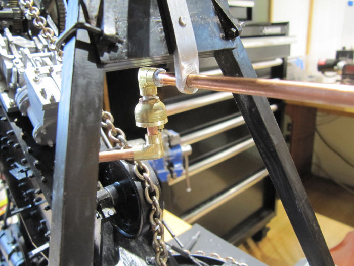

With the drawings sorted out, today I made up the swivel fitting to allow the steam pipe for the crowd engine to rotate with the turntable - this fitting will sit vertically on the turntable axis just below the A-frame head block. Here is a shot of the parts - the upper shell to the left, the o-ring sits inside the recess at its bottom end. The ring is a snug fit in the opening, and is also a sug fit on the lower pipe, which has a lip on it to keep it in place and also to keep the o-ring in place. Then there is a washer with holes for the mounting screws. This washer holds everything in place, but is a loose fit around the lower pipe so it can rotate freely.
The o-ring seals at both the inner and outer edges - this is the same kind of setup that the hoist clutch pipe has where it goes into the hoist drum axle, that is working fine so I am expecting this to as well.
Here it is all assembled, will fit into elbows top and bottom.
  • Posts: 2782
« Reply #3847 on: May 11, 2019, 01:18:49 AM »
Just picture Don Adams , Agent 86 on "Get Smart" saying "Ohhhh, the old diametral sealing o-ring trick, eh?"
Then Barbara Feldon , Agent 99, would say "Don't forget the silicone grease, Max!"
>ahem<  :mischief: :Lol:
Just kidding, the rotating joint looks great!   :ThumbsUp: :ThumbsUp: :ThumbsUp: :popcorn: :popcorn: :popcorn:

« Reply #3853 on: May 12, 2019, 07:58:15 PM »
Another bit made today - made the bracket that holds the pipe to the bottom of the A-frame head, with the swivel unit in line with the pivot axis of the turntable.
Few more elbows and short lengths of pipe to go to the side of the chain and down/back again to the inlet on the engine, which is right on the centerline of the boom. Makes for a few extra joints than if they had put the steam inlet out the side, but they did not so I did not...
