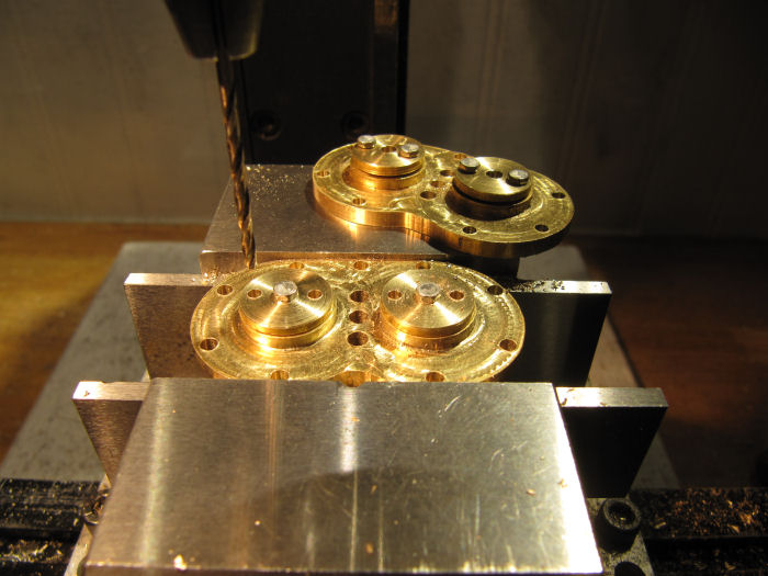

Not a lot of shop time today, had to go bail out CNR...
Did get the piston glands drilled/tapped and installed. Used a nut/bolt to hold them in place for drilling. The one at upper right has the screws and o-rings installed.

  • Posts: 7613
« Reply #3543 on: March 30, 2019, 09:11:02 PM »
I like the way you have attached the piston rod glands. I've always done it by one external thread on the gland and a matching internal thread on the endcap. I find that with the method I have used its very difficult to keep things aligned and not put a bind on the piston rod.---Brian
  • Posts: 18722
« Reply #3544 on: March 30, 2019, 09:37:14 PM »
I've done it this way a number of times, works nicely since the pressure on the ring is adjustable. The holes are a little larger than the piston rod so it does not rub on the metal. If it was visible at all on the finished engine (not, since the crosshead guide surrounds it) I would cut down the sides and taper the ends around the screws to make it look like a typical packing gland.

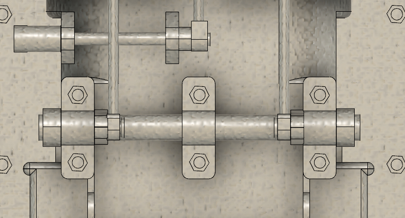

« Reply #3545 on: March 31, 2019, 12:26:42 AM »
Chris....something  :Argue:....is playing tricks in my mind......I see the split shaft with each 1/2 or longitudinal section on a common axis
So why is the axis of the body of the centre bearing that covers the split shaft further toward the engine top end than the outer two bearing housings?
Or, is it just an optical illusion?  :facepalm:
Derek   :shrug:

« Reply #3546 on: March 31, 2019, 12:33:15 AM »
Chris....something  :Argue: ....is playing tricks in my mind......I see the split shaft with each 1/2 or longitudinal section on a common axis
Derek   :shrug:
Its not - remember that I hid the top cap of the center bearing to show the split. I think you are comparing the top of the cap on each end with the top of the base in the center?

By coincidence, I was at the same stage of making a single gland of the similar design yesterday.  Of course, today you are way ahead of me, but can I please ask how did you clamp that gland in place while you drilled through the stud holes to the cylinder head?  Or did you coordinate the gland flange first, then just spot the cylinder heads?

Hi MJM,
The gland has a short cylinder that fits into the hole in the plate, so that locates the holes in the two parts into one axis. I put a nut and bolt through the holes to squeeze them together like a clamp, then drilled the two screw holes with the tap drill. The gland was then counterbored out to the clearance size while still clamped together - just went down by the thickness of the gland disc.
Does that make sense? In the photo from that post, you can see the top of the hex head screws through the hole in the glands - that is through the piston rod hole.

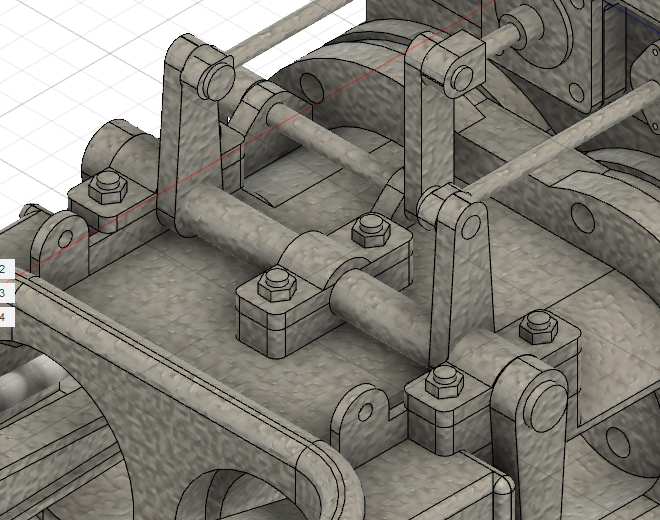

Hi Derek - looks like you updated your photo with the red/yellow lined box - that does not line up since you did not make the box long enough at the front. Here is another screen grab with the center bearing cap shown again:
And a top view to show they do line up:
No optical delusions needed. The ortho projections do make the eye do odd things though, since it is expecting perspective.

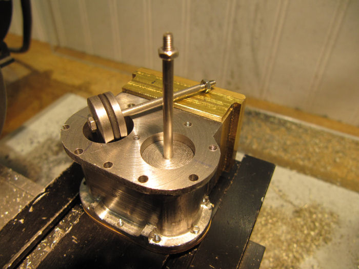

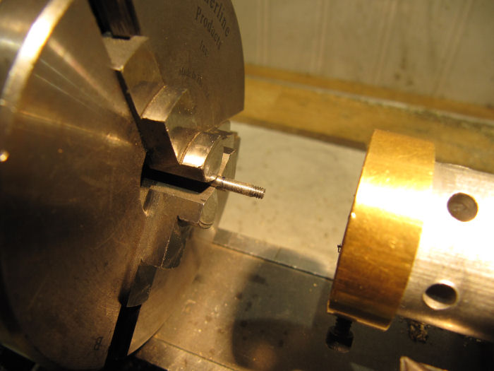

  • Posts: 18722
« Reply #3554 on: March 31, 2019, 05:09:13 PM »
Got the pistons made up this morning, started with threading the bottom end of the piston rods to attach to the crossheads, and a short thread at the top for the pistons. A shoulder was turned in for the piston head, so the nut at the top will compress it onto the shoulder and square to the rod. When all else is ready for assembly, a little loctite will go onto that end of the rod to retain the piston.
The piston heads were turned up as a group, the OD slightly smaller than the bore so the O-ring can form the seal. The rod was notched to form 1/4" thick pistons, then one at a time grooved for the o-ring until it was a nice sliding fit in the cylinder, then the piece was parted off and repeat on the next.
Assembled pistons:
