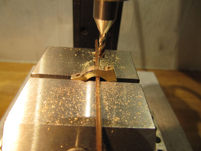

  • Posts: 18681
« Reply #3512 on: March 26, 2019, 07:11:23 PM »
Okay, not much time in the playshop the last couple of days, been getting caught up on article writing and getting some outside time in.
I did get the last of the eccentric follower openings bored out - the expanding arbor really worked out well for that. Then I have started milling in the shapes on the caps:
Once those are all done I'll start shaping the forward ends of each...

Milling the shape on the caps did not take long at all, just a few minutes apiece since they are only a few cuts per arc, they are all done. I've started milling the front pieces on the followers. It was boring the stepped holes for the eccentrics that took a while, lots of on/off the arbor testing for a good fit. I am keeping the followers, engine blocks, conrods, crossheads, cranks, etc together as sets to make sure the lapped in parts stay with the mating parts - it is keeping all that straight and assembling/disassembling pieces that is actually taking longer. Maybe a set of labelled bins with dividers would have been better. Making multiple copies of an engine all at once is quicker than one at a time, but it is a lot to track!

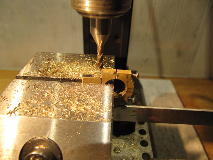

« Reply #3519 on: March 27, 2019, 12:07:07 PM »
Starting in on the shaping for the front halves of the eccentrics - started with notching in the sides in front of the bolt flanges in the sides, then will taper in to the lead edge.

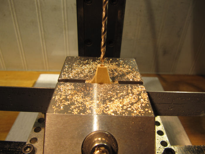

This morning got the sides tapered in with the mill, then used a half-round file to give it some curve.
And drilling the holes for the rod leading up to the valve lever:
The other end of the rods will have a block with a hole to take the pivot pin on the end of the lever...
