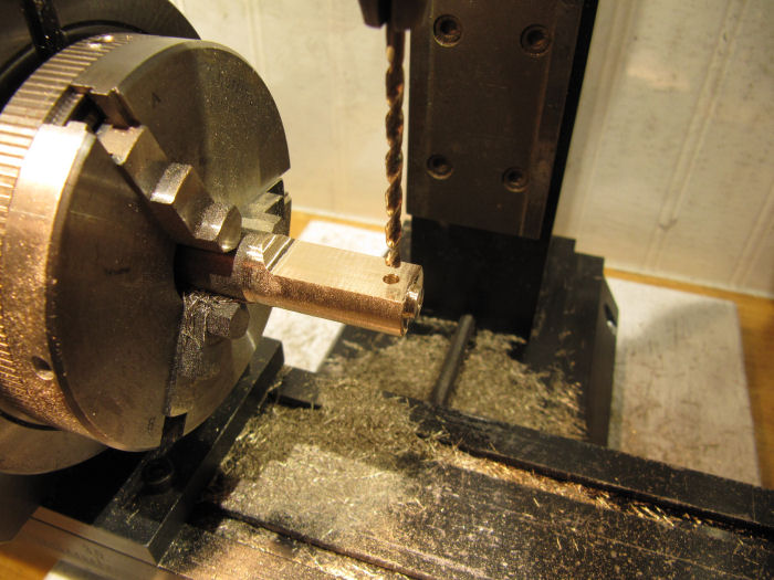

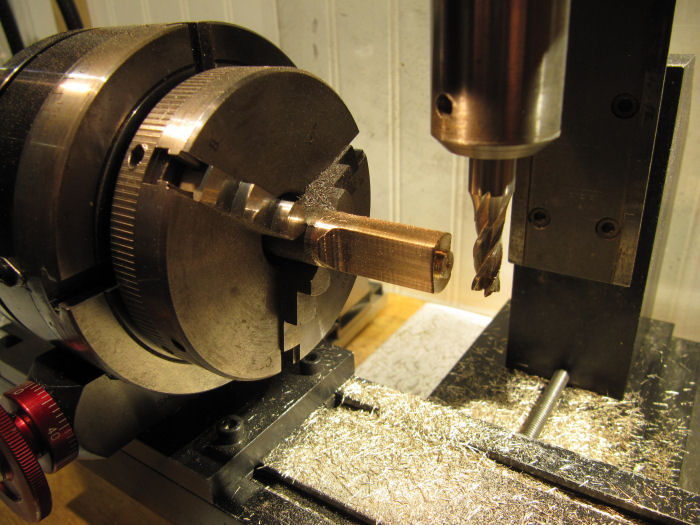

Making up the crossheads, from some bearing bronze round bar. Started by turning the OD to be a slide fit in the guides, turning the boss on the end, and drilling/tapping the hole for the piston rod. Then moved the chuck over to the rotary table in its vertical mount, and milled off the sides...
and turned it another 90 degrees to drill the con rod pivot hole:
Now, the milling could have been down with the rod held in a collet, but these bronze bars are extruded out oversize and a bit rough, so it was better to chuck it in the 3 jaw once and do everything in one go to ensure alignment.

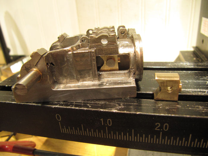

Here are the first couple after parting off, doing the same on the rest:

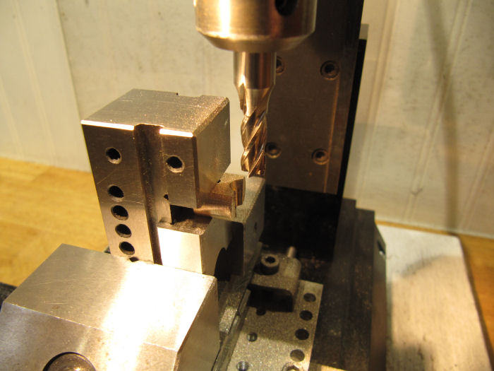

Thats only half the shaping - still need to take out the arc at the conrod end, and slot it for the con rod. Starting out with the mini vise up vertical in the mill vise, to do the first cut at the back end on each part:
Next will be to angle the sides of that arc out to the edges, once all are done to this point.

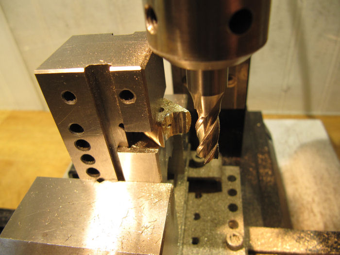

More on the crossheads, angled the parts to the side to mill in the straight section out to the corner:

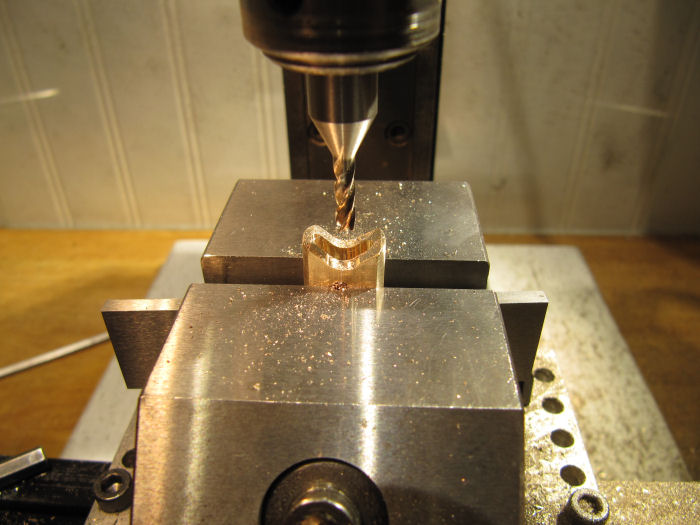

and up on end to mill the slot in the back, the mill leaves a rounded corner so those were finished off with the rotary tool and a tapered bur.
One installed, moves freely, so on to the rest...
