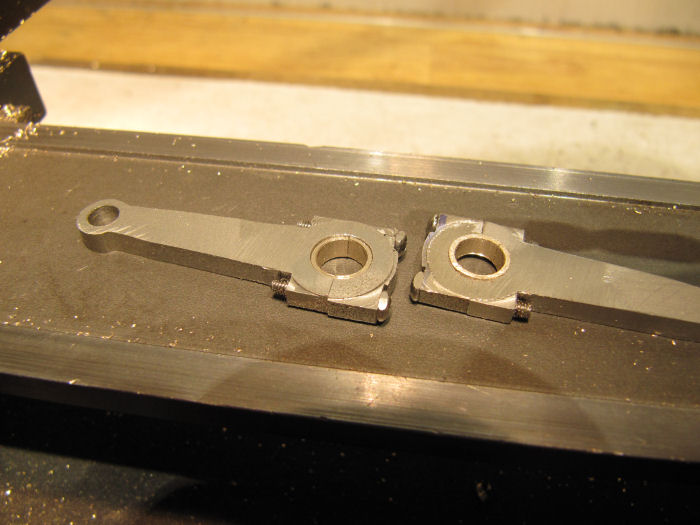

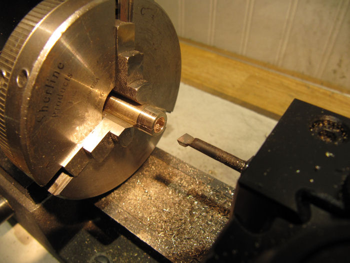

This morning I got a start on the big end bearings. Since these have to go on in the middle of the crankshaft rather than slipping onto the end like most of the others, making them as a two part bearing. Started with a short length of bearing bronze, and sawed it down the middle. Clamped in the three jaw (two jaws on one half, third on the other) it seemed to hold well, so went ahead and drilled/bored the end for the crank pin diameter (hoping for a snug fit that can be lapped to fit rather than a loose fit), and then turned the outside to be a snug fit in the con rod. The OD fit can be checked while on the lathe, the ID can only be done by measurement, so I will not be surprised if I have to remake one or two.
Then slipped on the conrod and used a small hacksaw to part off the bearing from the parent stock. A little filing on the side and it should be good to go. Here are first two:
I'll check the fit on the crankshaft, and if good will loctite the bearings in place, and then can lap them to final fit if needed (expecting that to be the case on most if not all of them). Only had time to get this far before heading out for errands, back at it this afternoon...
« Reply #3467 on: March 18, 2019, 09:28:25 PM »
Rest of the split bearings are made - on the last set I had to switch to the 4-jaw, since the halves kept slipping in the 3-jaw. It worked fine for the first 4 bearings, but the last two no go, so switched over and finished them up. Only one set was too large an ID, rest are just right or a hair snug, will lap in fine I think. So, went ahead and loctited them in place. I did not want to risk glueing the cap to the main part, so I used a bit of flat bar and a clamping rig, just slipped the parts over the end and tightened the cap screws to hold it to set up.

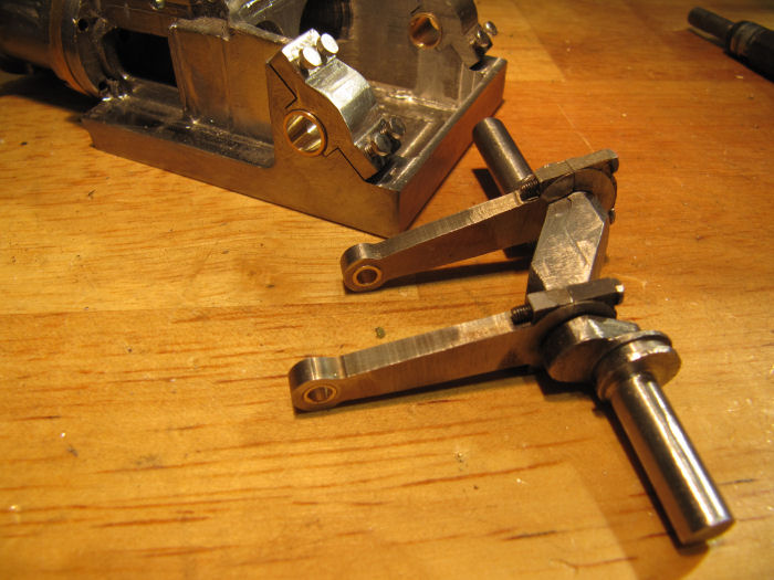

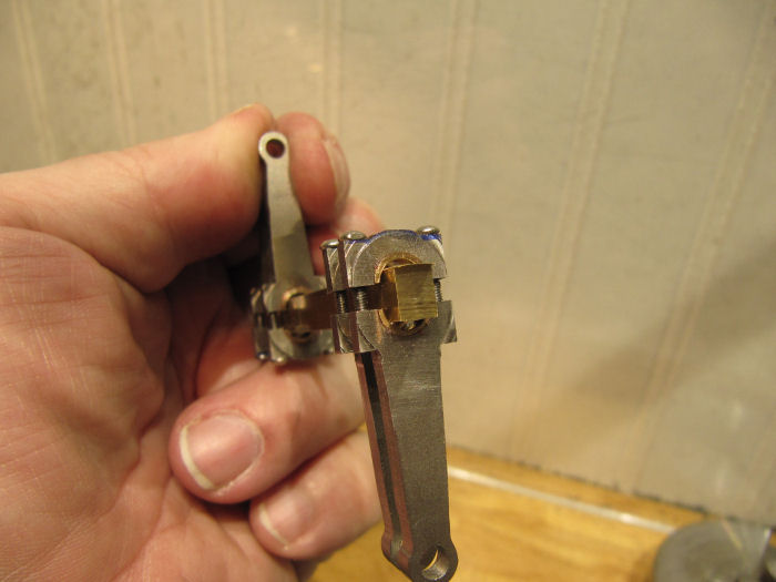

« Reply #3473 on: March 19, 2019, 07:29:18 PM »
Not much shop time today - did get the first pair of bearings lapped to the crankshaft, but the loctite red I used did not hold well at all. Maybe I should have used the green retaining compound version? Parts were quite clean and dry, but surfaces are very smooth. Maybe roughen up the mating surfaces and try the retaining version next...
« Reply #3474 on: March 19, 2019, 08:23:18 PM »
Did some experimenting and settled on filing a couple of tiny wicking notches across the steel under the bearings, and silver soldered them in. The loctite sticks great to stainless and 1144, pops right off bearing bronze.

Got the rest of the big end bearings lapped today, used some Timesaver compound on them, spinning by hand and tightening the bolts down a bit at a time, them finishing with the crankshaft in the chuck and spinning it faster before cleaning them out and oiling. Then made up the small end bearings, which are simple tubes pressed into the con rods. These will ride on shoulder bolts through the crossheads.
Looks like next up will be the crossheads themselves, made out of bronze...
