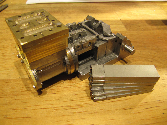

« Reply #3445 on: March 15, 2019, 05:37:10 PM »
Got the recesses in the steam chest lids cut:
and cut the bars to length for the con rods and the end caps, then drilled/tapped for some 1-72 screws to hold them together:
Con rod blanks are ready for drilling and shaping...

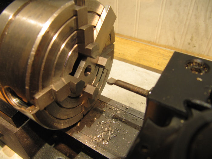

« Reply #3446 on: March 15, 2019, 07:49:43 PM »
And drilled/bored the big end bearing holes (will get bronze bearings in them)

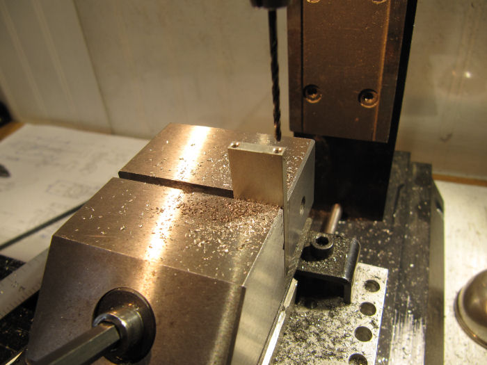

then started drilling the other ends for the crosshead pins - using a bit of aluminum bar as a jig to get them all to match lengths easily. The brass bushing around the screw has a shoulder to hold down the part, and the OD of the bushing lower end matches the holes in the parts.
