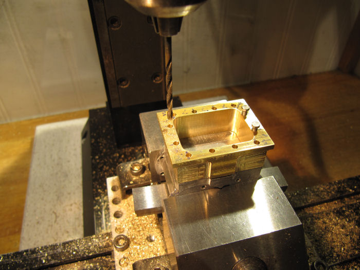

Back in the shop again for a bit this afternoon, got more done on the mounting holes for the steam chests and lids. All the chest/lid holes are drilled, and have started on the matching ones for the base (which is part of the cylinder block). Started out with the first cylinder clamped level in the vise, and used one of the holes in the chest (checking to make sure it is on right way round, twice), and the clearance drill used to make the chest holes to line it up. With the drill run down the hole in the chest, moved the mill table till the edges of the chest line up with the edges of the base. Held the chest in place, turned on the mill, and used the drill to start the hole in the base like a center drill. Raised the drill, moved it over to the next hole, and dimpled there as well. Then switched to the tap drill, and drilled both holes in the base. That let me tap the two holes, and run the chest in with some screws to keep it in position.
Then went around the perimeter of the chest, aligning/starting with the clearance drill and then drilling with the tap drill. That way there was no chance of the tap drill skating around. Here are all the holes in the base of the first cylinder:
I'll get those tapped, and do the same for the other two cylinder assemblies...

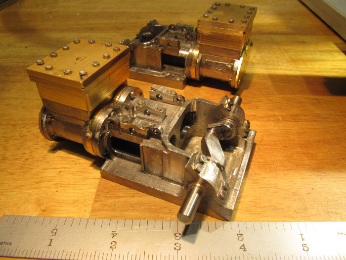

« Reply #3430 on: March 14, 2019, 09:57:17 PM »
First two steam chests drilled/tapped/assembled, one to go...
