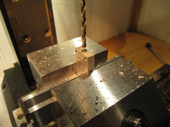

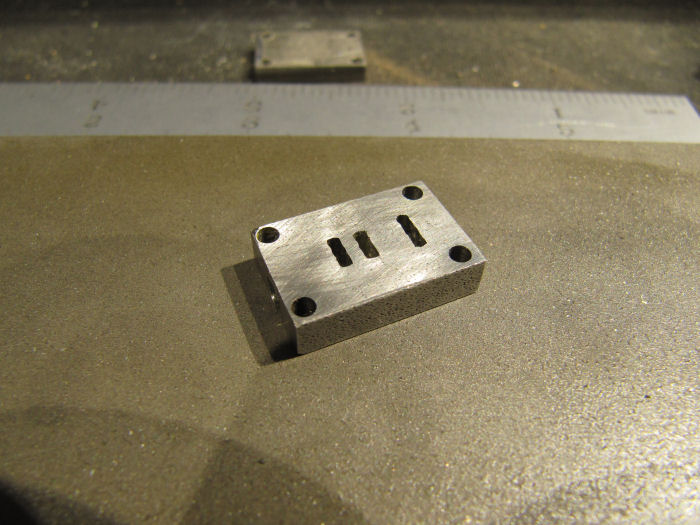

Chain drilled the port slots, and drilled the inlet/outlet passages which were also counterbored to take the ends of the pipes.
Then a couple minutes with the air handpiece and dental bur to connect the chain drilled holes and square up the ends of the slots. The valve face was then lapped on a pair of diamond plates, finished with some diamond lapping compound on a flat plate (I was taught to use these methods to sharpen wood chisels/planes by a master boatbuilder years ago - makes for a razor edge). The final step with the finer lapping compound had to be skipped since that tube dried out from old age, and the replacement has not arrived yet. Still, quite a good finish on it as is - when starting to lap the surface it quickly showed how un-flat the side of a piece of rolled steel is, the sides were higher, the center lower, and the surface had lots of little micro-pinholes in it. So, took it down past those imperfections, and it SHOULD be a good seal with the valve slider.
Here are the parts so far:
Next step is to drill/counterbore/tap the hole for the control rod in the end of the steam chest, then get the steam pipes soldered in to the base plate. Also need to make the new flange plate that takes the steam up to the axle of the hoist drum.

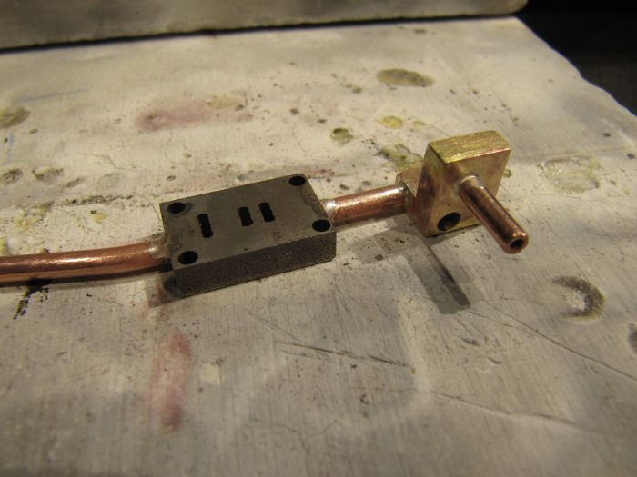

« Reply #2581 on: December 05, 2018, 06:05:27 PM »
Pipes fitted and silver soldered in place, just need to plug the ends of the passages and get the control rod bushing drilled/tapped into the steam chest...

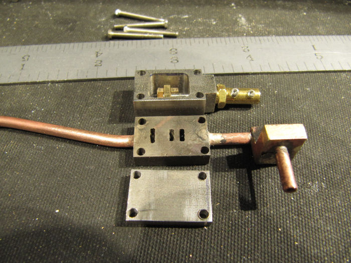

« Reply #2582 on: December 05, 2018, 06:57:52 PM »
Control rod bushing drilled/tapped, everything is moving smoothly, and it passes a low-pressure (blowing in inlet pipe) leak test with valve closed, can hear air through with it open, so on to making the gaskets for the steam chest...

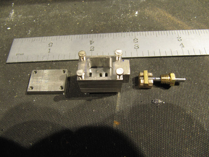

« Reply #2583 on: December 06, 2018, 02:54:58 PM »
And we have liftoff! Well, hold-down? Anyway, the new clutch valve is in and working well. I made up the paper gaskets for the steam chest this morning, and got everything installed. Still a little bit of an air leak around the pipe that goes into the axle, but I kind of expected that since there is no compression fitting on the o-ring (it would take up room on the outside of the axle that I dont want to use), and it works quite well as is.
