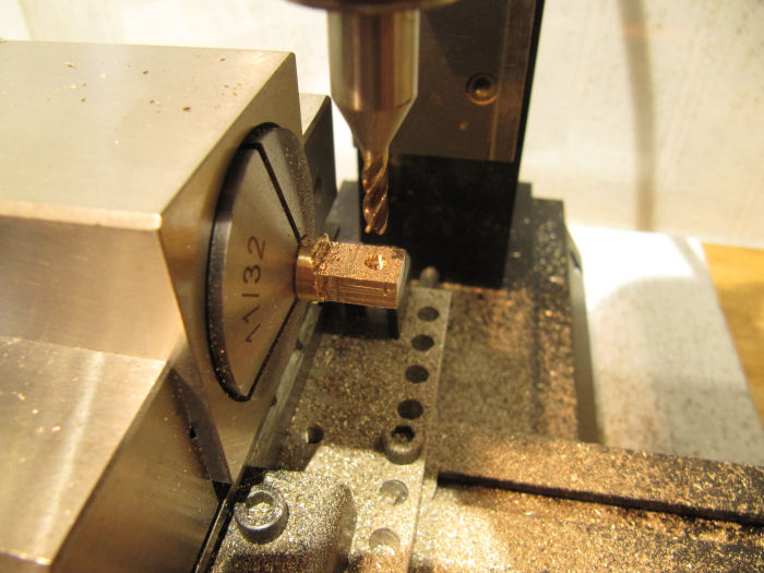

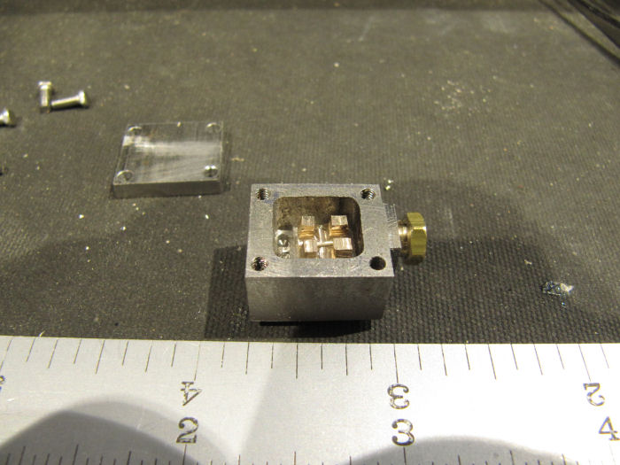

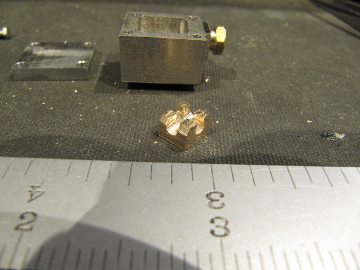

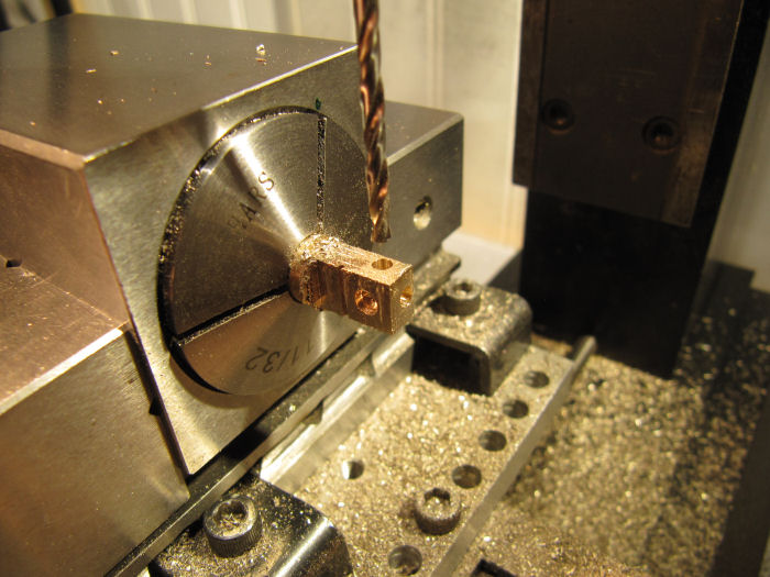

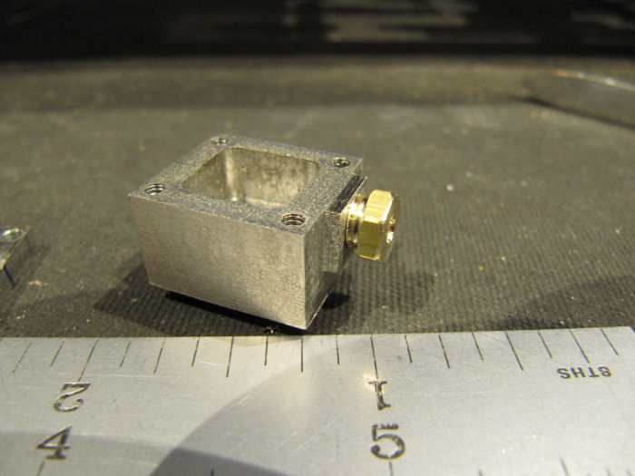

Made up the stuffing gland for the valve control rod out of a bit of hex rod, threaded M5 on one end and drilled through for the control rod.
And got started on the valve slider - this looks like a standard D-valve slider, just is a little shorter since there are only two ports to go over - the output and the exhaust. The input port at the end just fills the steam chest. The slider was milled on the end of a offcut of bronze left over from one of the bearings. Milled to outside shape, then a recess milled in on the bottom to connect the two ports.
Drilled through above the recess for the control rod and the adjusting nut - these holes form the bottom of the slots. Did it this way since I do not have any end mills down this small.
Got out the air-powered rotary tool and a small dental burr, and squared up the recess opening and opened up the tops of the slot. This was done freehand with a strong magnifier.
Test fit of the slider in the steam chest - slot is good depth, think I will need to file a touch off the end of the slider to get proper flow on the ports.
The slider so far:
Time to make the control rod and the adjusting nut...

Not much shop time today (mothers birthday!), but I did make up the control rod and the adjusting nut for the slide valve on the clutch.
