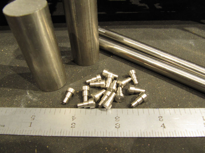

« Reply #2397 on: November 08, 2018, 08:57:06 PM »
Was out and about most of the day, this afternoon got a start on the drive nubs for the U-joints on the track drive shafts. There are four of these at each end, they will be set into the round end of the ball at the ends of the shafts, to be made next. The big bars at the left top will be those balls, the narrower bars are the drive shafts themselves. The outer housings will come after these parts are made...
