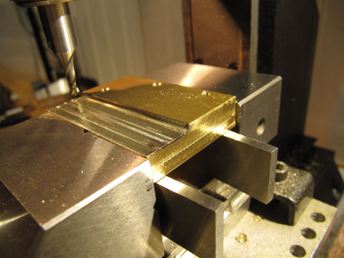

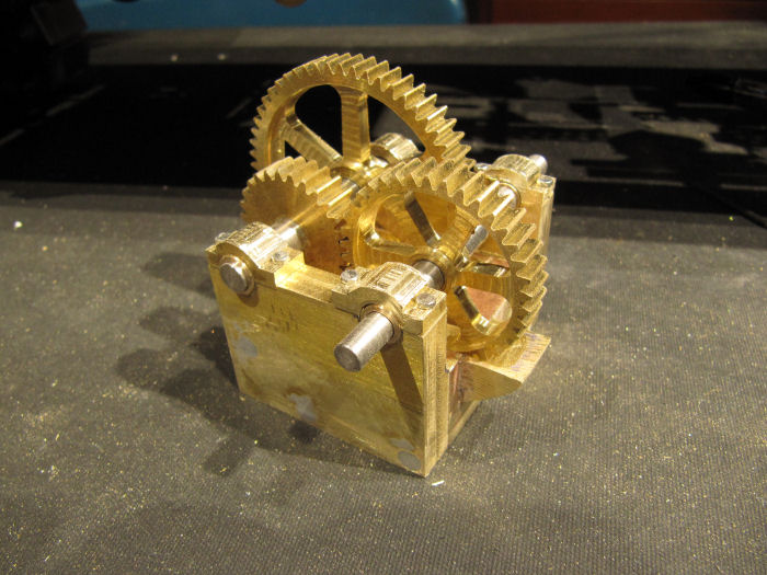

Continuing on with the travel gear holder, thinned the lower section of the side plates to size, and finished the inside corner with a ball end mill.
Also took a light truing cut on the top surface to even out the plates and the solder.

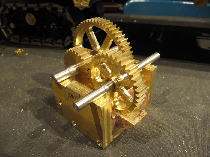

The axles are turned and the gears loctited in place. After that cures, will make the bronze bearings and start on the bearing caps. The top overhang and the braces out the sides still need to be made and added on, but its easier to hold in the mill vise to do the bearings before they get added on.
  • Posts: 7948
« Reply #2362 on: November 04, 2018, 01:24:45 AM »
Looking mighty sharp there, Chris!
You may need to get the elves out there with the acetone and a shop rag.  Looks like some graffiti on your brass there.  Hey, maybe the elves are out tagging things at night?  Do you have rival elf gangs?  :ROFL:

Actually that one is a note on the mesh distance on the two gear axles. I use permanent markers a lot on parts for layout lines, measurements, orientation notes, etc. Nice thing is that with a little alcohol on a tissue the marks come right off, as long as they haven't been there too many days.

« Reply #2364 on: November 04, 2018, 02:31:42 AM »
Hi Chris , looking good..just a thought about how strong the lactate Loctite is ,so how much force would it take to "give"  say in foot pounds !!To move one of those gears on its shaft ?? :-\ :thinking:
  • Posts: 18716
« Reply #2365 on: November 04, 2018, 02:48:06 AM »
Good question, I have not done any calculations on that, but have never had it fail yet (always can be a first time!) The gears are around 3/8" thick (hoist gears even thicker) so there is a large surface area for it to grab. The times that I have tried turning two gears on same shaft against each other by hand, nothing moved. If any is likely to it would be the final gear, getting the most torque from the tracks. Time will tell, can always add a pin or screw if it does let go. On crankshafts I like to add taper pins as extra strength.

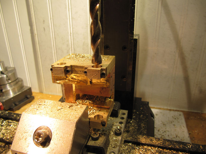

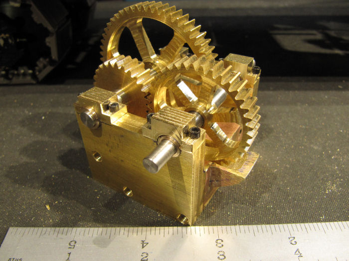

« Reply #2366 on: November 04, 2018, 06:41:43 PM »
Bit more done this morning on the travel gear train, made the blanks for the bearing caps, and drilled through for the axles:
Test fit on the axles, looks good, ready to round off the tops of the caps, then get started on the side webs:

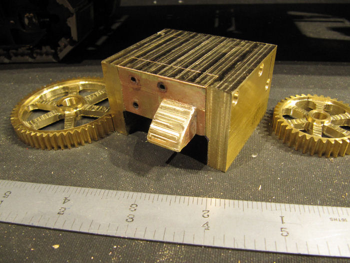

Again, here is the render of the finished parts, the webs I am talking about are the thin overhangs and the braces at the bottom center, which provide a place to bolt through into the I-beams:

« Reply #2368 on: November 05, 2018, 02:38:19 PM »

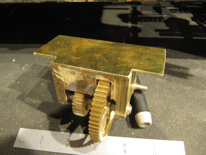

The bearing caps have been rounded over as usual and assembled onto the main block:
Next up is the top plate and brackets, starting out with a piece of sheet stock for the top, that was sawn out and filed, it will be screwed to the top of the main block. The vertical brackets will be milled out of some more sheet stock, and silver soldered to this top plate, probably using some small screws or pins to keep them in place for soldering.
Oh, and the screw holes in the base have been filled with some JBWeld.

« Reply #2369 on: November 05, 2018, 04:20:11 PM »
Since the webs are purely decoration to  make it look like the original have you considered attaching them with JB Weld? It would be simpler than the drilling and tapping and silver soldering. You could even create a small filet in the corners as a casting would have had. It will all be painted anyway.
 Even soft solder would do and might not require the pins.
