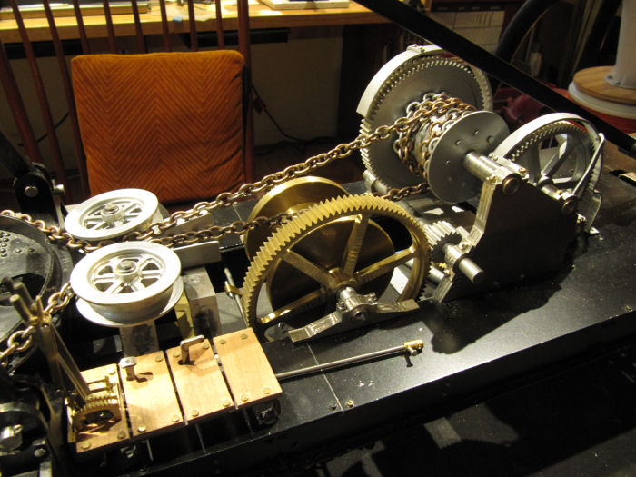

« Reply #2281 on: October 22, 2018, 10:33:05 PM »
Catching up on the recent work - made and installed the half-loop that holds the end of the hoist chain...

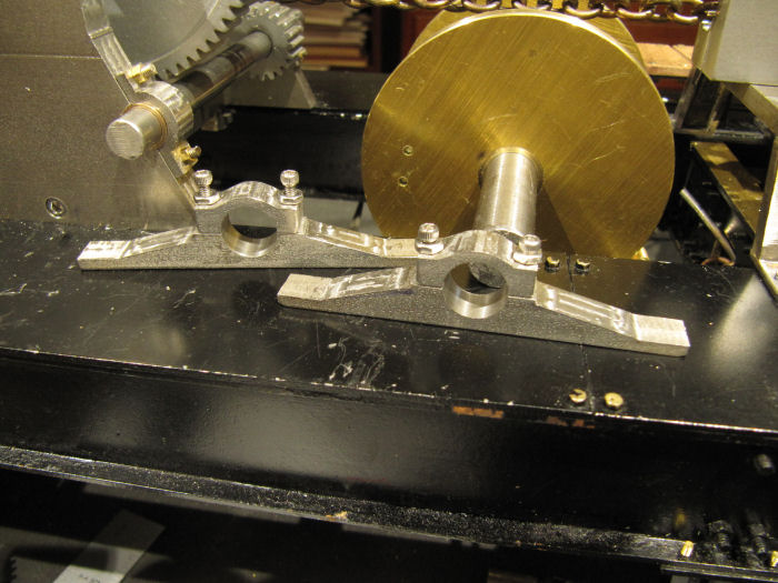

And made up the bearing holders for the hoist drum:
Here they are with the shaping done, ready for the bronze bearings and mounting bolts to the floor. They take a huge horizontal load, so they made the bearing blocks very long to spread the shock load across length of the I-beams.
Next up will be to start shaping the axle...

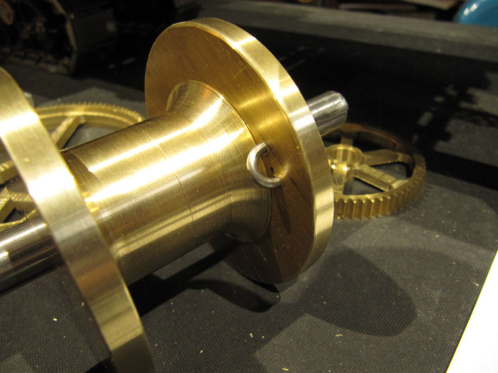

« Reply #2294 on: October 23, 2018, 03:36:19 PM »

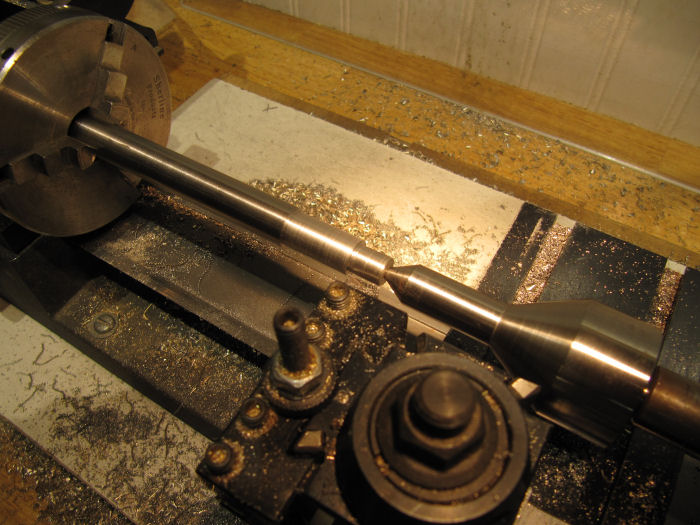

This morning I got the hoist drum axle turned down to shape. The middle was left 1/2", the ends turned down for the gears and bearings. The end with the large gear was drilled on the end for a #6 o-ring, which will be used for the steam feed into the hoist clutch on the large gear. A 1/8" passage beyond the o-ring seat was drilled up to the base of the large gear.
Then a cross hole was drilled to meet the steam passage, this hole will take the steam up to the clutch piston on one of the spokes.

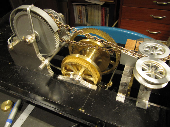

Here are a couple shots of the parts test fit on the main frame. Still more work to do on the large gear to fit the clutch and counterweight, and need to drill the mount holes for the bearing blocks into the I-beams.
