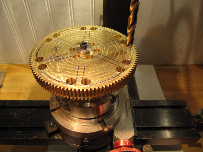

« Reply #2214 on: October 09, 2018, 09:42:21 PM »
Okay, back on the Marion build!
The first few pictures below were from just before the trip but not posted.

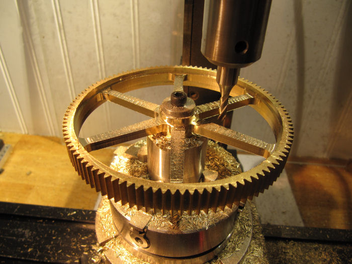

Started out cutting the spokes in the last and largest gear as with the other gears, used the angles and distances from the 3D plans to drill the corner holes in each of the spoke openings, the outer holes are a larger diameter than the inner ones.
Then milled the outer arc, starting in from the finished dimension a bit and going back with some light cuts to take it out tangent to the drilled holes with a smooth finish.

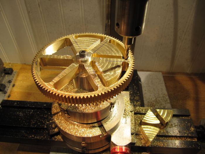

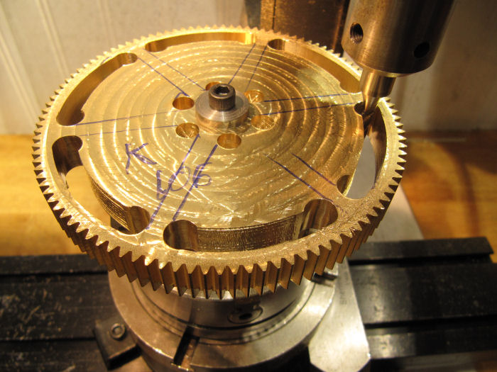

Then came down the first inside edge of each spoke, again first in a bit then finishing with lighter cuts out tangent to the holes and a smooth finish. Repeated on the second inside edge, which freed up the central pie pieces, which will be good for something later on I am sure. The first cuts were done in a series of shallow passes, since this stock is nearly 1/2" thick.

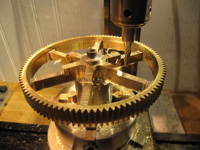

Then came back and milled away the first side of each spoke to thin them down:
and flipped the part over to do the same on the other side:

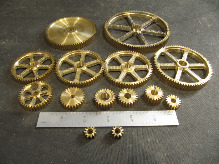

And here is the whole family of gears for the slew, hoist, and travel gear trains, including the two small ones at the bottom which will be used on the crowd engine crankshaft to drive the big gears out on the main boom.
Now THAT deserves some cookies!

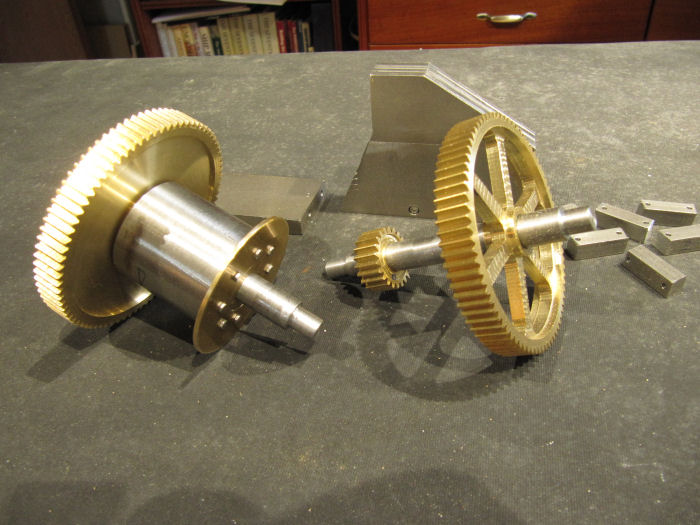

« Reply #2218 on: October 10, 2018, 04:17:51 PM »
This morning I started making up the axles for the slew gear train, here are the two axles assembled with the gears, loctite retaining compound is on and setting up...
Before I put the winding drum on for good, I need to put on some U-shaped retainers for the ends of the slew chains.

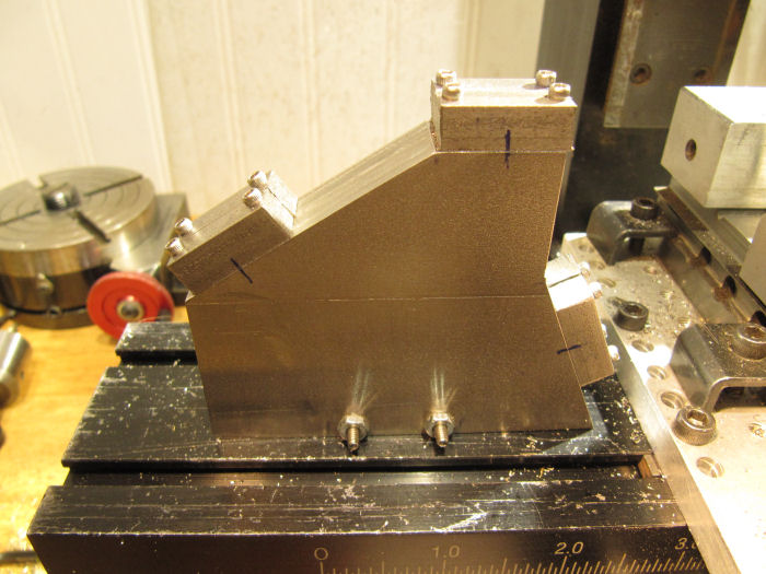

Today I got a start on the bearing holes/caps for the slew gear train - with the two sides of the base are still bolted together and aligned, drilled and tapped the holes to hold the caps on. The caps are just rough cut to length, after drilling the shaft/bearing holes, the caps will be milled to final shape. Doing all of the holes in one assembly like this should ensure everything lines up. I hope.
The lower left cap holds the intermediate shaft, the gears on that engage in the gear on the engine crankshaft, and to the final gear. The upper/right cap holds the final gear and winding drum. The lower right cap will hold the crankshaft for the hoist engine - it will have a gear that engages the hoist gear train that sits next to this one.
