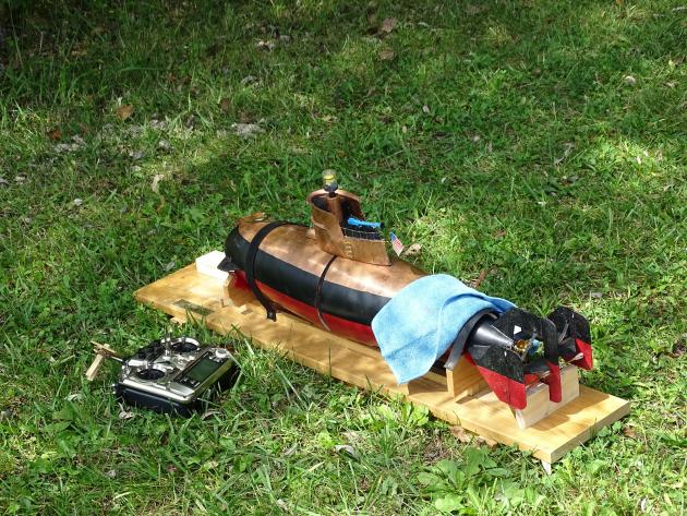

Okay - one of the others there posted a bunch of pics of the sub run day, here we go:
Thats me on the far right of the line...
The gizmo there on shore is our sub launcher, saves kneeling down and out over the water with heavy boats. The water was low yesterday, so it was used more as a cane when wading out!
A great weather day all round, lots of fun company too!
