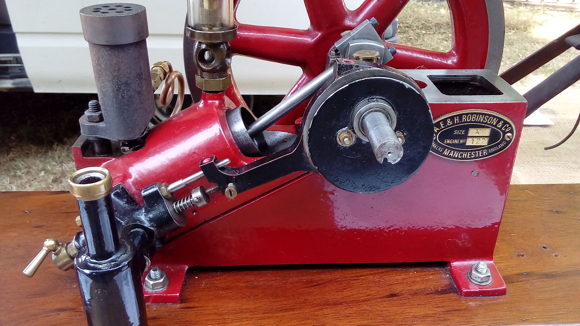

« Reply #395 on: July 07, 2018, 05:06:13 PM »
I spotted No 122 at the Guildford show today. Interesting that it did not have the usual ring of holes on teh inlet valve block but an inlet at the opposite side to teh gas inlet and air flow was controlled by a small "cock" valve.
Offline RayW
  • Posts: 735
Re: A Robinson from rejects.
« Reply #396 on: July 07, 2018, 05:59:09 PM »
Back from a very hot four week tour of Germany and France and keen to get back in the workshop, but just too hot at the moment. Have been looking for a suitable wooden base for the engine and found a firm in Scotland on eBay who make wooden chopping boards in a variety of timbers and will make to whatever size you want. Have ordered a nice piece of oak which should show off the engine nicely. At least the heatwave has been beneficial in really hardening off the paint job on the engine before I attempt to get it running again.
That's an interesting variation of the inlet valve on engine 122, but I would have thought that it would make getting the balance of the gas/air mixture even more difficult as it appears that you need to adjust both the gas and the air tap instead of just adjusting the gas inlet.
Ray

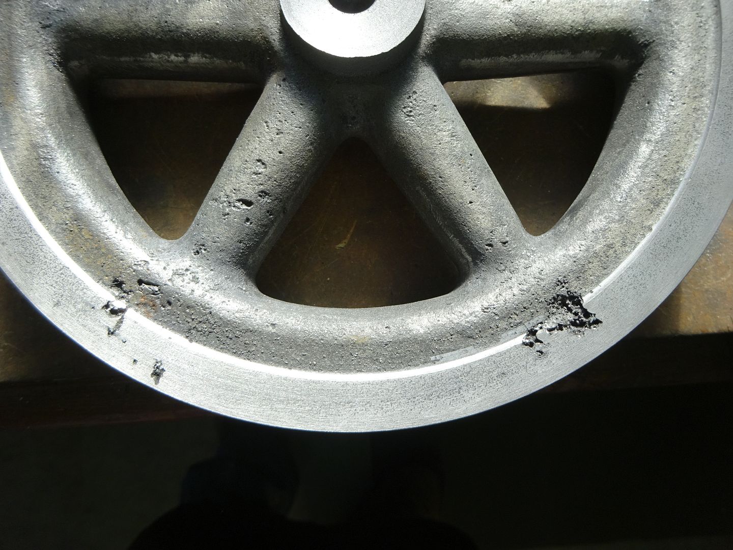

Number 202 has been sitting in the workshop for the last couple of weeks in it's new shiny paint waiting for some weather that was more conducive to starting engines.
Despite what one or two may say we all know that an engine is not really finished uptil it has been painted and runs. So with a drop in the temperature and the prospect of more castings arriving soon it was out to the workshop early for some flywheel flicking :LittleDevil:
<a href="https://www.youtube.com/watch?v=nq3FptbMBrE" target="_blank">http://www.youtube.com/watch?v=nq3FptbMBrE</a>
I'd like to say thanks to Graham for making this engine possible by providing some of his rejects and the wisdom he has shared with those of us building the X-type in this thread.

« Reply #398 on: July 28, 2018, 03:50:12 PM »
Well done Jason.
Very nice indeed.    :ThumbsUp:
Only you and I know how bad some of those castings were, to see the engine running flawlessly and remembering the original state, number 202 is a credit to your engineering/fettling skills.
Cheers Graham.
Post Script.
I've just noticed yours and Ray's previous posts. Just looking at the engine you spotted at Guildford is that number 128 rather than 122? The picture gets a little blurry but really looks like an 8 rather than a 2. Once clarified I can give the name of the original purchaser.

« Reply #399 on: July 28, 2018, 04:10:31 PM »
Thanks Graham
Definately 122 to my eyes

« Reply #400 on: July 28, 2018, 04:23:36 PM »
You're welcome Jason.
Most definitely 122!!
The kit was originally sold to a Mr Brian Adaway in late 1990, he became one of my " regulars " and bought many of the Alyn Foundry range.

« Reply #402 on: July 28, 2018, 04:50:27 PM »
Well I suppose I can let out the secrets of what Graham and I know about the castings and why they were the rejects of the rejects pile. I may well make up a pully to go on the gear side of the crank as that is what would have been used to drive the chip chopper so no real need for a bright finish on the flywheel. You do see quite a few full size with painted flywheels and bright pullies, it's just that some people like a bit of Bling.

« Reply #404 on: July 28, 2018, 09:08:33 PM »
Beautifully done Jason and an excellent job finding a way round the casting defects. I would like to echo Jason's thanks to Graham for all his advice and encouragement to us all.
