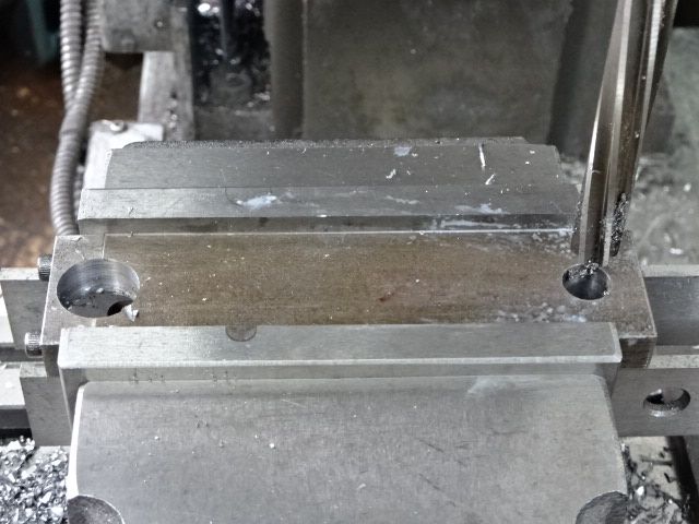

The cooking of the exhaust block did the trick and it machined up nicely though I did have to deviate from the drawings in a few places to make my worst of the rejects casting work. Also made the Exhaust valve, spring collet, tappet, Eccentric rod guide pin and end plug.
One item that did give me problems was the hole for the pin that stops the gearbox rotating, barely managed to drill it and blunted the drill good and proper, took a few more teeth off an old 2BA tap trying to cut a thread and then found the hard spot had made the drill wander so the pin did not line up with the hole. So ended up plunging the hole with a 1/4" carbide slot drill which still struggled and made a pin with a spigot to fit this hole and a small flange to locate it and will JB Wled that in place.
