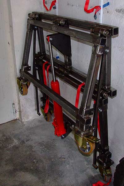

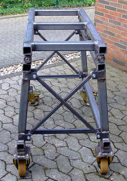

The welding table is ok in that its portable and can be folded away but its a bit on the flimsy side and not “flat”. I would love a cert-flat fab block.  Just no space to put one plus I need a foldable solution.
This gentleman (Stefan on mig-welding.co.uk) has a design I’m very tempted to try.
http://www.mig-welding.co.uk/forum/attachments/streben1-jpg.6657/
http://www.mig-welding.co.uk/forum/attachments/geklappt2-jpg.6674/
See Stefan’s thread at: http://www.mig-welding.co.uk/forum/threads/fold-up-welding-table.9318/

I hear you.  The fold away option from Hazard Fraught (aka Harbor Freight, our Chinese tooling importer here stateside) has worked for me so far.  I have a 1" thick by 12" square chunk of cast alumin(i)um tooling plate (ground flat and parallel on the 12x12 faces) that I use to weld stuff REALLY square, but most of the time "more or less squarish" works.
I had visions of me laying under that uk guy's welding table after it collapsed on me trying to fold/unfold  :ShakeHead: ...then spotted the cylinder he uses to jack it up - makes more sense now.  That is pretty stout.  Maybe someday.
