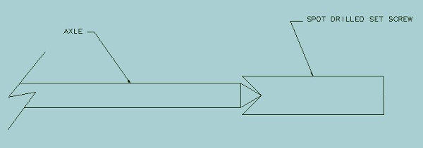

Hugh, that should be a good test project for the Sherline. Jerry Howells 1/2 scale Miser is a good one as well but a bit fancier. You may want to consider ball bearings for the crankshaft as they will reduce friction greatly which is critical in LTD Stirlings.
  • Posts: 2623
Re: Currin's LTD Stirling
« Reply #2 on: June 27, 2017, 08:03:51 PM »
If you do use ball bearings on an LTD Stirling, it's a good idea to wash out all the bearing lubrication with solvent and use them dry..  Cuts down on the friction and it's not like an LTD is going to put much load on a bearing.

Bill & Marv: It's not as bad as it looks. Jan is using a point contact for the bearings:
The ends of the axle are pointed (60 deg included). It is then supported in set screws that have been spot drilled (90 deg included). The set screws in each post adjust the load/clearance. So theoretically there is a point contact for rotation. I think this is used in clocks and watches? It should work OK??
Mike: Great to hear you are bringing along a young machinist. It'll be a real advantage for his engineering career. Are you doing a build log?

The main shafts on clocks are stepped ends through a barrel shaped hole typically,  this type of point bearing is used on jeweled bearings in watches. I think.

I have seen graphite rod used to make ultra low friction crankshaft bearings for an LTD Stirling engine. Graphite rod is readily available on evil-bay. I never fell compelled to build an engine as per drawing, if a small change can lead to an improvement, it is worth a try. If it does not work out, you can always follow the drawing.

On ones like that I have used Loctite in conjunction with a cross pin through the joint, never had one fail with that combination (tight fits are a must). I usually just hacksaw through the bar to remove the section, then file it smooth.
Thanks. However I can't cross pin this one. I'm sure some here could but I can't. Trying to drill through and pin a 3/32" shaft is beyond my abilities. Do you think just locktite would be enough?
Thanks again.
Hugh
Thanks again.
Hugh
For a Stirling, it should be enough, lots less torque than an IC!
For cross drilling the holes, if your hole is first started through the web, then the web itself will act as a drill guide for the round bar. To the drill, it will just look like a single drilling through the rectangular web cross section. Even if it is off center a smidge, it wont matter as long as you loctite the webs on and THEN drill for the pins. This assumes the webs and shaft are the same alloy metal, otherwise it could dig in differently and wander.

Hugh, for a LTD Stirling, Loctite alone should be sufficient. You could even pre cut the 3/32" stock and make a simple fixture to make sure each crank is aligned first and then to make sure they are 90 degrees to each other and not have to cut the center sections out. As long as the holes through the crank throws are a good close (maybe even snug fit) things should stay in alignment overall as well.

OK. I think I've got it. Both Bill and Dave suggest locktite should be OK for an LTD Stirling. I agree. Both also suggest cutting the shafts to length to avoid "grinding out" the main shaft between crank throws. I thought of this but wasn't sure I could align the parts. They think it's possible so I'll give that a try. It's by far the easiest solution, if it works.
I'd though of using the mill. Mount a bar in a 3 jaw on the milling table. Then drill that bar 3/32". Move the spindle up without moving X or Y. Finally clamp one end of the main shaft in the spindle and the other fitted into the bar in the three jaw. Should be as square as the mill is trammed and its TIR. As Dave said, assemble the crank pins first, then the whole assembly. (I don't have any V-Blocks with me.)
Thanks all. I at least now have a direction.
Hugh

Hugh, that should work as long as the 3/32 hole is drilled straight. For fit purposes, drilling undersize (still straight of course) and reaming 3/32 might give a better fit if you happen to have a 3/32 reamer on hand.
