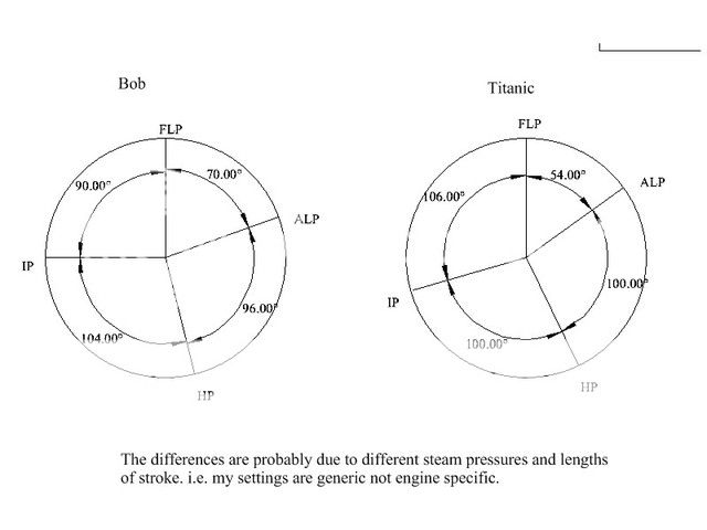

Triple Expansion Steam Engines
1. Cylinder Volumes:
HP = 1.0
IP = 2.6
LP = 7.0
To keep the LP Cylinder a manageable diameter it was split into 2 cylinders at 3.5 x HP volume giving a 4 cylinder triple expansion engine normally arranged from front to back LP,HP,IP,LP.
With this arrangement balance was achieved by setting the cranks at:
Between Forward LP and HP 1660
Between Forward LP and IP 2700
Between Forward and Rear LPs 700
In addition suitable counterweights were added to the crankshaft.
With Titanic and Olympus, not shown is a turbine which utilised the LP exhaust to drive the centre propeller. For manoeuvering the exhaust was switched over from this turbine and sent directly to the condenser. This made emergency reversing/stopping difficult as until this exhaust was removed, the turbine continued to move the centre propeller ahead. Transfer was accomplished by some big hand operated valves!
HTH

G' day Maryak,
I am a bit confused with order of arrangement for each cylinder, in the attached first photo Cylinder No.-1 is not at the same timing as Cylinder No.-4. Your numbers show each LP ( 1 and 4 ) are each at 70 degrees. In the photo, No.-4 appears to be close to 160 degrees ( or so ) opposite from No.-1. It looks like No.1 and No.3 are the same. Am I looking at this incorrectly?
Thank you,

Hi Thomas, I can see what you mean about the angles, though I think I have interpreted them slightly differently from what you have described.  The penny dropped when I read Maryak's post, that the angles are only nominally about balance, but the odd angles come from the need to progressively expand the steam a bit in the hp cylinder, then transfer it to the ip cylinder and expand it a bit more, then finally transfer it to the lp cylinders where we not only expand it a bit more, but also provide as steady a flow as possible to the turbine which is a continuous steady flow machine.  There are compromises along the way, especially if the cut off varies as speed is reduced to cruising speed from maximum.  I will leave it to Maryak to add a bit more explanation, I have attached a little sketch showing my interpretation of his figures.  You will note I have drawn it with the hp cylinder at top dead centre.  If you think about the hp cylinder as the engine rotates, you can see that steam admission to cut off follows much the same sort of pulsation says a single cylinder engine as you would expect, with steam into the top of the cylinder for the first half rotation, and into the bottom of the cylinder for the second half.
Then if you look at the lp cylinders, the rear lp which I have labelled RLP, is exhausting at max volume, while the FLP so just starting to exhaust at minimum flow.  The combination gives a fairly steady flow to the turbine for the first half revolution.  Similarly the bottom end of the lp cylinders gives reasonable steady flow for the second half.  The angular difference between them seems to give quite good flow for the whole revolution, another reason apart from sheer size for having two lp cylinders.
So it remains to see if the ip cylinder properly accepts exhaust from the hp cylinder and exhausts it to the lp cylinders in turn.  Its a bit mind bending, but if you turn the drawing around, or redraw it so the ip cylinder is at top dead centre, and follow the similar thought process, I think you will find it works.  The complication is when the cut off varies, when the process might be a bit less smooth, and the volume of the steam crossover piping and steam chests become important.  I am hoping that Maryak will shed some light on that as well.
I am suspicious that the artist might have taken some liberties for artistic presentation, not expecting anyone to analyse it in this much detail, or maybe the artists angles will also work, I just don't know.

I found this information and drawing on the internet and it is pretty straight forward in explaining the cylinder arrangement. Hope this will help.
Titanic’s 4-cylinder reciprocating engines were balanced on what was called the Yarrow, Schlick, and Tweedy system. The crank throws were not arranged at 90-degree intervals as one might assume. Instead, vibration was reduced by adjustment of the relative crank angles and crank sequence being used. Beginning with the HP cylinder piston at top dead center (TDC), the crank sequence and angles of the engines were: HP at TDC, then a 106° rotation for the IP to TDC, then a 100° rotation for the forward LP to TDC, then a 54° rotation for the aft LP to TDC, then a 100° rotation for the HP to return to TDC. This is the link to the website: http://www.titanicology.com/Titanica/TitanicsPrimeMover.htm
This crank arrangement is shown in the diagram below.

« Reply #205 on: August 05, 2017, 01:14:09 AM »
G' day Maryak,
Thank you,
Hi Thomas, sorry to be late in responding below is a diagram which I hope explains the differences
Regards
