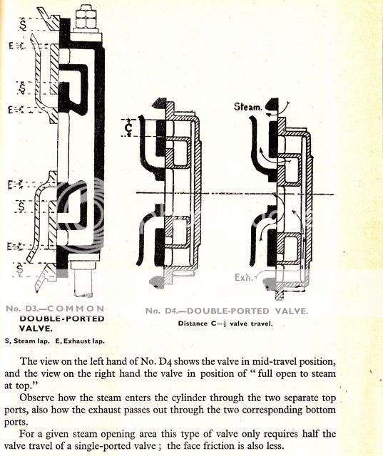

Hi, Also in an infernal combustion engine the inlet/exhaust ports are different sizes and the cams can be set differently . so .could a steam engine have four ports  2 for the inlet cycle and two (larger)? for the exhaust cycle ? My brain is really starting to hurt now.!! Is it because i am an autodidact ??................
Some steam engines were fitted with double ported slide valves.
