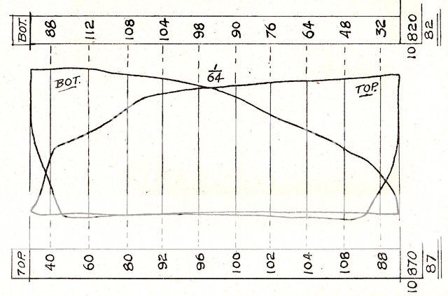

  The conventional presentations do not easily show both sides of the piston at the same time.
By that do you mean simultaneously? I ask because in full size double acting engines using a Dobie McGuiness Indicator both strokes are recorded on one card then calculated to give the mean cylinder IHP.
Of course one stroke is recorded then the cocks switched to record the other stroke immediately after. This is a finicky and fickle operation which usually takes more than one attempt to get an acceptable card of the cylinder.

Thank you Maryak for a really great example of an indicator diagram showing top and bottom faces of a double acting cylinder.  It appears to be very realistic.  Did you by any chance take it yourself?  It certainly shows some interesting departures from the "ideal" diagrams we often see in text books, and many details which I would like to come back to later.  I had thought that presentation would not illustrate what I wanted, but now, on looking at it carefully, I think I will use it after all in due course.
Your welcome. No it is not one taken by me, (I'm a little more clumsy with the stylus). It is from Southerns Verbal Notes and Sketches.

Maryak, I know what you mean about the difficulty of getting such a good looking diagram from the instrument.  However, from that source, it is clearly well informed about a real indicator diagram, unlike most I have seen, which are constructed more to show an ideal engine cycle, and do not reflect a real machine.  It is a great example and I am sure I will be referring back to it.  Thank you.

The book I referred to, (Vol 1), contains many indicator diagrams with various results due to +tve -tve pressure, improper valve settings, ring wear etc. It may be worth a trip to a library or steam preservation society.
