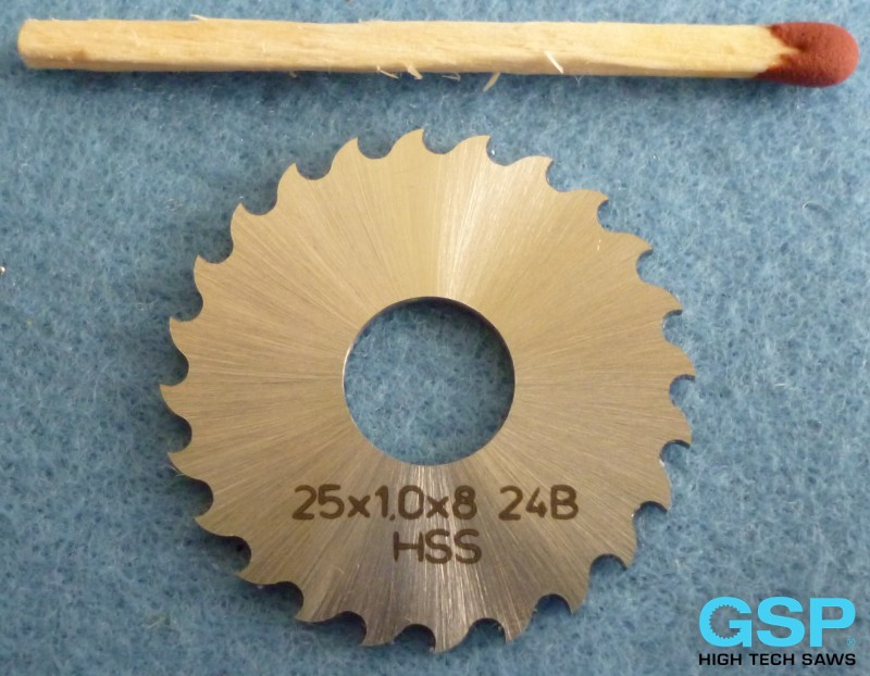

I used a slitting saw to cut the steam passages into the valve bore which turned into a tense machining operation with a lot of squealing and grabbing - thankfully completed without mishap.

- which turned into a tense machining operation with a lot of squealing and grabbing -
That is kind of normal if you use a slitting saw like that with such a big engangement angle.
Your machine would have to be extremely stiff as well as the mandrel that holds the saw. Even then it can happen.
It should work way better if you:
- use a slitting saw with less (and coarser) teeth - maybe even a single tooth tool (fly cutter like)
- if you have cnc: use a trochoidal milling strategy (so the engagement angle doesn't get too big)
- without cnc: put the part onto the rotary table and then rotate the cylinder to take small cuts with the slittig saw
But nice work anyway!
Cheers Florian

Thanks Florian.  I did go for a fairly coarse toothed saw - 40T - was worried that any coarser risked a big grab as the saw broke through into the valve bore.  I also used something like the trochoidal method you mention by hand by plunging the saw for a short distance then shifting it a few mm in the other axis before plunging again and repeating multiple times.
Well the one on your picture is pretty much fine in my opinion. Thats what i am talking about when I say coarse:
(picture comes from here: http://www.slitting-saw.com/Slitting-Saw-HSS-and-Carbide-saws/Slitting-saw-DIN-1838-B/)
The risk of grabbing is real, but with small steps it should be possible to manage doing it without grabbing. What you described as the "manual trochidal milling" is - as I see it - exactly the right thing to prevent it from grabbing. Only I would plunge in the middle and then "cut it free" on both sides - lets say like 2mm in each direction. This way you should be able to have only the center of the blade cutting when plunging (which is the difficult operation when you cut with the full width of the blade)
However, it went well and thats what is most important 8)
