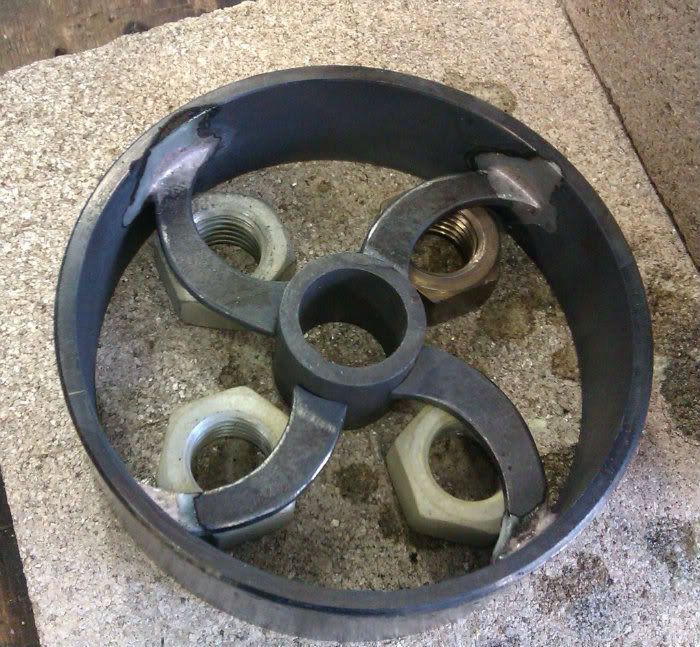

Next up was the pulley that would have taken the drive from the engine upto overhead lineshafting via a flat belt. The photos show a few differences between the original and AM's interpretation such as 4 spokes vs 6, a split clamped hub and a narrower rim.
I started with the hub, a bit of 1" bar was drilled 1/4" and parted off then two shallow 3/8" grooves milled in opposite sides to take a couple of lengths of 3/8" sq bar
The three parts were silver soldered together then drilled for the clamping bolts after which they were cleaned up and all edges rounded off. I subsequently drilled the hub out a bit under finished size so there was less metal to heat up on the next soldering stage.
I drew the pulley out full size on a bit of paper and used that to determine the positions of the various arcs to form the spokes. These were then marked out on some 1/8" sheet and cut & filed to shape, testing against the drawing for fit.
A nice man on e-bay provided some 100mm OD x 4mm wall EWR tube and a suitable length was sawn off, the ends were tidied up overlength on the lathe.
When heating the rim of a flywheel or pully it tends to expand which can make the gap between rim & spoke too large for the solder or pull against the hub and distort the finished item when it cools. I decided to solder in two stages, the first being the spokes to the rim. Each spoke was set on a nut to pack it upto height and an off cut used as a makeshift hub, the spokes were then solderd into place.
A quick clean up of the inner spoke ends and the hub was set in place with a toolmakers clamp to ensure the previously soldered lugs would not move. This way I could heat the hub and not have the rim expand.
And here it is after a dip in the pickle and a light wire brush to remove flux.
Back to the lathe held it by the inside of the rim to bore the hub true and profile the rim to a slight crown. If you look at the lines on the rim you will see it is in 5 sections, the middle is parallel to the lathe axis, the ones either side of that are at 1deg and the outer section at 2deg, these will be blended later into a shallow crown.
And here is the finished pully, you will see that before soldering I added a 1/64th slot 0.040" deep around the middle of the hub to look like a dummy split line.
Just a little work to clean up the solder fillets, coat of paint and then mount on an arbour to blend the rim and thats another part off the list.
