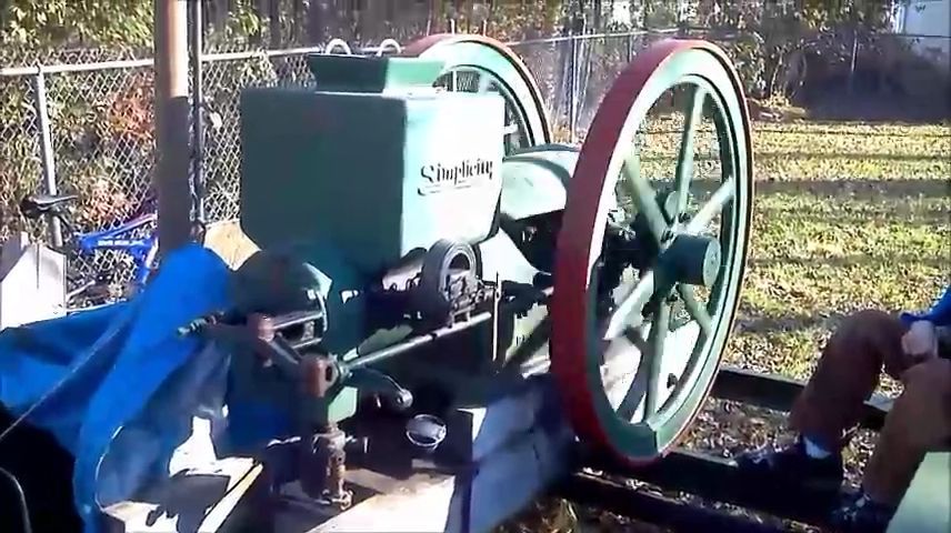

Re: Economy Hit & Miss Engine
« Reply #37 on: February 25, 2017, 03:44:28 PM »
Here it is...as promised.
My 8 HP Simplicity.     42" flywheels with a 16" pulley
6" bore x about 10" stroke.....and yes it runs quite well
http://vid164.photobucket.com/albums/u27/mcandrew1894/Family/Simplicity_zpsce76e166.mp4
« Reply #38 on: February 25, 2017, 03:50:19 PM »
By the way, the 16" pulley,  on the other side from the video, is mounted to the spokes of the flywheel, not the shaft.
There are bosses on the surface of the spokes for the mounting.
The rims of flywheels are hollow and are 1/3 full of fine sand.   This "Auto balances" the engine as the sand distributes itself opposite the side of imbalance.
Cincinnati Milacron precision grinders had a auto wheel balancer with 3 steel balls that floated in oil in a circular race that did the same thing...very clever.
This engine is somewhat rare...I've only seen perhaps 3 or 4 of this size Simplicity.
« Reply #40 on: February 25, 2017, 04:02:44 PM »
It's mounted on a trailer....The engine is mounted on large Oak skids, just like the original ones they were copied from.
2600 pounds.
My dad used this engine in the 30's to cut cord wood and fill silos with a blower.
« Reply #41 on: February 25, 2017, 04:23:14 PM »
So it is a family heirloom as well as being highly desirable  :)
« Reply #42 on: February 25, 2017, 04:25:35 PM »
It's a bit much....stuff this size owns you....not the other way around...
