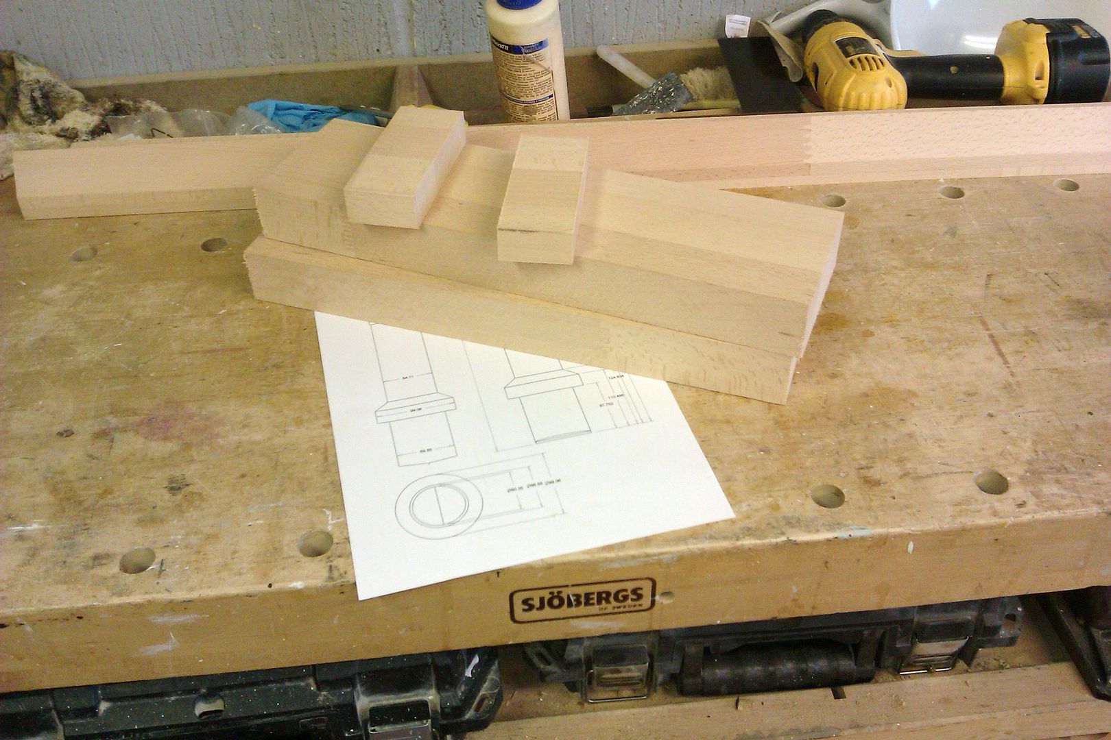

Column Pattern
I modeled a pattern in Alibre in much the same way as I did for the base and then printed off a 2D drawing to work from starting by cutting some basic bits of beech.
The excess material was trimmed off on the bandsaw
I did not glue the wider section as I did not want to risk it not coming apart when the pattern was split into two so left this section uncoated
After which it was clamped up and left to dry. You can see the sheet of paper left in the joint better in this photo than the one for the base.
After knocking off the corners on the bandsaw it was mounted up on the lathe. You may just be able to spot a washer slipped onto the tailstock ctr, this is quite important when working with glued up parts you intend to split as if you don't use a washer the pressure of the ctr while turning can wedge the two halves apart at the wrong moment.
The engineering lathe makes quick work of wood with a fast speed and feed coupled with a sharp CCGY type insert.
After a bit of sanding and filling the two patterns are starting to look more like an engine.
After the first couple of coats of paint and sanding between coats it was time to split the patterns in two. A quick blow to a 1" chisel on the joint line soon had the paper split and then that was sanded off.
With the bandsaw table tilted a couple of degrees draft angle was added to the ends.
