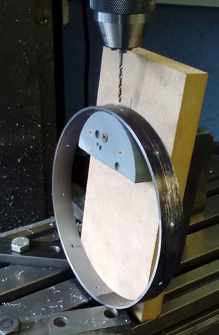

The rear wheels will be 152mm dia which can easily be cut from 6" ERW steel tube, for the fronts I also had some thicker walled 5 1/2"  tube and by machining down the OD could get about 16mm difference in diameters. First job was to saw off a length a bit longer than needed for two rims and turn the 3mm and 5mm wall thicknesses down to give the 2mm thickness that I wanted. This is the smaller 5 1/2" tube having its OD reduced, I have left a section near the chuck full thickness to help keep the tube round as it starts to distort from the pressure from the chuck jaws if you are not careful. The larger rear wheels had the metal removed from the ID
The ring can then be sawn in half and the two wheel rims machined back to the finished 3/4" width.
As the spokes are dished the holes need to be drilled at an angle, rather than faff about setting the rotary table at an angle I used it vertically to put 10 evenly spaced spot drilled dimples around the centre line and then made a simple jig to drill the holes at alternating angles, they then had a shallow CSK added.

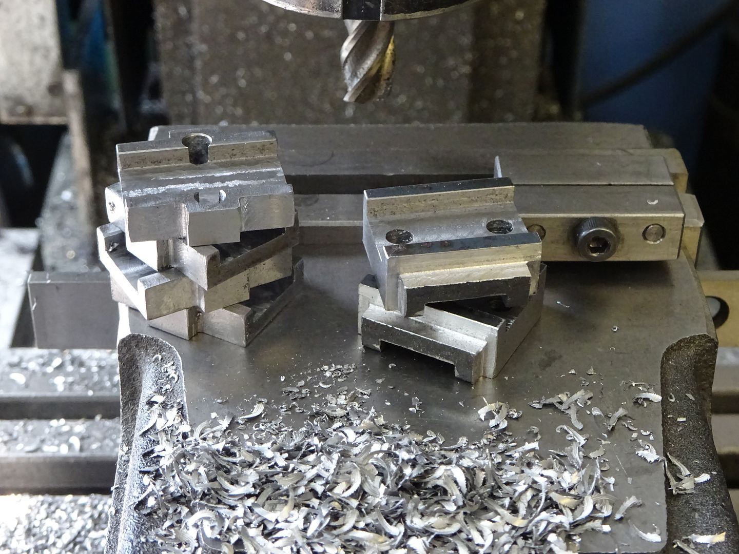

The two axles are quite straightforward being 14" lengths of 1/2" square bar that are turned down to 3/8" dia at each end. From the photo of the original you can see that behind the wheel there is a rounded flange and then a short section of a slightly larger square. I decided to make these as separate parts and JBWeld them into place as they are not stressed parts. While I was at it I turned 4 hubcaps as well.
The rear axle is clamped between two blocks to the rail on each side. The bottom blocks were milled from 1/4" thick stock and the top ones from 3/8" . The mill vice stop comes into it's own on jobs like this where there are several similar parts as you only need to setup for one to first drill them.
Followed by milling to shape, a home ground cutter was used to give a fillet to all the internal corners to give the blocks a cast look.
After knocking off the corners it was time for a test fit with some temporary nuts and screws, the groove at the top will be what the side rails locate into.

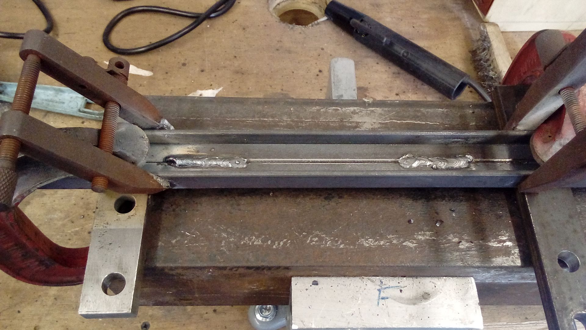

Talking of side rails I had made enquiries about getting some 1" x 1/2" C channel but it is obsolete in the UK and the cost of getting lengths from the US was too high so I decided to make my own. Starting with some 13x13x3mm angle the edges were preped and then welded together. To avoid distortion I tacked three one inch lengths on one side with the angles clamped to a sturdy bit of structural steel.

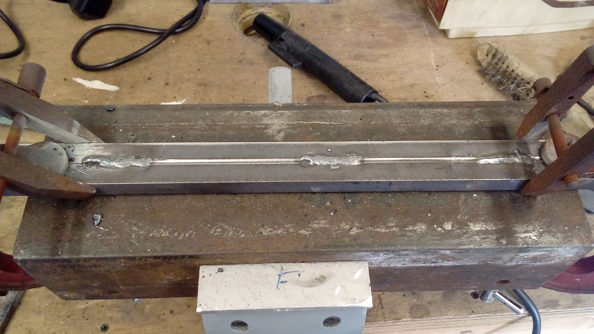

Then flipped it over and did matching tacks on the other side.
This was repeated several times until I had a bead of weld running the whole 25" length on both sides. Following which the welds were cut back with a grinding disc and then a flap disc in the 4.5" angle grinder

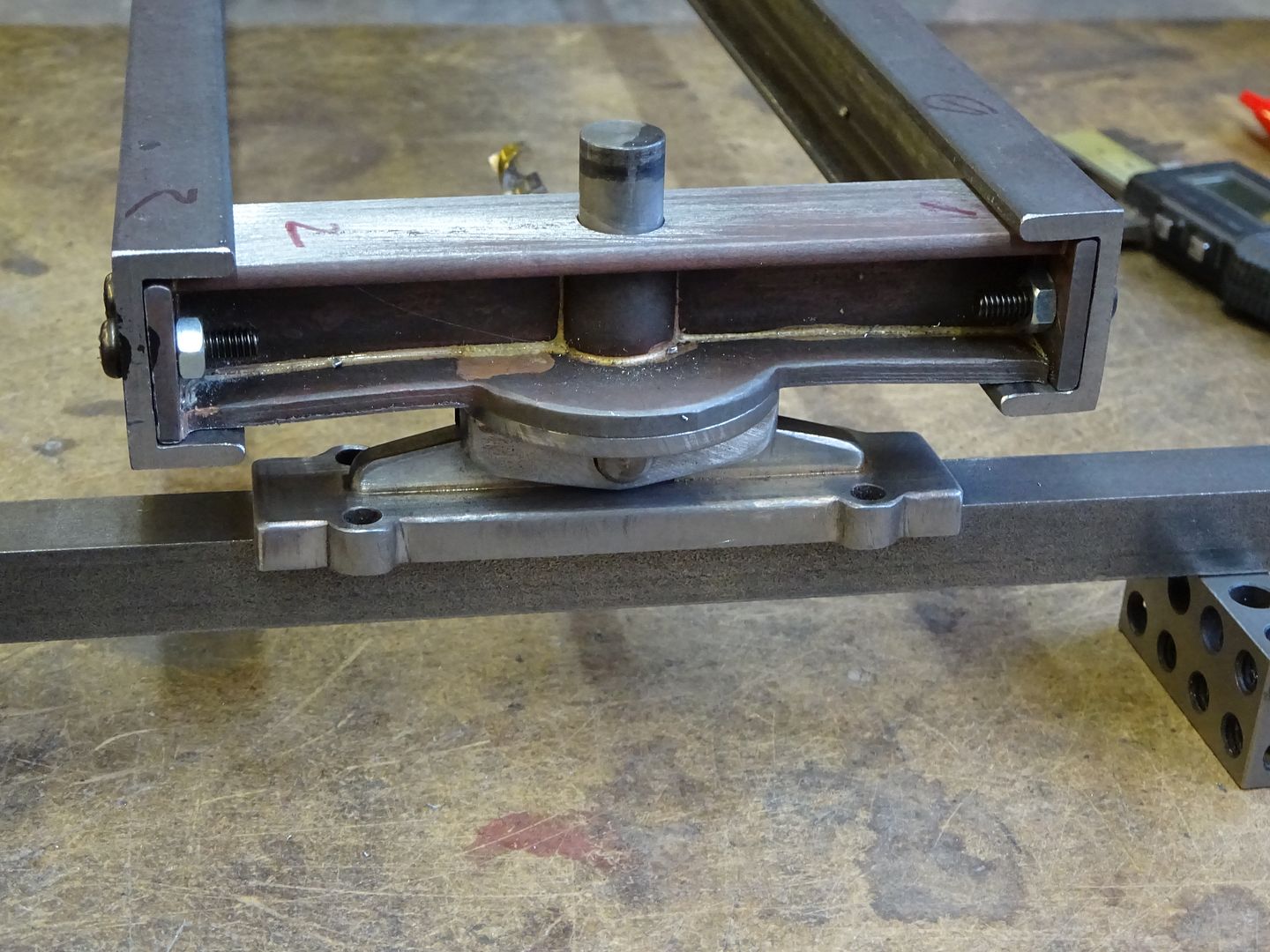

Although a lot of the smaller engine carts don't have an articulating front axle, this cart is styled more on the larger ones so I looked around for some suitable designes and came up with this.
The front axle will have a long top clamp and two small lower clamps the same as the ones on the rear axle.
Some 1/4 x 1" material had a slot milled out of it to fit over the axle, 4 holes drilled and the outside shaped to match the lower clamp plates. I also milled a shallow 5mm wide slot along the top into which I silver soldered an angled plate with a pivot hole.
I did not take a separate photo of the fork but it is a simple turning job with a 1/2" square bar solded to it that is slotted and drilled to take the axle top clamp.
To make the bolster that goes between the two side rails I started with some 3mm thick material and milled it out to leave a circular "turntable" in the middle. The shallow slot is to locate the vertical part of the "I" beam section
It was then just a case of soldering up some plates to complet the I beam, with end plates and a round boss in the middle. Looks like the solder flowed nicely along all the joints.
This is how it will fit within the two rails
