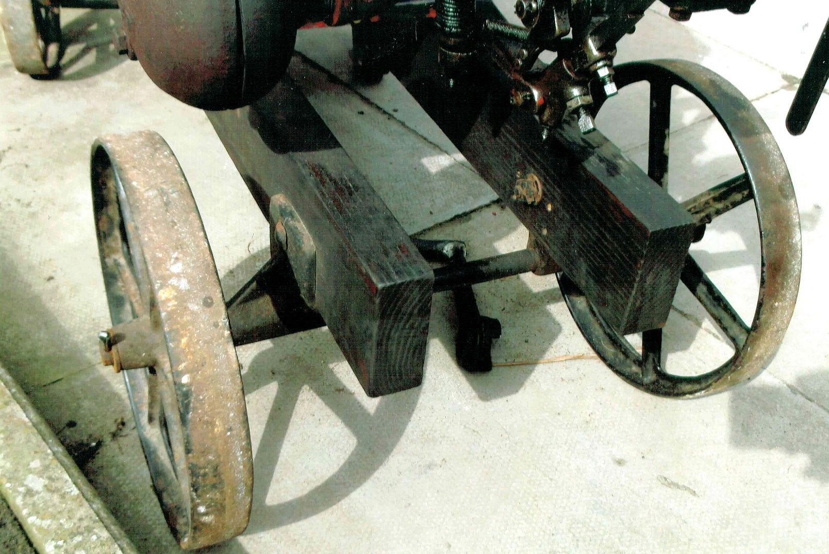

Starting off with the horizontal I was given a couple of photos of the desired type of cart, possibly a bit large for this engine which mostly just came on skids or occasionally a two wheeled barrow type cart at best.  So something was drawn up to suit wheels that could be made from available tube sizes and allow a decent amount of steering lock before the front wheels hit the rails. I also had to incorporate the fuel tank which is housed in the wooden frame.
This pic shows the rear axle brackets on the full size cart.

This is the front bolster that needed to be copied

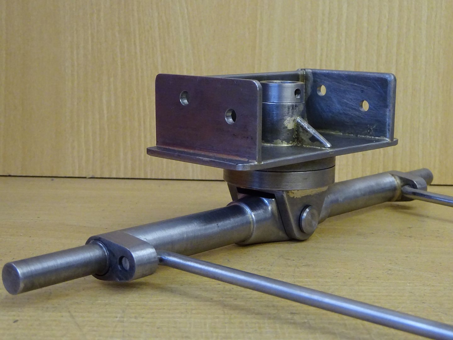

It was made mostly from 1/8" flat bar with locating grooves as before which kept everything square while it was soldered. The pivot fork was turned and milled from some 2" bar, there is a matching 2" disc under the bolster for this to bear against.
I'm affraid I did not take many photos of the axle being made but it is basically a 9/16" rod reduced to 3/8" at each end for the wheels, a short section then reduced to 1/2" which the lobe shaped brackets fit to and a milled and turned central block that was slid along the axle before it was all soldered together. The pivot hole was then drilled through both parts.
The handle was just bent up from 2ft of 3/16" steel bar.
The front end assmbled

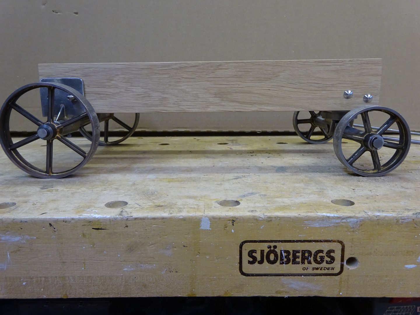

I had based the design of the cart on stock sizes of ERW steel tube that I already had so first job on the wheels was to saw off a couple of rings of each diameter. These were then faced off to 3/4" wide and the wall thickness reduced to 3/32". I would have liked to have gone down  to 2mm thickness but without a 6-jaw chuck the rings would have distorted with the pressure from the jaws.
To save a bit of time and effort I drew out the basic shapes of the spoke discs and e-mailed the files to Lasermasters who sent me back these in 6mm steel which fitted the rims nicely.
First job was to machine some 2mm deep locating recesses and some hub halves to go into them which had a slight taper to represent the draft angle of a cast hub. The centre holes were left undersize at this stage.
It was then just a case of mounting the embrio spoke disc on the rotary table and milling down each side of the spokes to form the "+" section and then thinning down the remaining outer web.
With a bolt through the hub and some packing to raise the rim to half way it was just a case of silver soldering it all together.
After a quick soak in the acid pickle to clean things up the wheels were held in the 3 jaw chuck and the bore opened out to 3/8" which ensures they will run true even if anything moved during soldering.
I also made a few "D" pins to keep the wheels in place, some square nuts and modified the stock heads of some M6 coach bolts to look a bit more scale plus a couple of square headed sets to lock the rear axle and fork retaining collar in place.

One feature of the R&V is that it has the fuel tank housed within the timber frame of the sled/cart. Unfortunately the previous builder had use a larger diameter tube than specified and also of very thick wall which not only would weaken the sled but also weighed a ton.
Not wanting to waste the old tank I cut off the ends, you can see one to the left and then made new ones you can see the new end in the middle and the spare metal to the right.
I also cut off the two bosses and turned away the remaining bits of tank, these bosses were then resoldered into a new length of thin wall brass tube that had the chrome plate sanded off. The knurling on the existing caps is not 100% but it will all be painted to look like it is galvanized so should be OK.
A few bit sof oak were planed up and assembled into a frame and the hardware tried for size.
And a couple of shots with the engine stood in place
