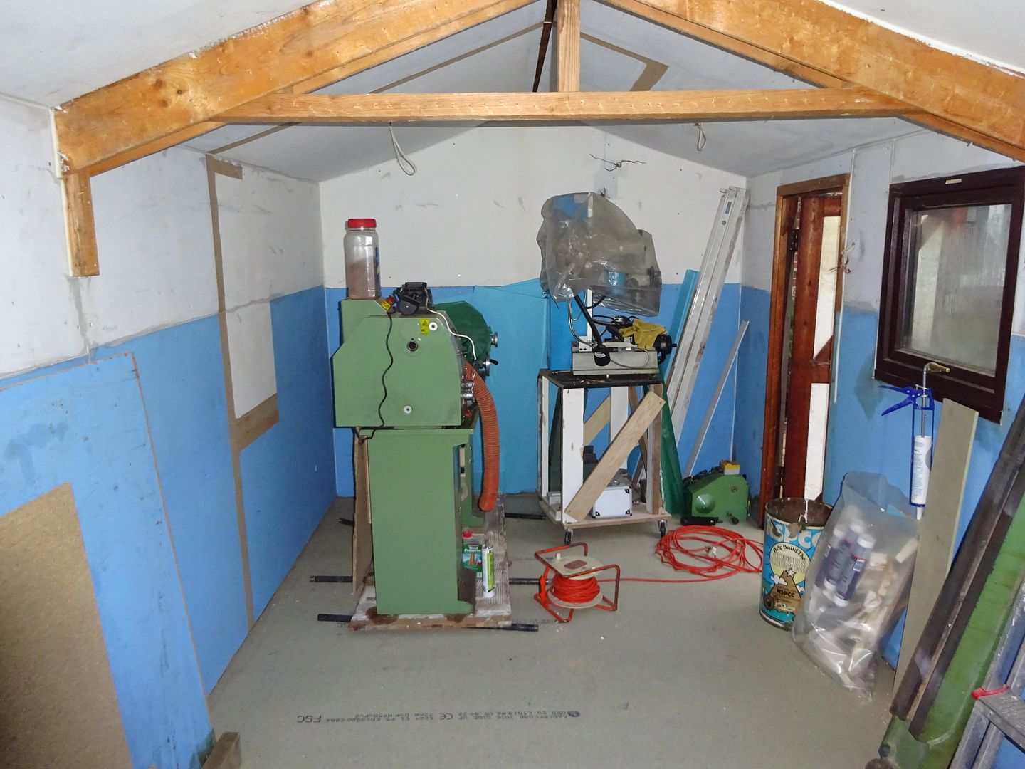

When I rebuilt my workshop I use some lengths of pipe, the type used for Pony pipe clamps, could push the lathe along with one finger. To protect the drive cut an 8x4 in half, lay pipe onto that and drop the mill onto them, roll onto second half of the ply, move first half etc and just work your way up the drive.
