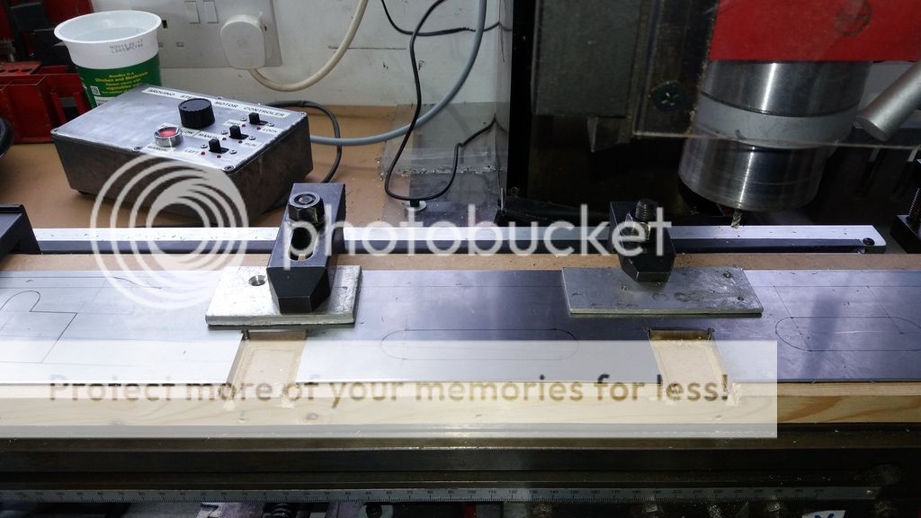

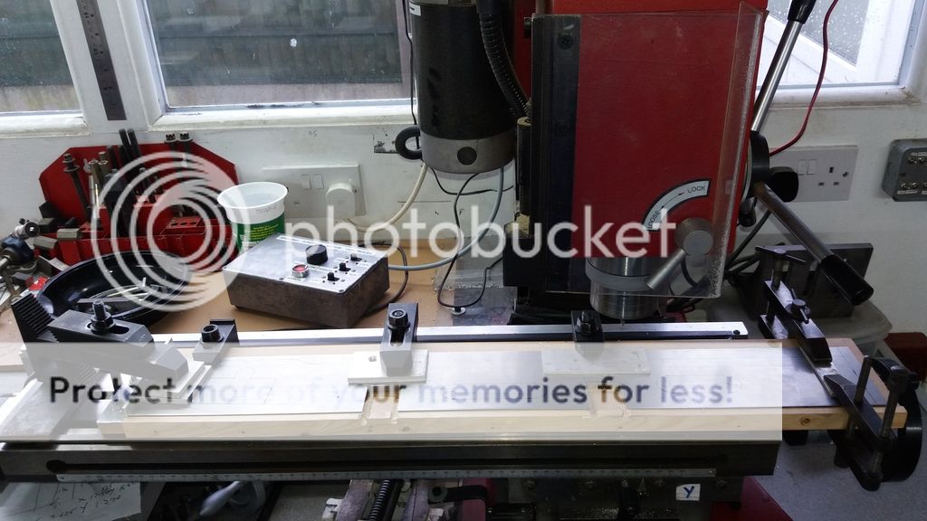

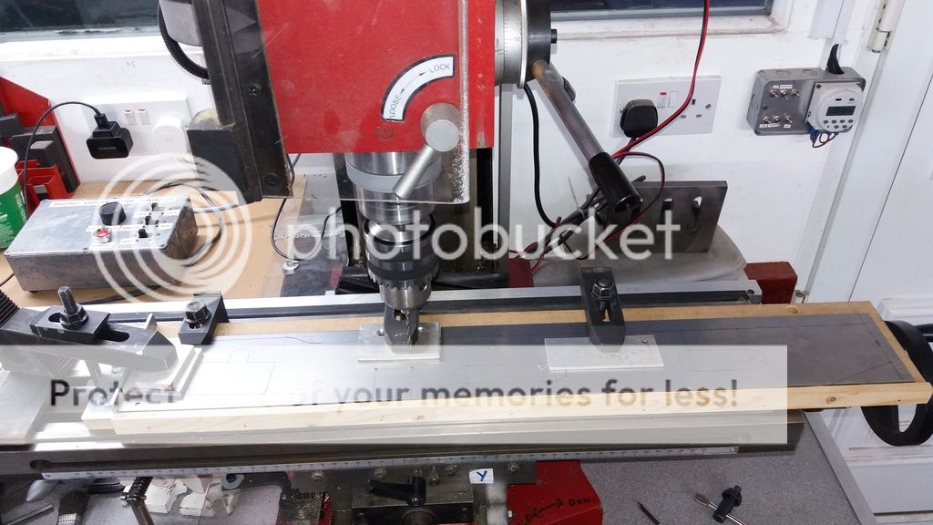

« Reply #48 on: January 21, 2017, 06:02:02 PM »
Hi
A start has been made on the frames. I have made a sacrificial table from 19mm MDF. A length of 8mm square steel is fitted into the slot at the front of the mill table so that the MDF will pull up to it and always go back in the same position. Clamp it down and machine off the left hand end which is now square to the table and fit some aluminium angle.
4 x  10mm holes are drilled along the rear edge in line with the T slot. A length of wood is glued and pinned to the front edge
The 2 frames are clamped down to the MDF table with the front edge against the wood edge and the left hand end up against the aluminium angle. The idea is that if the frames have to be removed I should be able to put them back accurately
Using an edge finder I have located a datum at the front left hand corner. The centre of the front axle is 9" from the front of the frame with the centre of the rear axle a further 8" I just managed to get just under 18" of travel on the mill table so was able to machine the 2 hornblock openings
To machine the rear end of the frames I am going to move the MDF table along about 9"
Rich
