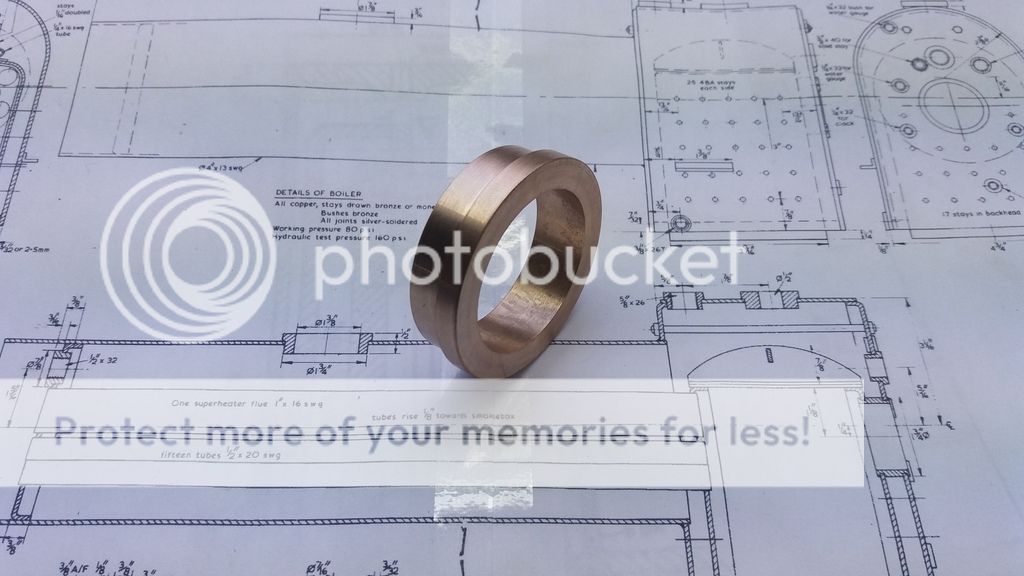

I have to turn a large bush, bore a large hole in the boiler and silver solder it in. This is the part ably shown by my young assistant, my grand daughter who can't wait for this to be finished.
Now I cannot for the life of me see what fits in it.  :wallbang: Surely it has to have some holes tapped in it?
Help
Rich
Re: CONWAY 0-4-0 3 1/2" GAUGE LOCO
« Reply #31 on: January 07, 2017, 02:06:34 PM »
That's under the dome and has a second half which is a "cap" which the regulator fits inside  ;)
You should find somewhere on the drawings the cap and that will show you the holes.

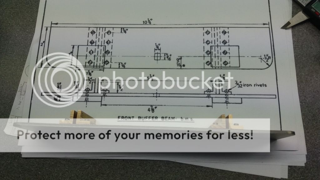

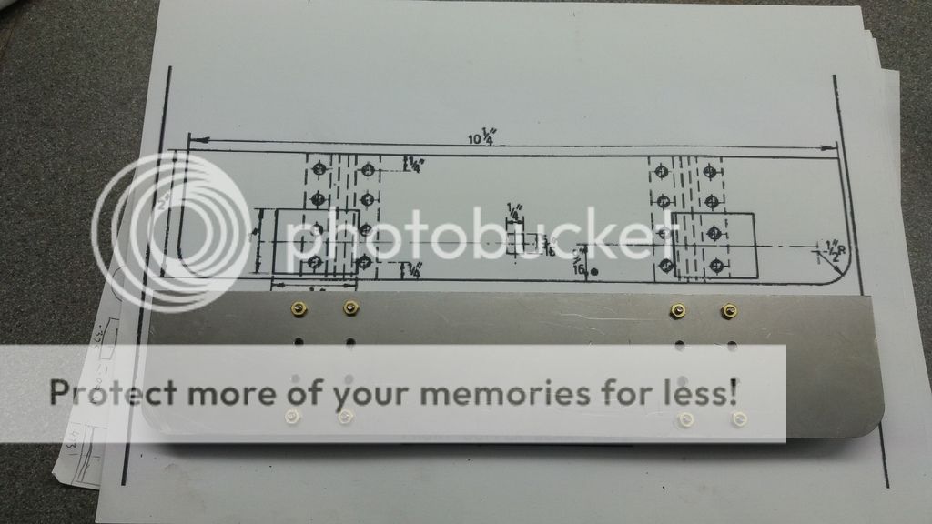

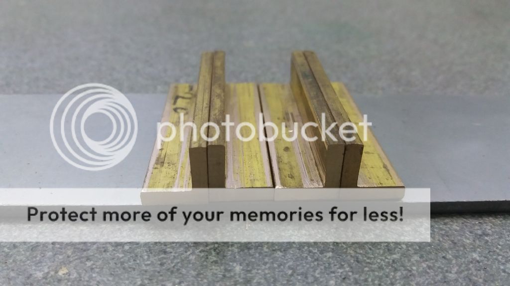

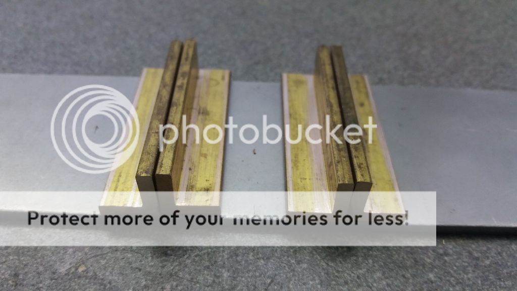

Today I made the front buffer. A nother straight forward job, just follow the plans. A couple of things worth noting though. The brass angle isn't a true 90°. Placed back to back you can see it.
A quick skim over one face cured the problem
The holes have to be accurately drilled, I used the DRO on my mill
Its held together with 2.5mm bolts at the moment. I'm not sure I like the plain dummy buffers so I'll leave them off for now, I might have a go at something more like real buffers

Rich
I don't think extruded angle ever is true. I have some 2" x 2" x 1/8" Ally Angle which is all over the shop ...  ::) varies along the length, not consistent.
At one time it was possible to get milled brass angle, at least in the smaller sizes, a friend used it to make 'leccy rolling stock. The ones you solder up. Quite accurate but far from cheap though ... IIRC it was from Kittle Hobby  (??) but I don't think they do it now. Don't know if the K&S stuff is better. ( If they do it ).

Rich, the regulator is on page 92 of the magazine copy. Does not give number or PCD of fixings but I would think at least 8 fixings. Some people also groove the top of the bush for an O ring.

Last photo, fourth from right at the bottom. It shows the regulator insitu in that bush with the dome on it.
  • Posts: 9493
« Reply #39 on: January 08, 2017, 12:16:33 PM »
You can just see the ring of bolts in this photo, looks more like 12 fixings, previous photo shows that other bush you were asking about in the tubeplate. Don't look at the backhead photos though :o
http://www.stationroadsteam.co.uk/stock%20pages/2671/pages/2671-y.htm

Many thanks Jo and Jason. A picture speaks a 1000 words  :ThumbsUp:
It seems odd that such a complicated part isn't shown as seperate items  :headscratch:

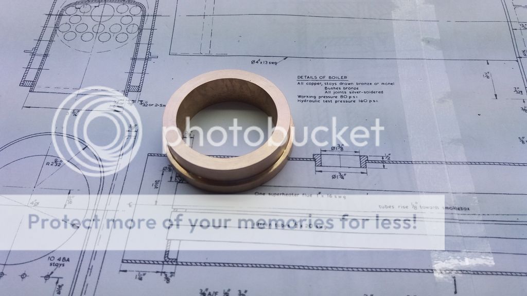

But I can now have a go at the large bronze bush, which in the article there is no reference to drilling and tapping. The drilling and tapping clearly needs to be done before silver soldering into the boiler.
Rich

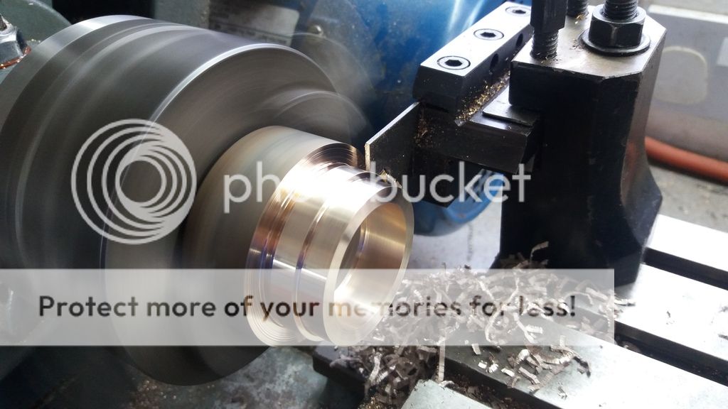

Hi
Turned the bush. I had a suitable bit of PB.
Next job is to mount in the rotary table and drill and tap. 12 fixings looks about right Jason. I'll see if I can get a small groove for an O ring as well

Nice looking bushing Rich. I agree 323.00 of a pair of cylinder castings does seem a bit steep. I don't see  why they couldn't be fabricated.
