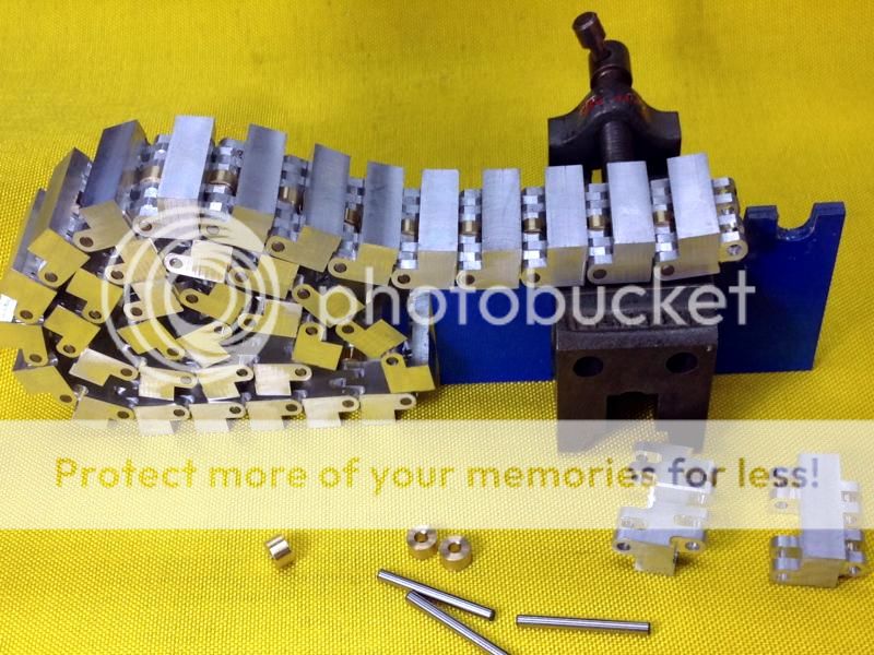

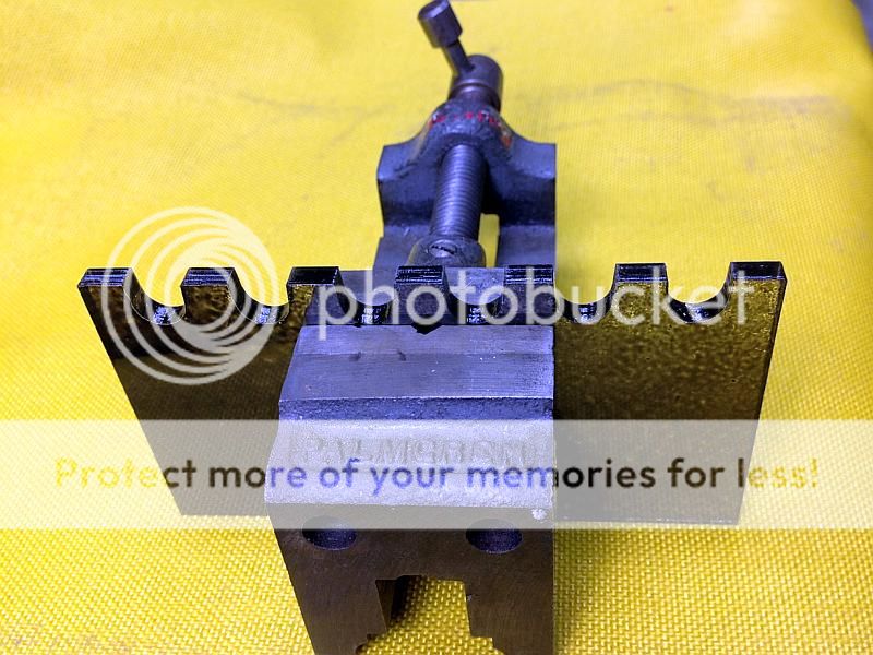

With all the track parts completed it's assembly time.  After holding two plates and a roller in position and inserting the hinge pin it was very clear that I either needed one more hand or an assembly jig.  Jig option won oout.
A piece of 4.5 mm acrylic sheet was cut on the laser engraver with pockets for the rollers.
A length of track is assembled.  The hinge pins are a finger perss fit in the track plates.  Later, after I am sure I don't need to do any modifications, they will be Loctited iin place.  They are firm enough for testing now.
  • Posts: 18716

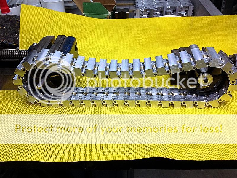

I cut a couple of sprockets on the laser for testig. Mounted them on shafts and clamped the shafts in a pair of vices.
Here is an assembled track ready to start testing.

and to finish out the track segment of the build here is short video of testing in progress.
One of the sprockets shafts was mounted in the lathe.  The other, on the left was mounted in a live chuck that has it's shank in ball bearings.  I normally use it to support long thin spring winding mandrels in the lathe tailstock.  On the first test run the sprocket teeth were "picking" at the rollers when the track was slack.  A quick change to the tooth shape on the sprocket's design and a couple of new test sprockets solved the problem.  I had not designed in quite enough clearancee in the sprocket.
The video just shows the track running, but a lot of tests were done.  First the tension in the the track asl/ adjusted from very loose to who would of thought it. Again with no problems.  The sprockets were offset by 1/4 inch each way and tens/ion tested again.  finally with teh tracks slightly loose pressure was elxerted on the side of the track with a roller to simulate a hard turn.  With no problems noted the track design is considered complete.  I will still wait to secure the hinge pins however as something may show up and I might want to add another plate or two.
