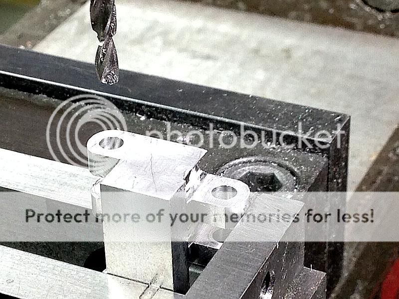

New set up to drill the hinge pin holes.  This operation will finish the track plates except that I later put a bevel of the groove for the sprocket clearance.  I dont think it is really necessary as the sprocket teeth will have a bevel on lthe ends of the teeth, but a little extra insurance that the sprocket will engage the track will not hurt.
The drilling operation is a 3 step process. Four if you count the deburring ooperation that follows.
The parts were set up in the vice withl a single parallel  held against the moving jaw with a spring.  This left a space under the holes with clearance for the drill/reamer to run into.  To teh right is a stop plate that is ground and perpendicular to the vice bed,  The parts are put in the vice and pushed up against the stop with a pusher that is narower than the part and machined ned square on the end and rests on teh parallel. This is to make sure the art is vertical.
All the parts were center drilled.
The next operation was done with an 1/8 dreamer.  As dreamers are not a common tool in most home shops I will explain a little bit.  A dreamen is a combined drill and reamer.  The tip is a drill bit with a length of about 3 hole diameters long.  and a few thou smaller in diameter than the finished hole size. This transitions into a reamer that then finishes the hole to diameter.  You can see the tip of the dreamer in the photo.
The third operation was to open up the holes on the right side of the photo with a 0.127 reamer so there is a free hinging action.
After alol of this the parts were set up as in the previous post and the tabs were all chased with the 1/8 inch end mill at high speed to remove all the burrs left by lthe drilling and reaming operations.  This is quicker than hand deburring for me.
Gail in NM

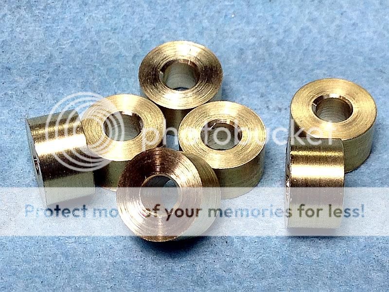

With the trqck plates complete, rollers are necessary to be able to assemble the tracks.  These area simple drill and cut off operation. The rollers are 5/16 (0.312) diameter lx 3/16 (o.187) ling with an easy clearance hole for the 1/8 diameter hinge pin. I used a 3.2mm (0.126 inch) drill for the clearance hole.  The were set up on the CNC lathe and took about 2 hours to run including the setup and programing time. I deburred the hole manually on the manual lathe running a small counter sinking tool in the lathe and holding the part in fingers. I was about able to keep up with the lathe so the parts were ready about 15 minutes after the CNC lathe wias finished.
Gail in NM
