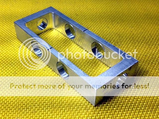

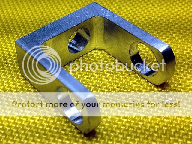

With most of the parts made for the rear axle bevel gear drive it's almost time to tie them together. The main part still needed is the bracket to hold everything in place.
Since I am building parts for two crawlers I need two brackets.  I started out with some 3/8 6061 plate and brought it to width and long enough for both brackets plus some space for  a saw cut between them.While it is still righd I milled out the inside where all the goodies go and drilled and reamed the 1/4 and 5/16 inch holes for the bearings. Notice the engraved line that I put in to indicate where to saw.
After sawing apart I rounded the end where I had saw cut.

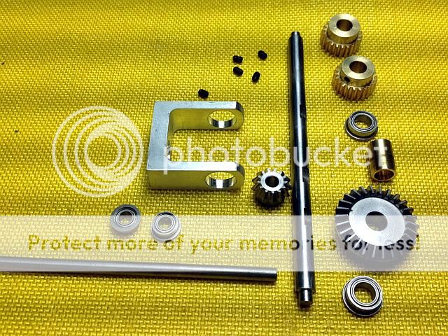

A family photo of all the parts ready for assembly.  The spacer above the 26 tooth gear has not been mentioned. It keeps the far side bearing in place and positions the 26 tooth gear. Also, not shown, is a collar that goes on the 1/ 8 drive shaft to keep the shaft in place and retain the outter bearing for that shaft.  It is a stock I item that I make up in bulk so was on hand. but never fear, my stock is low and I won't have enough to finish this project so I wii be making some more soon. The little fly specks in the upper left corner are 2-56 x 1/8 set screws for the gear hubs.

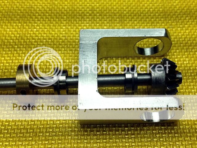

Assembly starts with the pinion, inner bearing, bracket, outer bearing and collar strung like beads on the 1/8 inch drive shaft. Every thing is pressed together with firm finger pressure and tightened up.  The bearings are 1/8  1/4 flanged ball bearings.  They are a kiss fit in the bracket so there is no axial pressure on the inner races of the bearings.
The 3/16 X 5/16 flanged bearings are installed from the inside of the bracket.

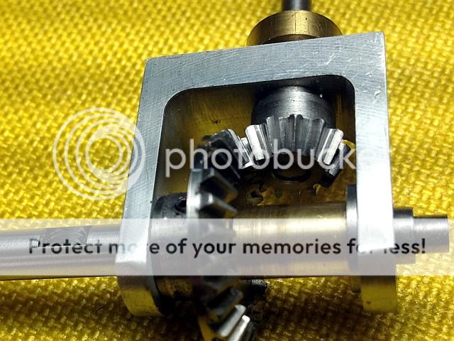

The bevel grar and spacer are positioned between the bearings in mesh with the pinion and the 3/16 shaft run through the whole mess and the gear set screw tightened.
The drive gears for the rear axle assemblies are added and the sub assembly is ready to install in the chassis. Of course I had to play with it for a little while.  Runs smooth as silk with almost no backlash.  (Sigh of relief).

That gear bracket came out great!
