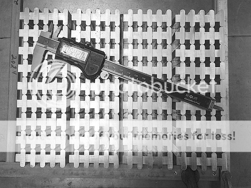

I sawed up about 12 pounds of 1/2 plate. About 1/2 of that is being turned into chips.
The strips were saw cut to the 1.265 length with about 0.05 extra for clean up.  A stop was set up of the band saw and the strips just fed through.  A stop was installed on the mill vise and one end cleaned up on all the parts.  Thenthe other end was cleaned up bringing the parts to the 1.265 length.  One of the flat faces was cleaned up as the extrusion was a bit rough.  I would ha fly cut it if I were doing in on a manual machine, but with CNC I did a climb mill operation around all 4 sides do I did not have any burr to cleanup. Flipping the part over, the corners were notched out to form the pad which contacts the ground and the rest of the top cleaned up to bring the thickness to 0.484.  I thought I had photos of these operations but have lost them.  But we are big boys and girls and have our own favorite ways to clean up a block of metal.
Any way after another 1/2 a dozen hours I ended up with a box or parts that looked like this.

Off to a great start, thats a lot of metal!  How big is the finished model going to be?

Chris: Sorry I missed your question about the size of the model.  As currently drawn it will be 6-5/8 inches wide by just under 12 inches long.  But, as mentioned earlier, I can stretch it out in 5/16 increments by adding links.  The chassis can also grow if I stretch it beyond the length of the tracks.
