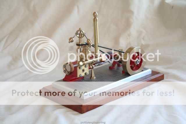

I hope Arnold doesn't mind but I thought I'd post a pic of my finished engine.
Stew

Love the photos Arnold, your engine is starting to take shape and now has me more interested in seeing it through. I had forgot about Stew engine built. This is one engine I do want to build for sure.
