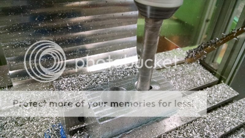

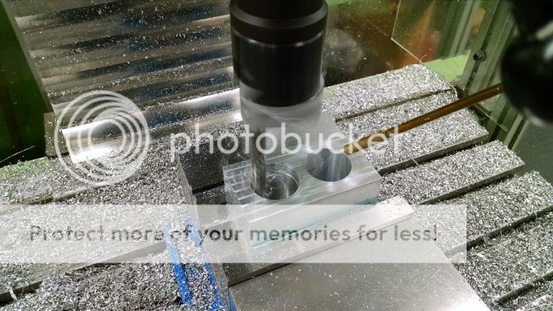

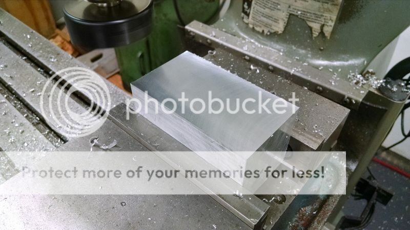

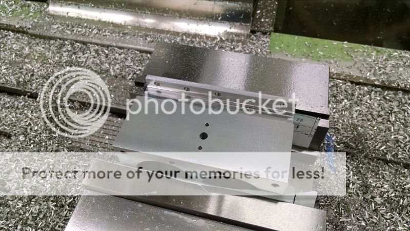

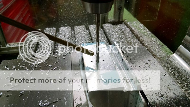

The next part I’ll be making is what I call the cylinder block. The challenge on this part will be the O-Ring groove and the cavity for the liquid cooling. The first picture is a sectioned rendering to illustrate how the finished part should look.
I started with squaring the block on 5 sides on the Bridgeport.

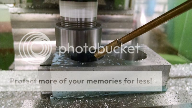

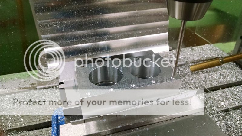

I then moved the work over to the CNC mill where the top side was faced over and two holes for the bores were pre-drilled. To rough out the two bores I used a long end mill and a helical interpolation. This is by no means the most efficient way when it comes to metal removal rate but it works very well with the long end mill. Another benefit is that it will produce the right size bore so it’s not going to take many passes with the boring head to get it to size.
And bored out to finish size using a boring head.

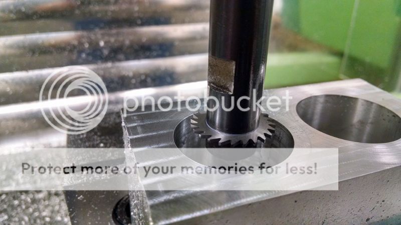

For the O-Ring groove I used a small slitting saw. The saw is 1 x 0.043”
The groove is quite deep down in the bore making it a bit nerve wracking as it’s impossible to see the cut. It’s one of those “let’s hope the code is right” moments…

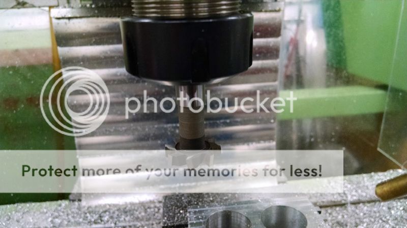

To relief the block for the coolant I used a T-slot cutter.
The next operation was to mill a step to seat the sleeve.

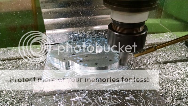

The last operation on the top of the block was to drill the holes for the cylinder head and coolant passages.
To top side finished:

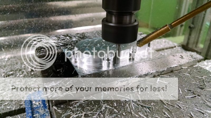

The bottom “flange” is milled.
And the passage for the coolant inlet is drilled.
Last, the step on the sides were milled. This is a cosmetic feature as I needed a bit more length on the cylinder head but didn't want to lengthen the crankcase.

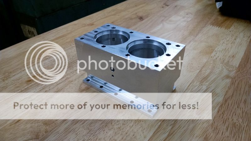

The finished cylinder block.

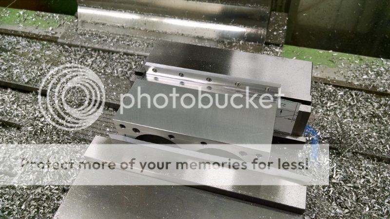

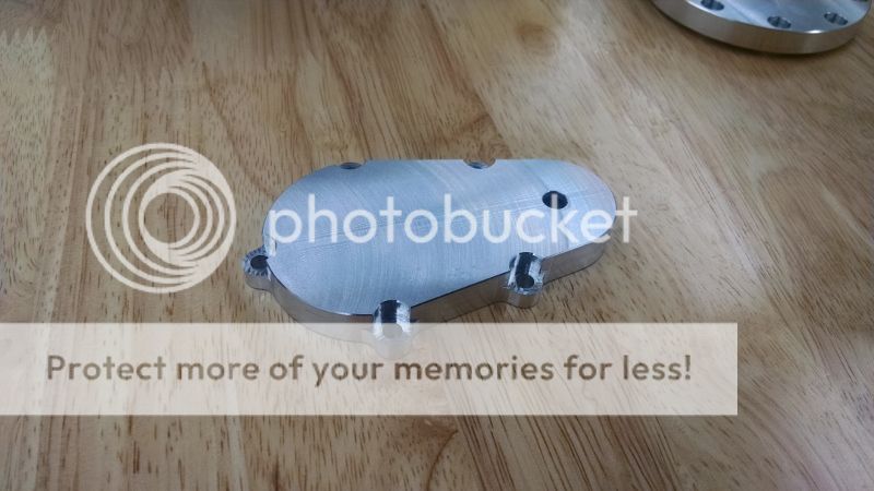

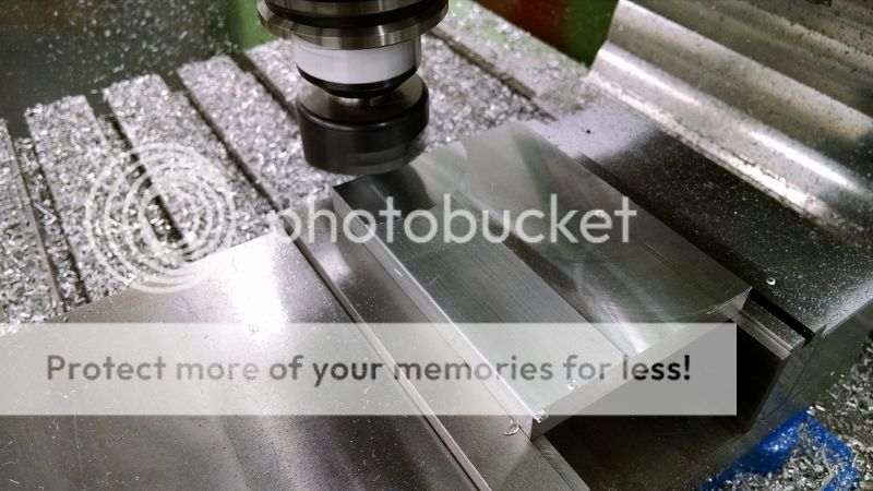

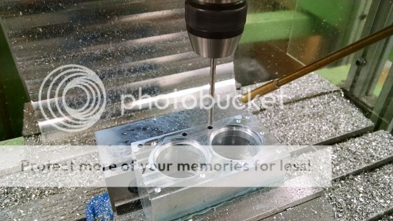

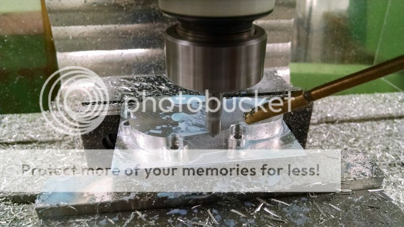

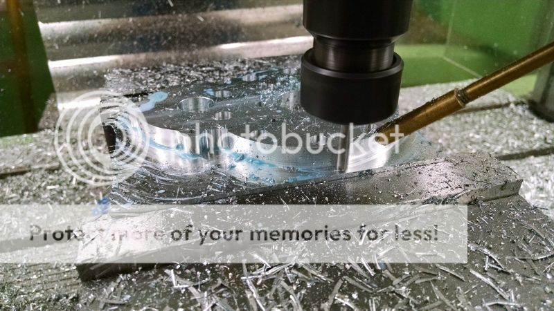

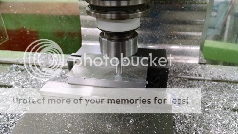

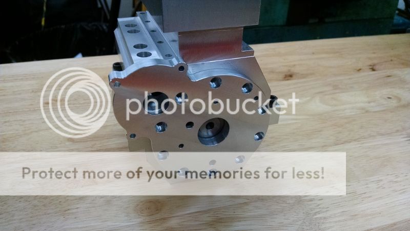

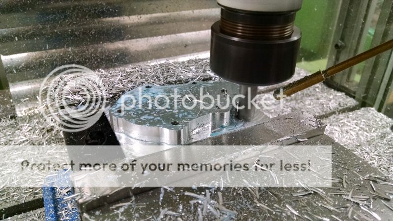

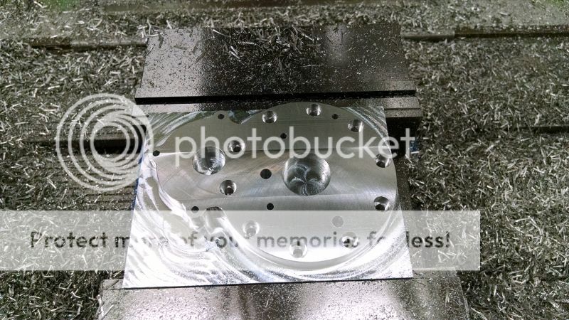

The next part for the engine will be the covers to finish the crankcase. I’ll let the pictures do the talking rather than me trying to explain the steps, so please feel free to ask any questions if I leave anything out.

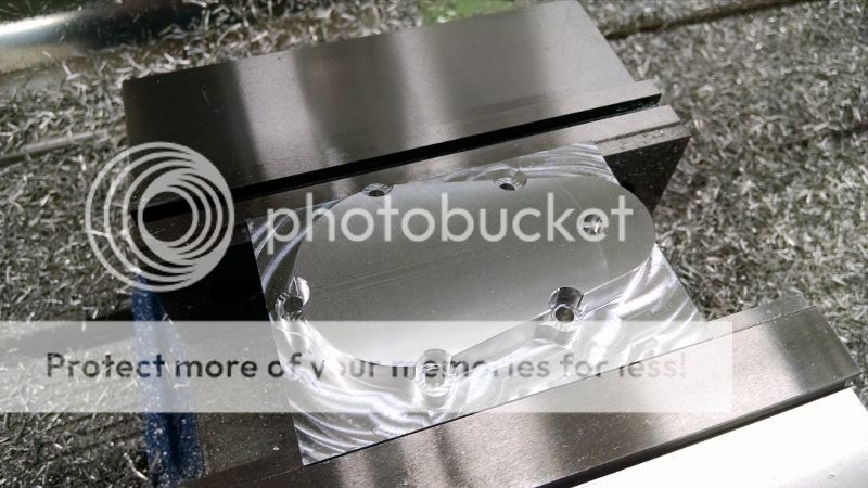

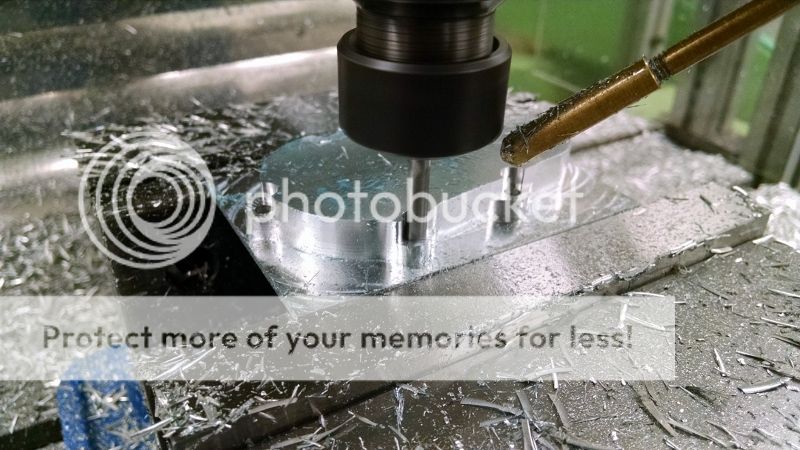

The front cover (accessory end) is milled on the CNC mill.
First, face milling the top:

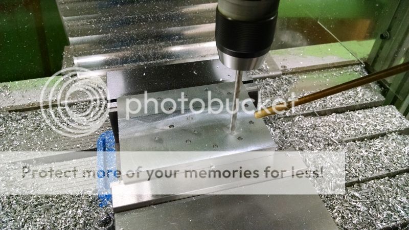

Spotting and drilling the hole pattern:

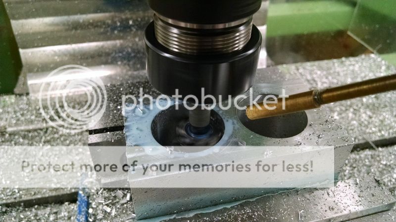

Roughing the contour:
Milling the counter bores:
Finishing pass:
And an edge break around the contour with the spot drill:
First side finished:

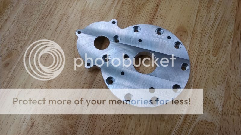

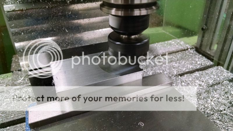

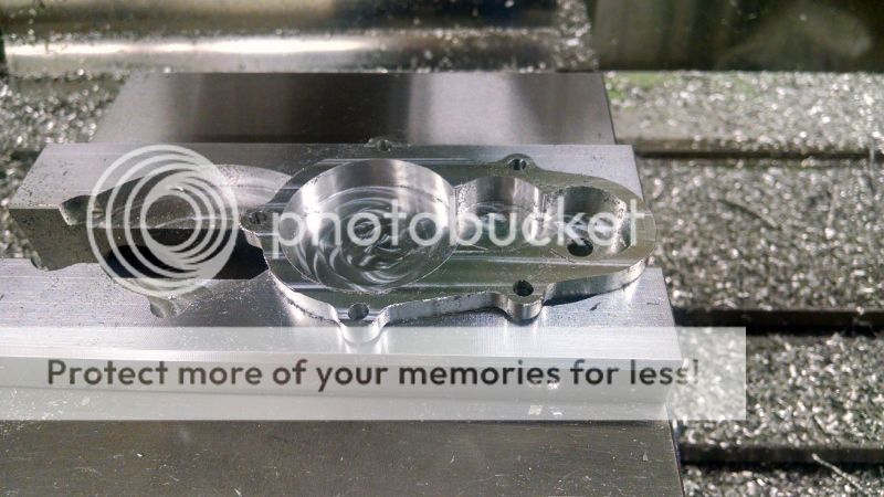

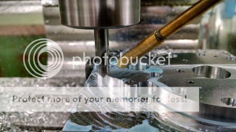

I decided to make the gear cover as well, as I can use the same tools and similar set ups.
Again, first step was a face cut:

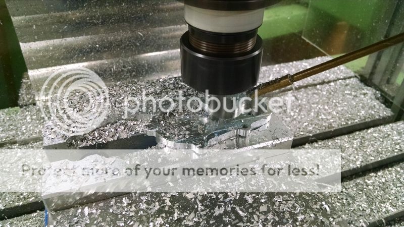

Spotting and drilling:
Roughing:
Milling the relief for the screw heads:
Finishing pass:
Edge break:

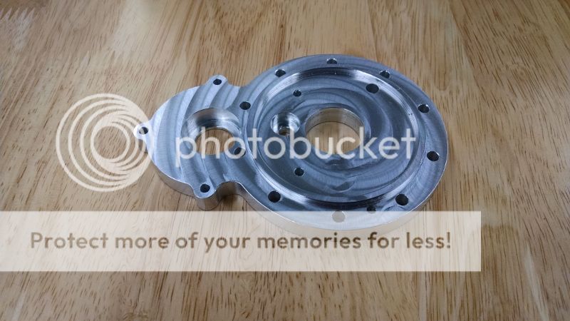

First side of the gear cover done:

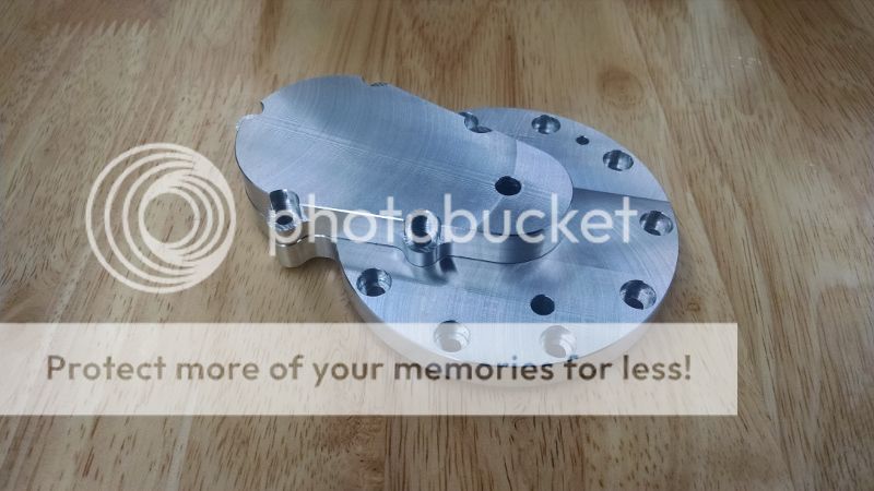

A set of machinable soft jaws were installed in the vise and milled out for the second side operation.
Second side of the cover finished, still in the vise:
Another pocket in the soft jaws was milled out to finish the second side of the gear cover.
The finished parts:
