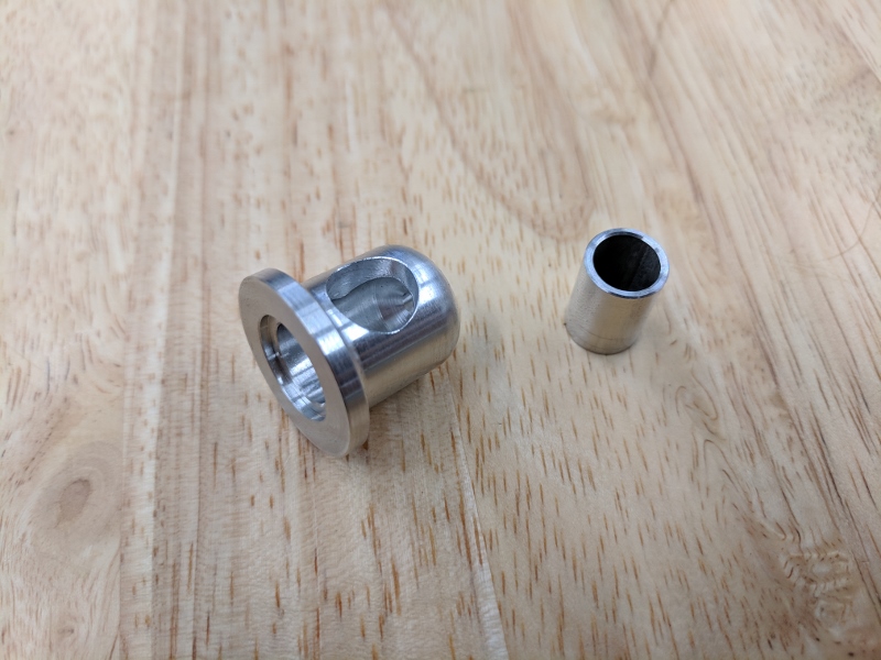

To make the connection from the coolant outlet passage on the cylinder head to a radiator hose, I needed to make a fitting. I took the inspiration for this fitting from a thermostat housing.
The fitting is made of two parts:
To assemble the two parts, slight press fit and some JB Weld for good measure.

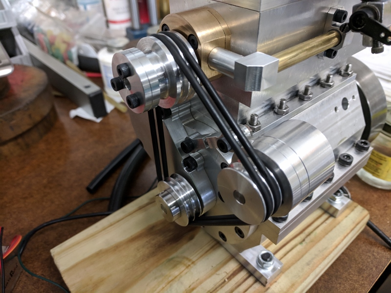

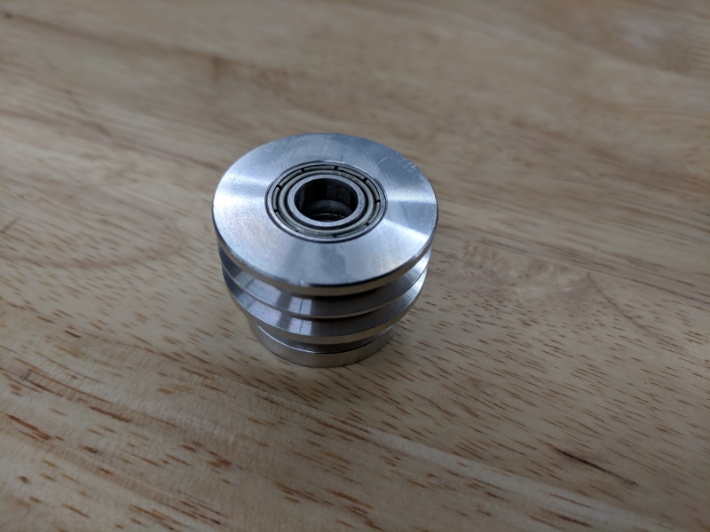

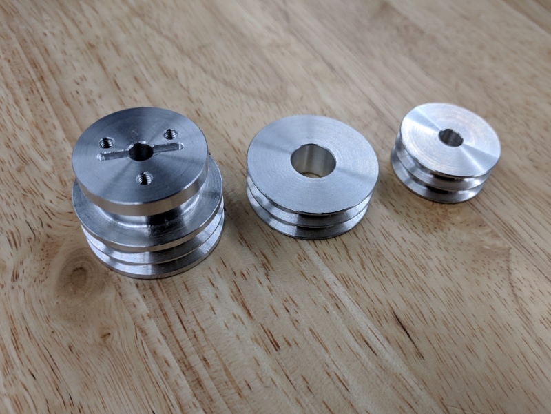

The next set of parts I made were the pulleys to drive the pump. I'll be using two O-Rings as drive belts.
The bearings installed in the pump pulley.
The pulley installed on the pump:

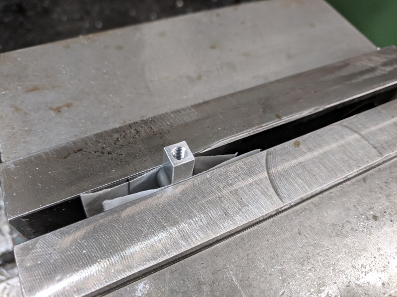

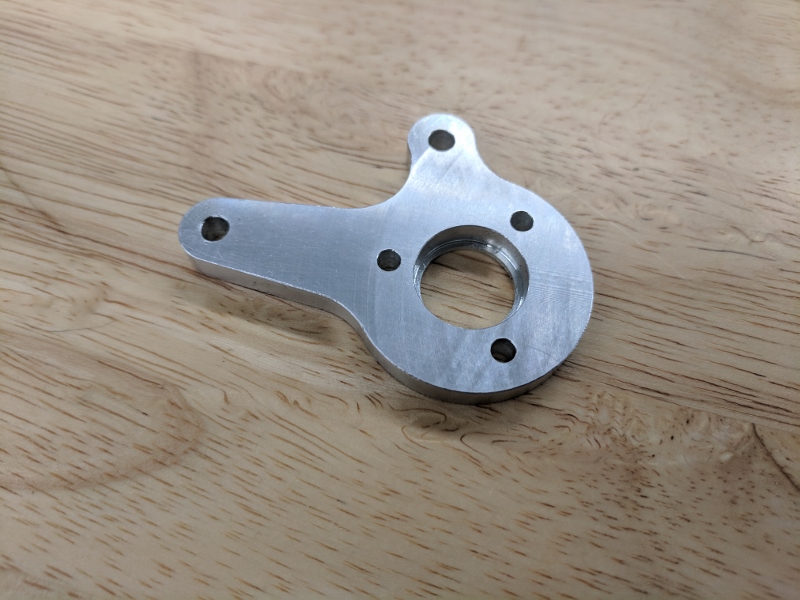

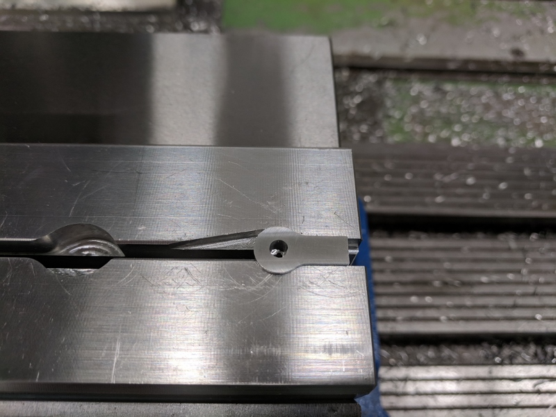

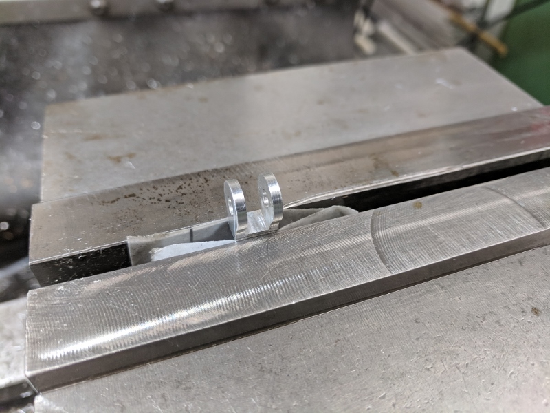

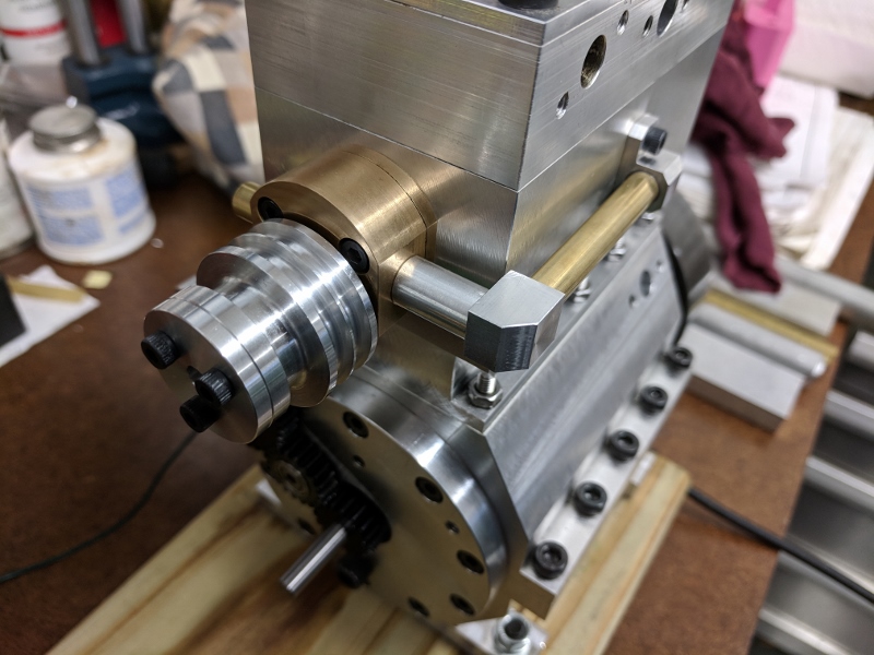

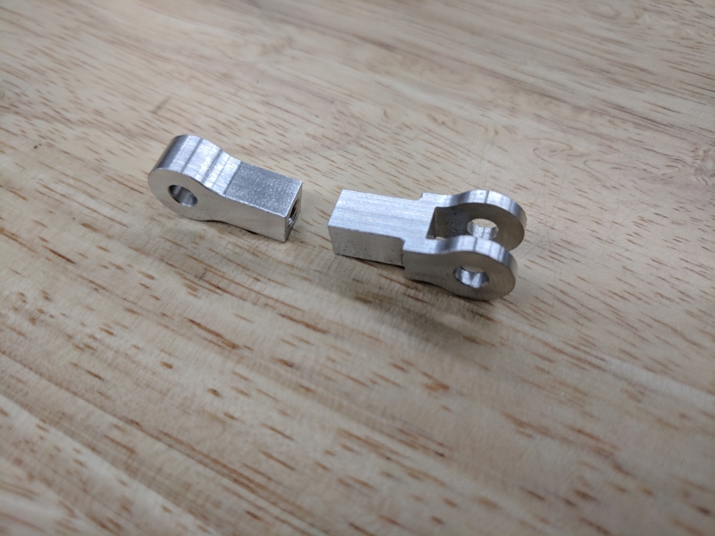

To have a way to tension the O-ring belts, I decided to build a dummy alternator.

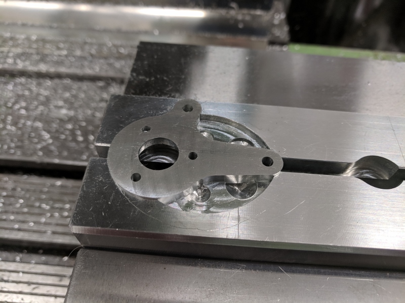

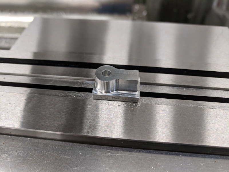

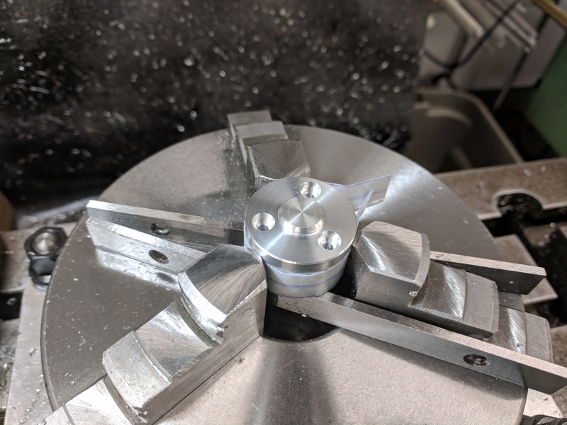

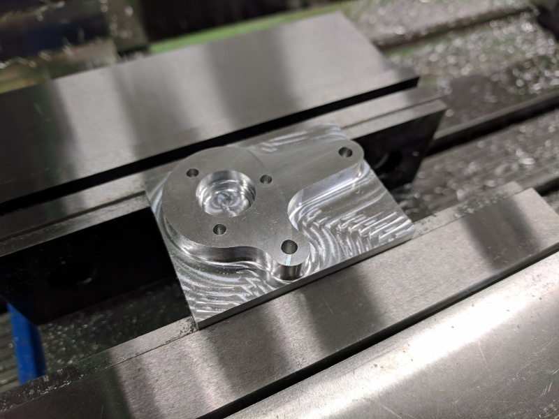

For the alternator bracket and tensioner parts, which are somewhat odd shaped, the first side is machined. Then a set of machinable jaws are installed in the vise to machine off the holding stock and finish the second side.
Second side in the soft jaws:
The tensioner parts are tapped, and the slot is milled for the fork.

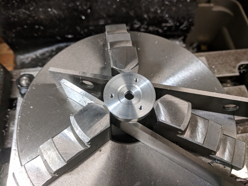

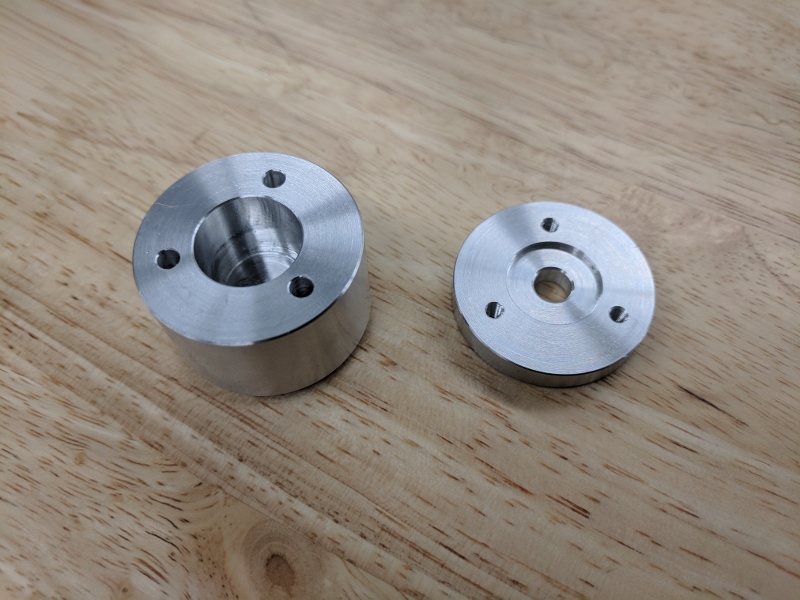

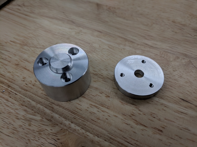

The alternator housing and end bell are finish machined:

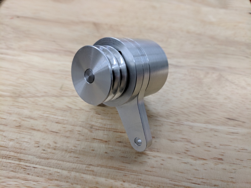

Here the finished parts:
and the assembled alternator:
installed on the engine:
Thanks for following along, and stay tuned.
Yogi

The "thermostat" housing looks great, clean & elegant. The alternator bracket looks good as well. I assume you need to remove an end to tighten it? Or did you complicate it by left handed threads on one end and wrench flats in the middle. Everything looks great glad to see you back at it.

Art, yes, I have to remove one side to adjust the tensioner. I certainly contemplated a right/left hand thread like a turnbuckle, but decided against it for simplicity sake.
