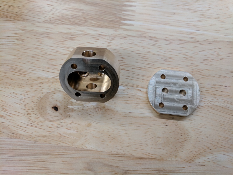

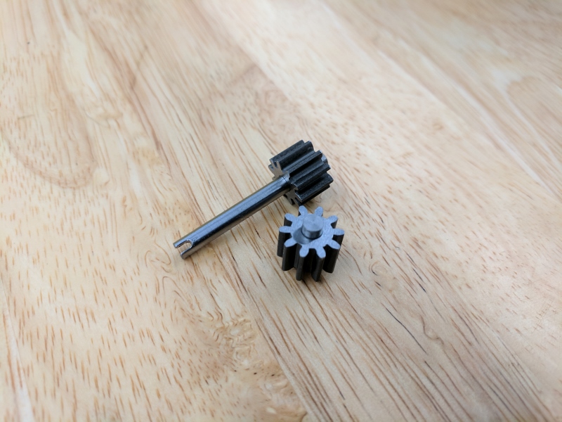

Progress on the engine has been painfully slow, but I finally have some parts to share.  :atcomputer:
Next, I'll be working on the cooling system, staring with the pump.

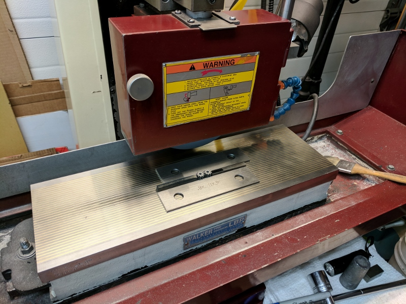

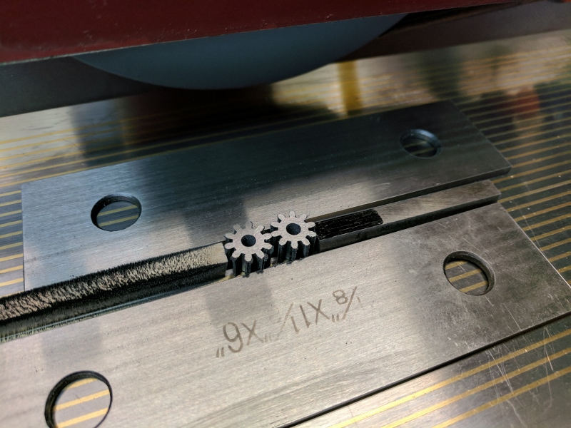

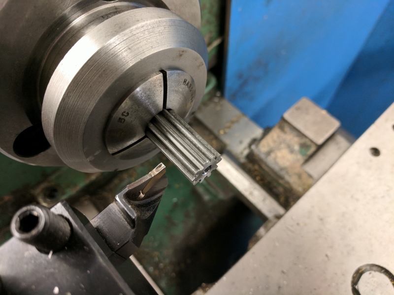

I started with some gear stock, parting off two blanks.
To ensure both gears are exactly the same width and flat, Brian (toolznthings) helped me out with his surface grinder.
The finished gears, with the shaft installed.

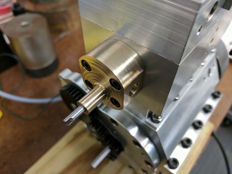

The pump housing is milled from bronze.

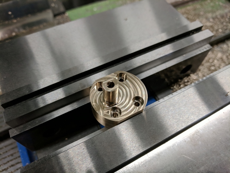

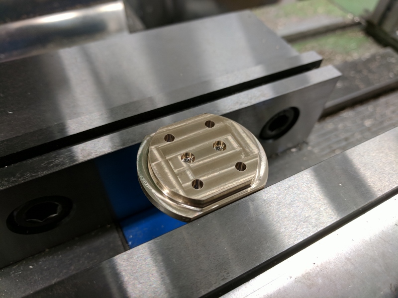

... so is the rear cover...
The finished pump housing parts:
With the gears installed.
And the pump installed on the engine.
Thanks for following a long and stay tuned for more...
Yogi

toolznthings
Re: Freelance Inline Twin
« Reply #174 on: March 30, 2018, 10:18:36 PM »
Thanks for the honorable mention ! It's about time you got something done !  :stickpoke:
Pump came out super nice !

Yogi,
Great project and nice looking pump. What type of shaft seal are you using in the pump?
Jeff

Thank you everyone for the kind comments! It's very much appreciated.  :cheers:
Art, the jury is still out on the radiator design. I'm contemplating either a built up bar stock radiator inspired by Jerry Howell's design, or a PC cooler radiator. Right now I'm leaning towards the PC radiator. Stay tuned, I guess...  ;)
Jeff, I'll use a O-ring for the shaft seal in the pump.
Yogi

Hi Yogi,
What is the diametral pitch of your pump gears and what size shaft did you use?
Also, how did you cut the blind holes in the pump body.  I'm guessing you plunge cut them with an end mill?
Thanks.
