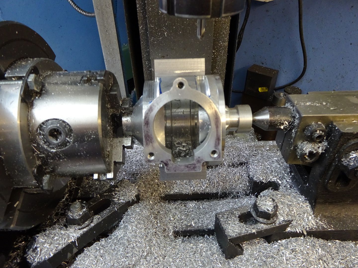

  • Posts: 9489
Re: Recreating a Stuart Lightweight
« Reply #29 on: October 29, 2016, 07:03:34 PM »
When the swarf was cleared away I could see that the lump of ali was starting to look more like an engine crankcase
With the part held in the vice mounted ontop of the rotary table the cylinder mounting flange had some shape added to it.
The rotary table was then mounted vertically and the 3-jaw chucks jaws expanded inside the crankcase opening to hold it. I also turned up a plug to fit the bearing hole so that the R/T tailstock could be used for added support then the case was roughed out to shape.
And then another pass to bring it down to final size.
Then using a ball nose cutter some more excess material was removed.
The R/T was then mounted horizontally again and a start made on machining the stiffening webs at the rear of the crankcase
The top half was a bit trickier as there is a rounded bulge that follows the line of the cylinder liner cutout, not easily seen in this shot but better in the second where I have hade a start at blending some of teh machined surfaces with a carbide burr
I was then just a lot of time with the Dremel and files to refine the shapes. Luckily as the stuart castings are quite textured there was not as much work as there would be doing a diecast crankcase that would be left in bare metal. Here it is with some etch primer.
Thats the crankcase out the way for now while I decide on a nice subtle colour to paint it. Next time I'll see what is hiding inside this piece of EN8 Steel.

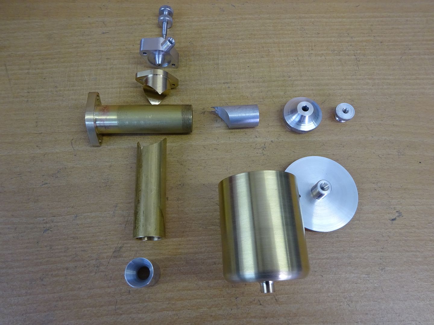

The float chamber and vertical pipe are joined by an angled piece of brass which is a bit tricky to machine as it does not run on the same centre line as either of the other parts.
A 1/16" pilot hole was drilled through some 5/16" brass which was then held at the correct angle in an ER32 block, the centre found and the DRO used to give the correct offset for the float chamber and a boring head used to do the cope cut to match the 1.5" float chamber diameter.
To ensure the work did not twist out of line when the other end was cut I used this method to change the grip of the work by tightening the 5C block before loosening the ER block the part stays indexed to the edge of the blocks.
The 5/8" cope cut was then made with a similar sized milling cutter using a few plunge cuts.
Here are all the carb parts prior to soldering, there is also a web cut from 1/8" flat to brace the joint between float/diagonal and vertical parts as well as a small boss for the mixture needle to screw into.
And here they all are soldered together. I passed a bit of studding down through the vertical parts with a nut and washer on top and packing below to hold those parts together, the boss on the bottom of the float chamber sits in another hole and you may just be able to make out a slotted screw holding the needle boss in place - I ctr drilled this prior to soldering so it was easy to locate and drill out later. Block of metal at the bottom and the packers were given a good coat of Tipex correction fluid so they did not get soldered too.
Thats the last construction photo I took but there was some minor machining of the assembled carb and a sight glass for the oil feed added too.
So time for a coat of paint in a nice subtle shade ;)
