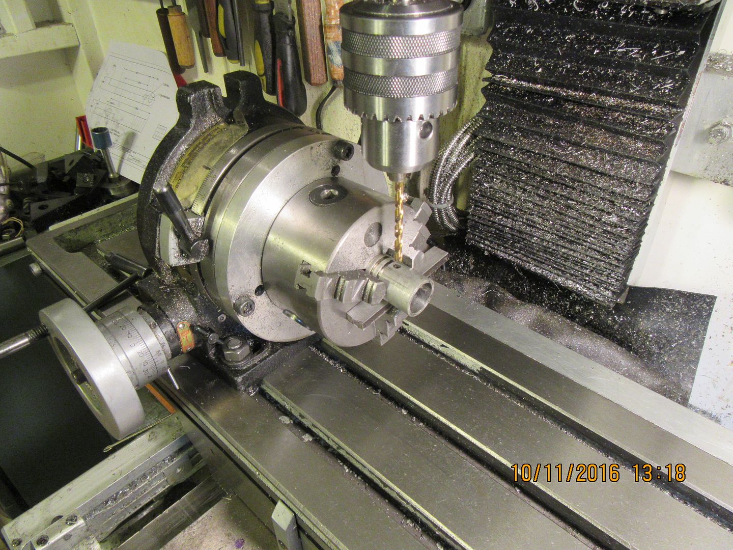

The next parts were the pistons. Elmer shows them made in one turning but I decided to fabricate them. I started the piston by drilling and reaming the hole for the piston rod.
Then I turned the oil groves and took the outer dimension to size.
Then the piston rod was turned to fit the piston.
Then the piston rod was placed in a collet block and the flat was milled and drilled for the crank pin.
The piston rods and pistons were set to length and locktited
together. Next up was the crank disks. The stock was drilled and reamed on the lathe and then placed in a collet block on the mill. I used the coaxial indicator to center the stock and then offset and drilled the crank pin holes.
The disks were parted off and then drilled and tapped for setscrews.
The crank pins were locktited in and those parts were done.  I then made the axel. The bar was placed in a collet block and then the required flats were milled into it.
That leaves us with this.
