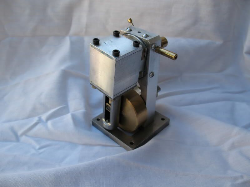

Here are a couple of pictures of my version of this engine...

Marv, thanks for the photos and for alerting me to the plans for this engine.  It should be a fun build.

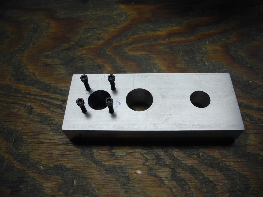

I worked on the column this past week.  It doesn’t require any tricky stuff, but there are lots of holes, some meeting other drilled holes, some blind.  It took some study on my part to figure out how all the passageways connected up.  My only disappointment in the plans is that the ports are not dimensioned.  They can only be drilled using the prescribed drilling jig.  I know that is common practice for some but I’m not a fan of them.  But I bit the bullet and used the one prescribed to do the job.  No other nasty stuff except a 1/16” x 1.15” deep oil hole that was put in at the end.  I really did not want to snap that drill bit off in the hole.  Patience and lots of chip clearing got the job done.
Here’s a picture story:
Starting with the face of a newly milled piece of aluminum 1.00” thick x 2.5” wide by 6.4” long.  The face that mates with the cylinder was fly cut.  Here I’m boring a countersink for the pivot pin bearing.  The other holes are bored or drilled for the crankshaft bearing and cosmetic appearance.
Next, 4 holes are drilled/tapped 8-32 for the crankshaft bearing.
