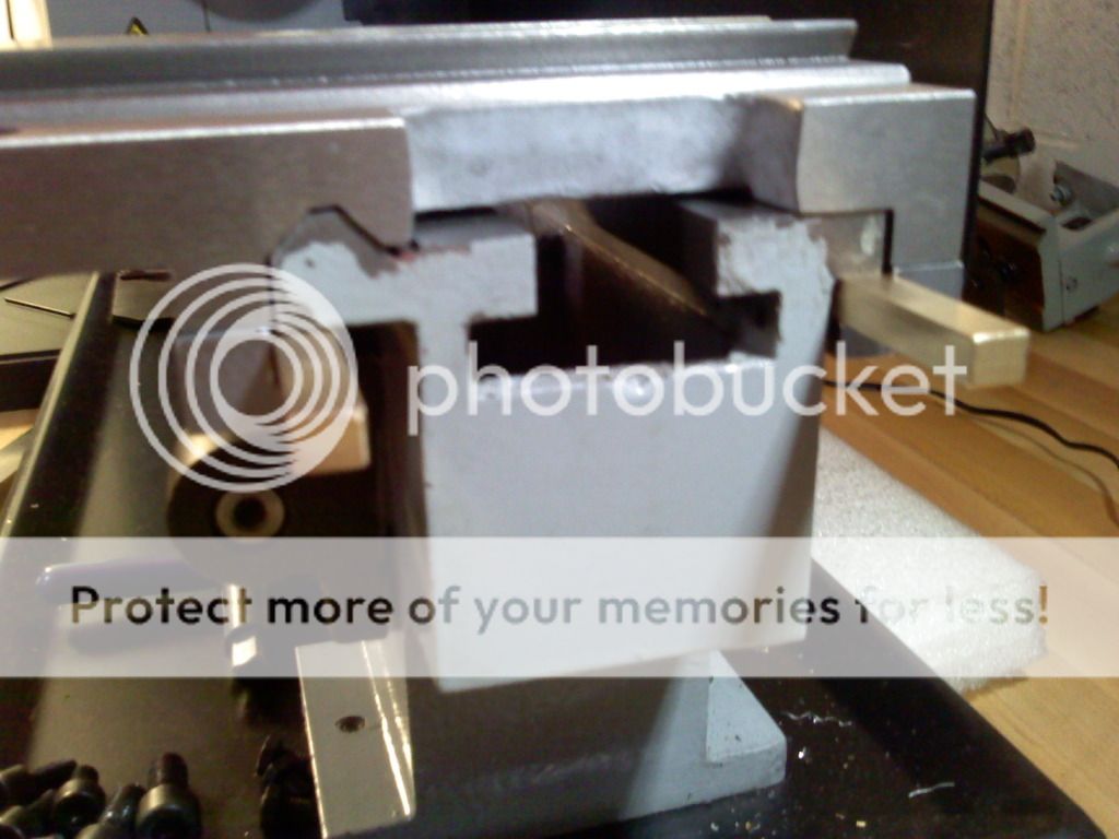

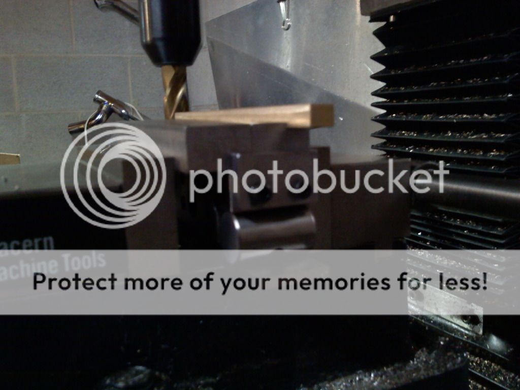

This is where I'm at today with my tapered Gib mod to my 7x16 lathe. I have the Gib bracket on a sine bar with a .070 space block on top of a parallel. Sine bar is 4". I didn't want to make a tapered jig and waste what little metal I have. I made the actual Gib out of a piece of bronze since that's what my buddy gave me and said would last longer than brass. I made them to .250"x.300"x 5". I haven't cut the taper on them yet. My question is how deep do you make the angle on the Gib bracket?? Right now if I lay the bronze on the bracket I have .015" left sticking up above the bracket. Then how deep a cut into the bronze? Or did I cut tooo deep already ? I can make more brackets...just don't have any more bronze !!

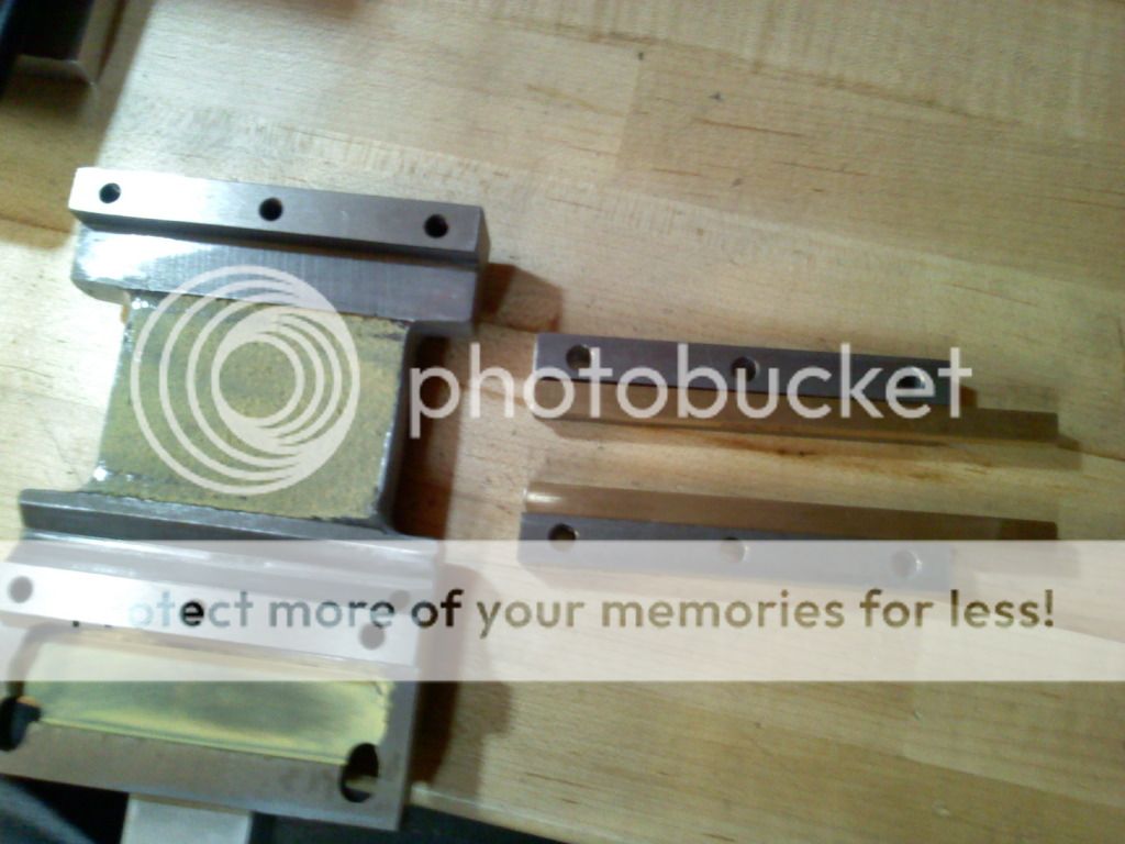

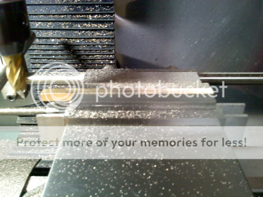

I decided just to go ahead and machine the gib down to the bracket. Heres a pic. I'm now having to mill the taper deeper on the bracket since there was about a .032 gap left. I took it down .034 and now it fits very nice. Back to the dungen to finish the back one.

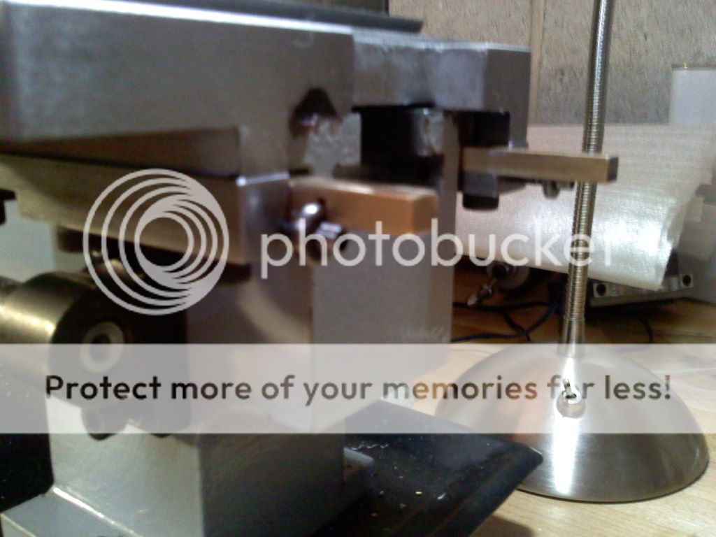

Here are the tapered gibs installed on my lathe...just a fit check. They look like they work. I have to find a 6-32 screw long enough for it now and mill the groove for the adjustment in the gib.

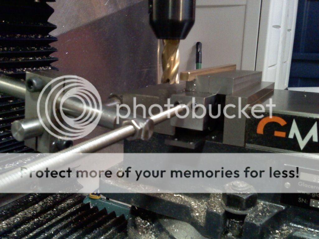

Here is my completed tapered gib mod to my 7x16 mini lathe. Wow what a difference !! I like it a lot !! I made my adjustment screw different than most. I don't have a 20 ton press :) !! So I used a 1 inch 6-32 cap screw...turned down O.D. .025" to give the bracket some clearance or it would hit. I then drilled and tapped a piece of .375" drill rod to 6-32.....then parted off 2 pieces to .078" and silver soldered to the cap screw. Works great !!
