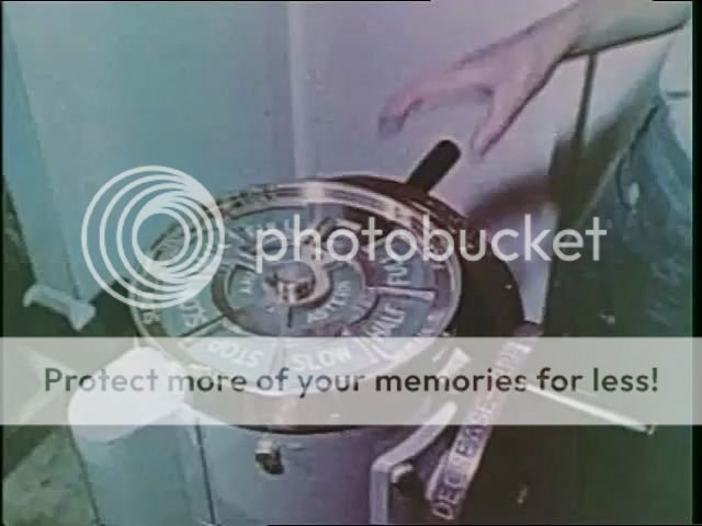

Offline Captain Jerry
  • Posts: 1076
  • Summerfield, FL USA
Re: Operation and Control of a Steam Ships Engine
« Reply #28 on: September 04, 2016, 03:22:02 AM »
Hi Jerry,
With Marine recip engines using browns reversing gear an emergency full ahead to full astern is done by first grabbing the reversing lever in one hand and pulling like mad, if the links don't want to swing over and your away astern then whilst still hanging onto the reversing lever use the other hand to spin the throttle shut. Once the links are over spin the throttle open. After this you can start to think about the little things like opening the drains as it is highly likely a stop is on the cards. All round gear takes its own sweet time to move the links so start the motor and close the throttle to help ease the load on the valves, particularly the big slide vales on the LP cylinder(s). Same again once the links are over, spin open the throttle.
As an aside, I have never heard of a gate valve as a throttle. They would be difficult to operate quickly and more importantly would be subject to large doses of wire drawing resulting in not being able to completely shut off steam to the engine. Most Maneouvering Valves, (throttles), are of a type known as a double beat balanced valve.
With steam turbines operation of the ahead and astern throttles is done simultaneously i.e. the ahead is spun shut at the same time as the astern is spun open.
With direct drive diesels and a fixed pitch propeller it is necessary to stop shaft before reversing else the bloody thing wont start in the right direction. Fairbanks Morse are a prime example of this. (Ask me how I know!!!)
Extract from 1962 PR film you may notice that the order is full ahead but the throttles are being operated for ahead to astern and the tacho on the left is currently showng the engine running ahead. Only a story and I suspect what in fact was happening is a backdown where the engines are used as a brake to reduce from approach speed, (say 25+ knots to tanker speed say 12 knots),  for a RAS, (USN UNREP) approach. Still you get the idea of both throttles being operated simultaneously.
HTH
Best Regards
Hi Bob,
Thanks for this.  It answers all of my questions and a few that I hadn't asked yet.  So the first action is to attempt to move the valves with the reversing lever but if that can't be completed, because of the load on the valves, ease the load by closing thee steam valve and then after the reversing lever goes over, open the steam valve.  This confirms my original thinking that the steam valve may need to be closed but not always.
Your term "spin" the valve closed, answers my question as to how fast can it be  closed and this says "as fast as you can."  It also answers a question that I had wondered about but never asked, "Why are the hand wheels on the steam valves so big."  I had always equated big hand wheels with fine control or with heavy torque, but your term "spin" and the later video changes that thinking completely.  They are big so that they can be spun like a flywheel so that one good yank might give you three or four revolutions.  I will look at big hand wheels with a different view from here on.
I incorrectly called Ericsson's throttle a "gate" valve when it is in fact when it is actually a "gridiron" valve, a more common type of throttle.  On Ericsson's Monitor, it is closed using a relatively small, horizontal hand wheel and a vertical shaft.  The small hand wheel has a handle like the handles on my mill so it may not spin like a big hand wheel.
Ericssons's Monitor does not have a reversing "lever."  It was reversed using a big hand wheel.  I have only seen this  operated in the video of Carlstadt's model and the wheel was turned very slowly to demonstrate the function of the crank arms and bevel gear segments that are used to roll the eccentrics over.  If the big wheel could be spun like a steam valve while the engine was turning, it changes the whole picture.  It could be easily reversed within two or three engine revolutions.
I have been looking at this valve gear all wrong.  My brain had been trying to equate it with some kind of Stephenson's gear. There are four eccentrics, two per cylinder but that is because it has an early cut of valve stacked on top of the normal slide valve.  The second eccentric has nothing to do with reversing.  To reverse the valve events, the entire stack of four eccentrics is rolled over 180 degrees.  This is a SLIP ECCENTRIC, a very simple reversing method but with a very sophisticated method of actuating it.
These are new conclusions that I have come to that I would never have reached without your revelations.  Thanks again, Bob.  You old hands probably new all about spinning big hand wheels but I didn't.

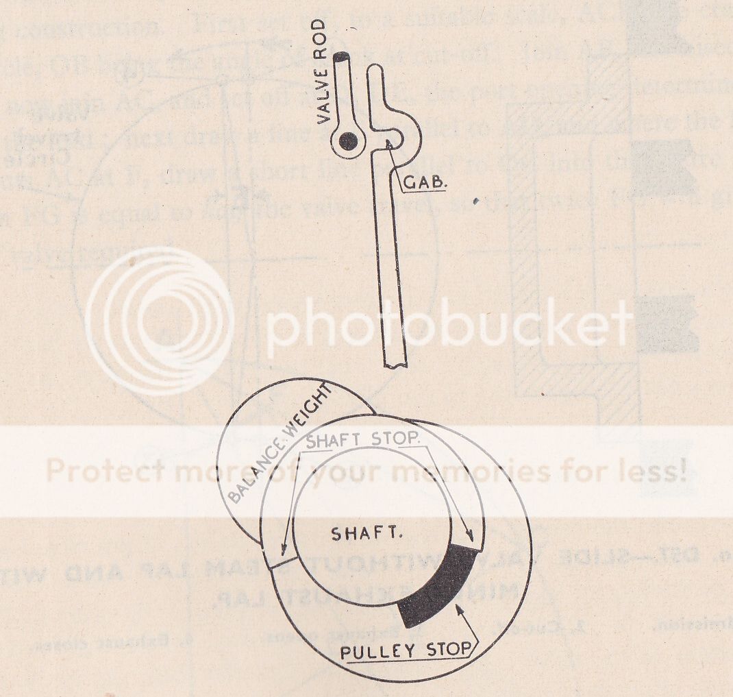

Offline Maryak
  • Posts: 1818
« Reply #29 on: September 04, 2016, 07:59:18 AM »
Hi Jerry,
Glad to be of some help.
I have notice several times in the thread and in your last post the mention of a slip eccentric and the slip roll over of 180deg. The little I know about a slip eccentric is that the roll over is somewhere around 107deg dependent on the amount of lap and lead. It is equal to the ahead and astern eccentric positions of the eccentrics in a normal Stevenson's link.
The handwheel for reversing equates to my term All Round reversing and was used when the electric motor driving the reversing gear worm failed. Was great for warming through as the links cycled from ahead to astern without the operator having to do anything other than ensure steam to the engine was only a trickle!!
Hope this helps
